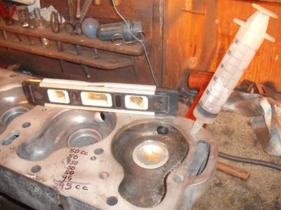

I decided to CC my head today. Even though I used a very primitive procedure, the doctors said Ill be OK (or at least as OK as I ever was) :)

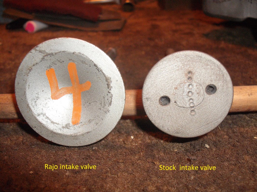

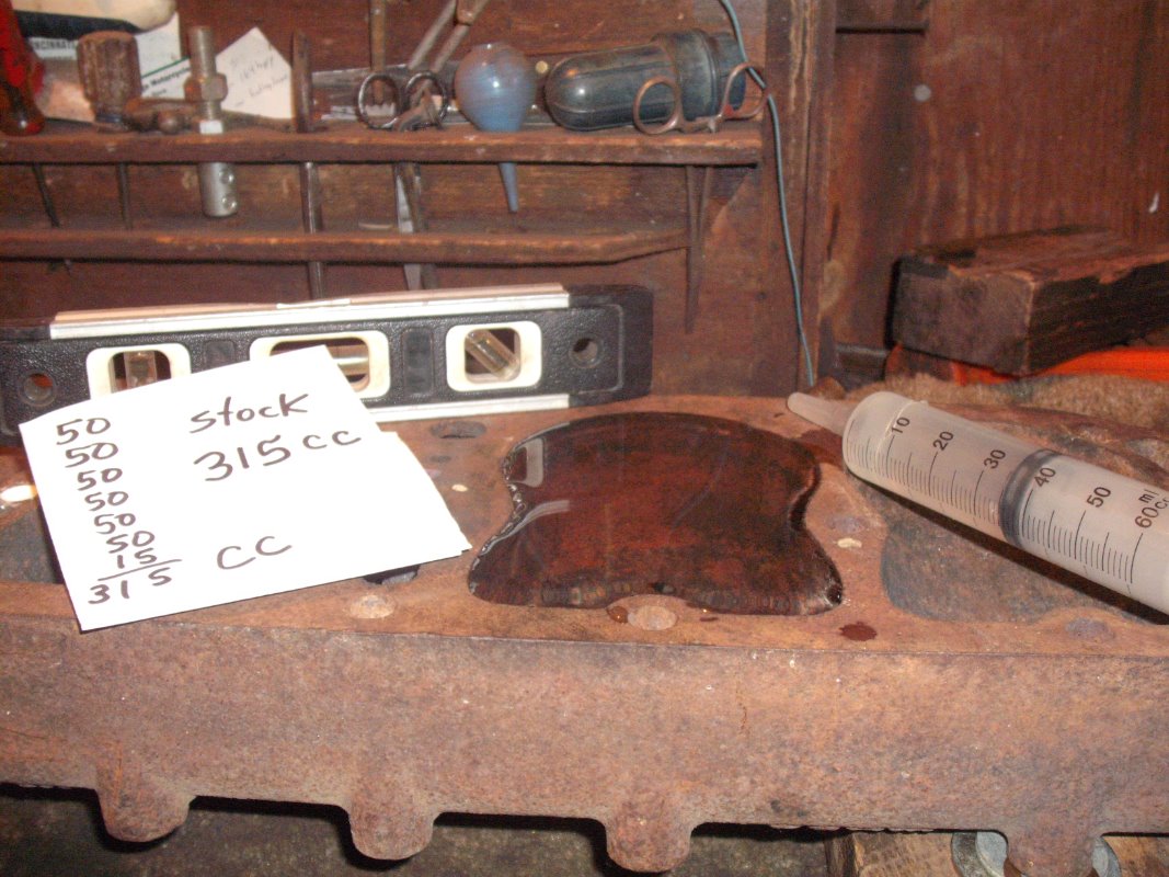

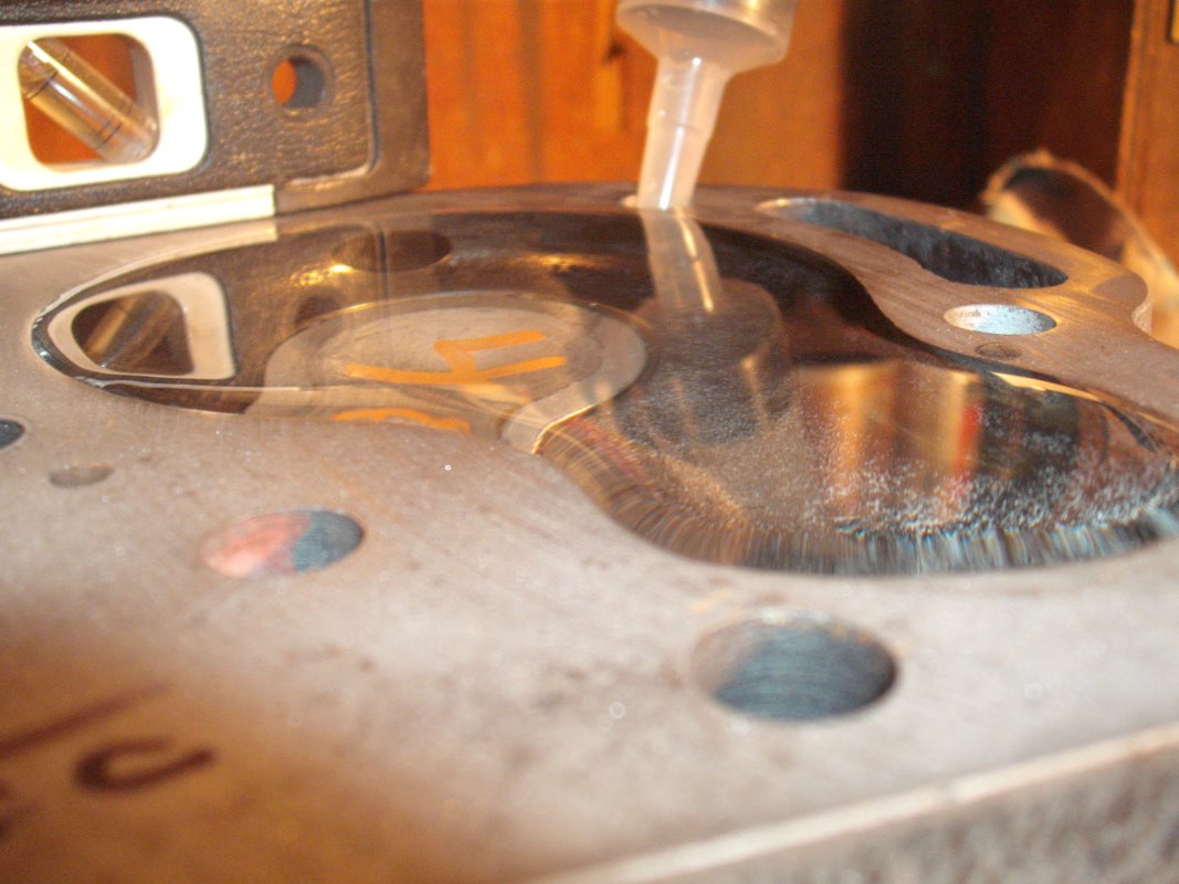

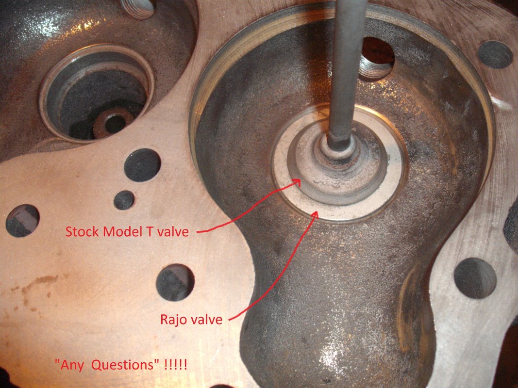

I have heard that the Rajo 4 valve heads are the same CC or compression ratio as a stock head. But to my eye it just looked to be larger. So to ease my mind I did an old school CC test. I leveled the head, put in the spark plug and filled it as full as I could get it with water from a large syringe marked in CC measurements. The Rajo measured to be 295 CCs and then the stock model T head measured to be 315 CCs. In reality I probably have an error factor of at least 20 CCs so I guess the Rajo and Stock head are the same. I also took some pics of the Rajo intake valve compared to a stock model T intake valve.... A huge difference !!! The old girl should be able to breathe very good ...

If you take a piece of 1/4" think acrylic big enough to cover the chamber and drill a 1/4" hole in it and glue the plate to the head with some grease you can a fill the chamber thru the hole and get a much more accurate measurement. You might be surprised at the difference in readings if you redo the measurement.

Dan, that is a very good idea. Ill have to remember to do that next time. For my purposes, my test is OK. But I could see where the clear cover would give a very accurate measurement. I know some racers want all the chambers to be exactly the same size. I was just interested in knowing that the Rajo was about the same as a stock head and not larger. Im just building this engine for "bling", its more "show" than "go". Staying close to stock compression is OK with me.
