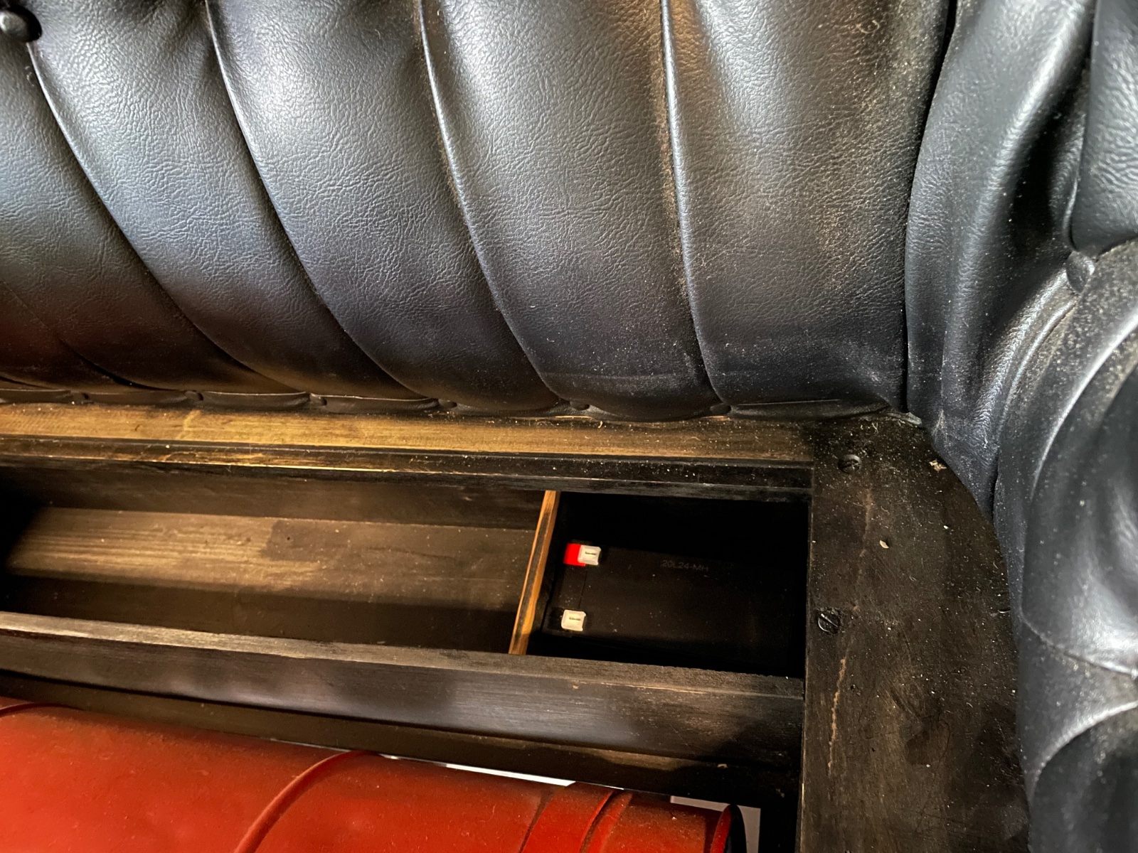

Post by ryanpad » Mon Mar 31, 2025 6:32 pm
Loftfield wrote:
Thu Mar 20, 2025 7:30 am
I installed a carrier in the frame from a later car. I don't like the look but one has to get under the car to see it. Perhaps another query is what sort of battery is used? My battery is for hand crank starting and to run LED brake and turn signals, so I used a 12v marine deep cycle battery (Wouldn't fit under the back seat). Lithium batteries will fit in small places but there are just too many incidents of these devices creating monster fires, don''t want to incinerate a 1912 Model T, or my garage.
Thomas, Im doing the same thing. I settled on a small sealed battery for a kids Power Wheels. Now to lay out the wiring in a convincing way to resemble an era upgrade (except the modern battery and leds)

My battery is in the same place as Vincent’s in my 14 runabout. I use a motorcycle battery, charge it when I think about it, lasts a couple years. It’s 12 volts so it can be pretty dead and still rattle the coils. I switch to mag right away so it’s never been a problem.

I have a small 12 volt car battery under the back seat it sits in a wood box open top and it runs lights turn signals brake light 2 horns and is used to start the car on battery. One small hole to run the wires under the car. my car is a 1912 touring
