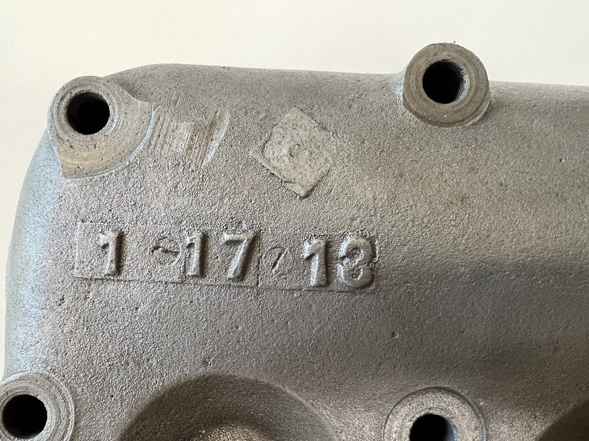

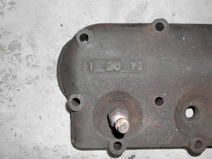

Look for square mold castings on top of the head. 1914-19 does not have them. Some 13 heads had a full date cast in them at the rear in line rear to front. Bob McDaniel’s head has that type of casting.

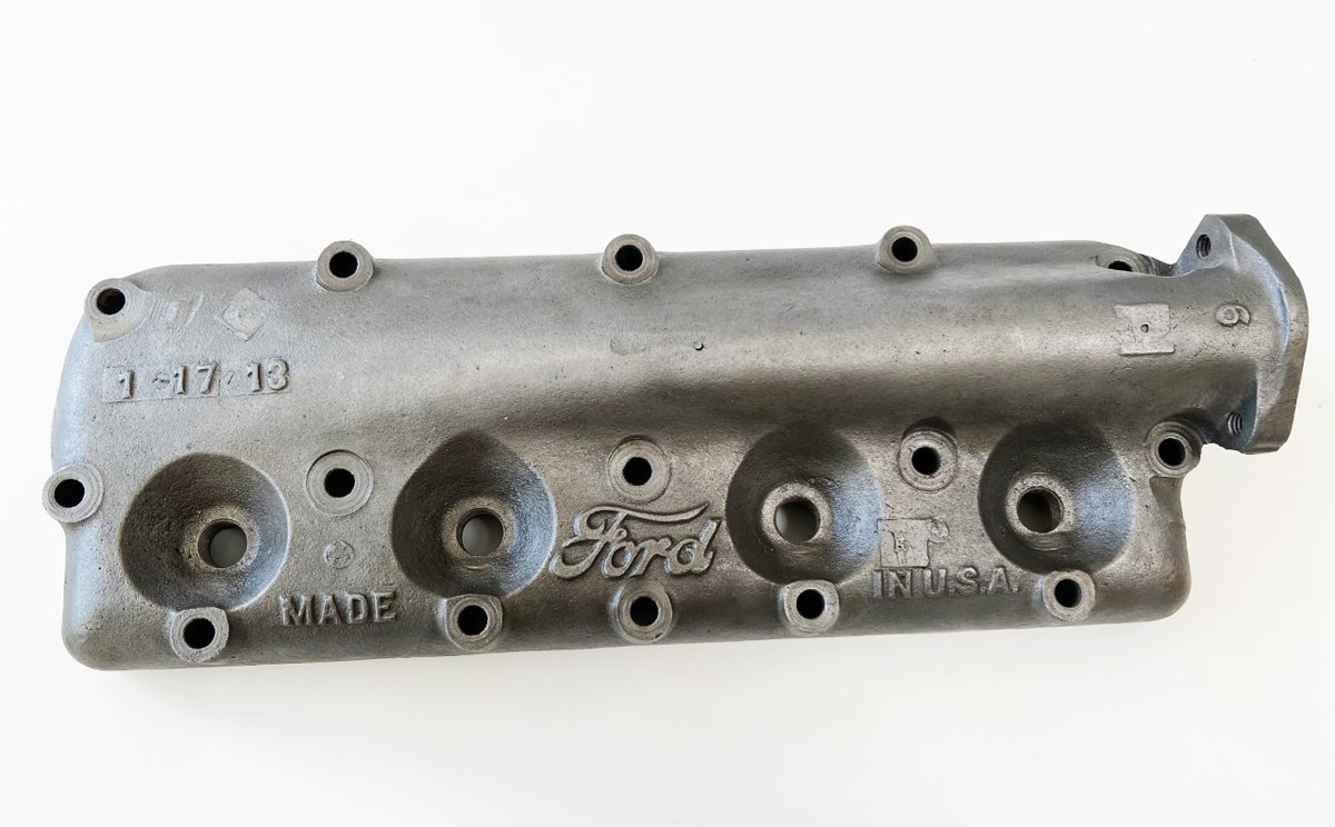

I also have one of the January 1913 heads with the full date. Ray Green posted a photo of a head with the date of 1-11-13 in Sept. 2011. The one that I've pictured is very close to Bob McDaniel's date of 1-20-13. Regarding Larry's comments on the faint "MADE IN USA" text under the Ford - my head doesn't have it. Is it probable that Larry's head predates these?
