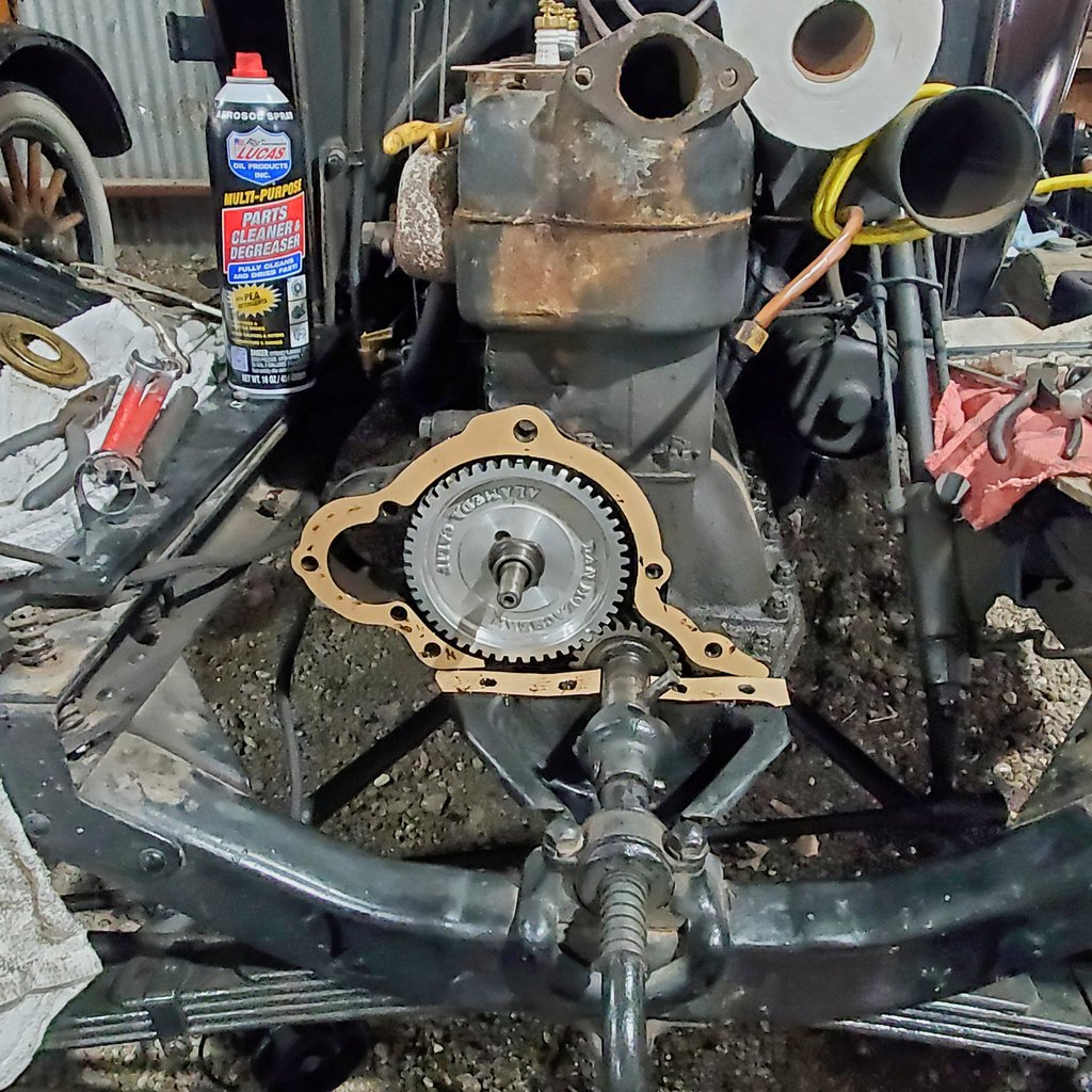

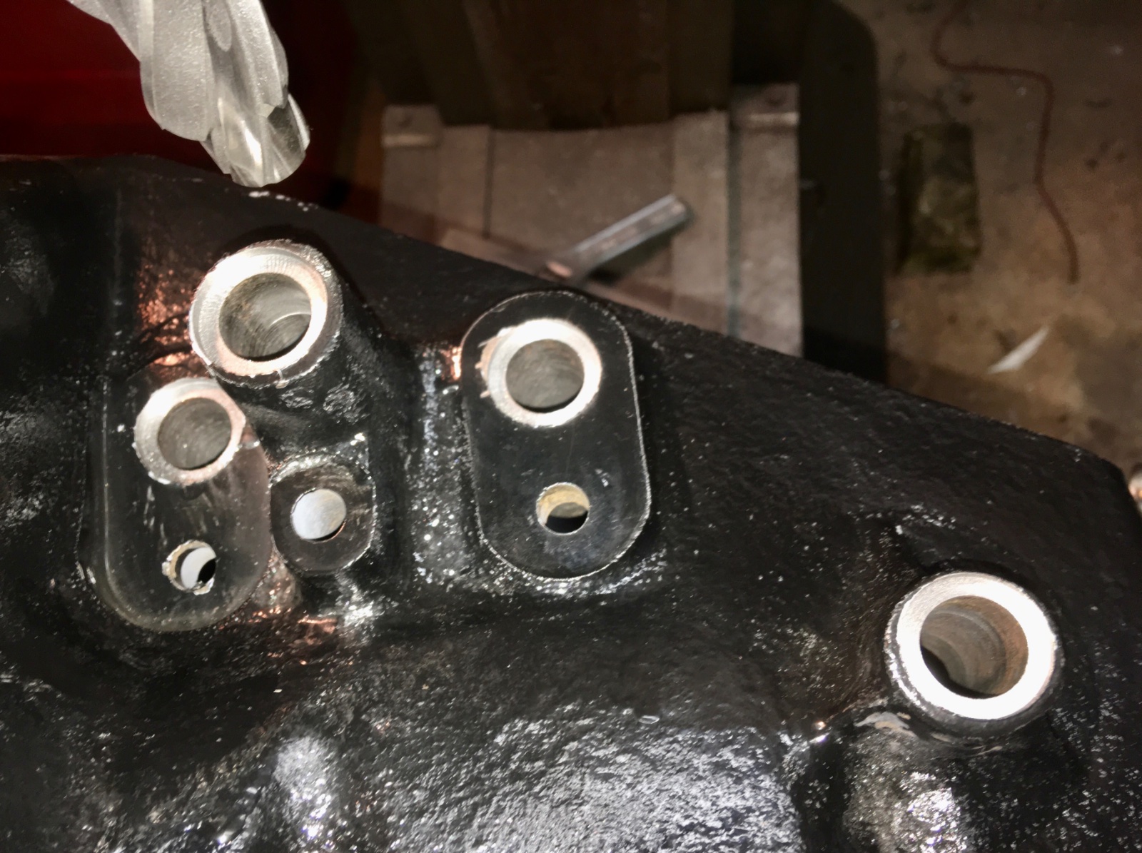

What have you done with your Model T in April
Hogs head fun! Got a counter bore and a Bridgeport. Added some oil seals to all 4 shafts.
now let’s get this thing assembled!

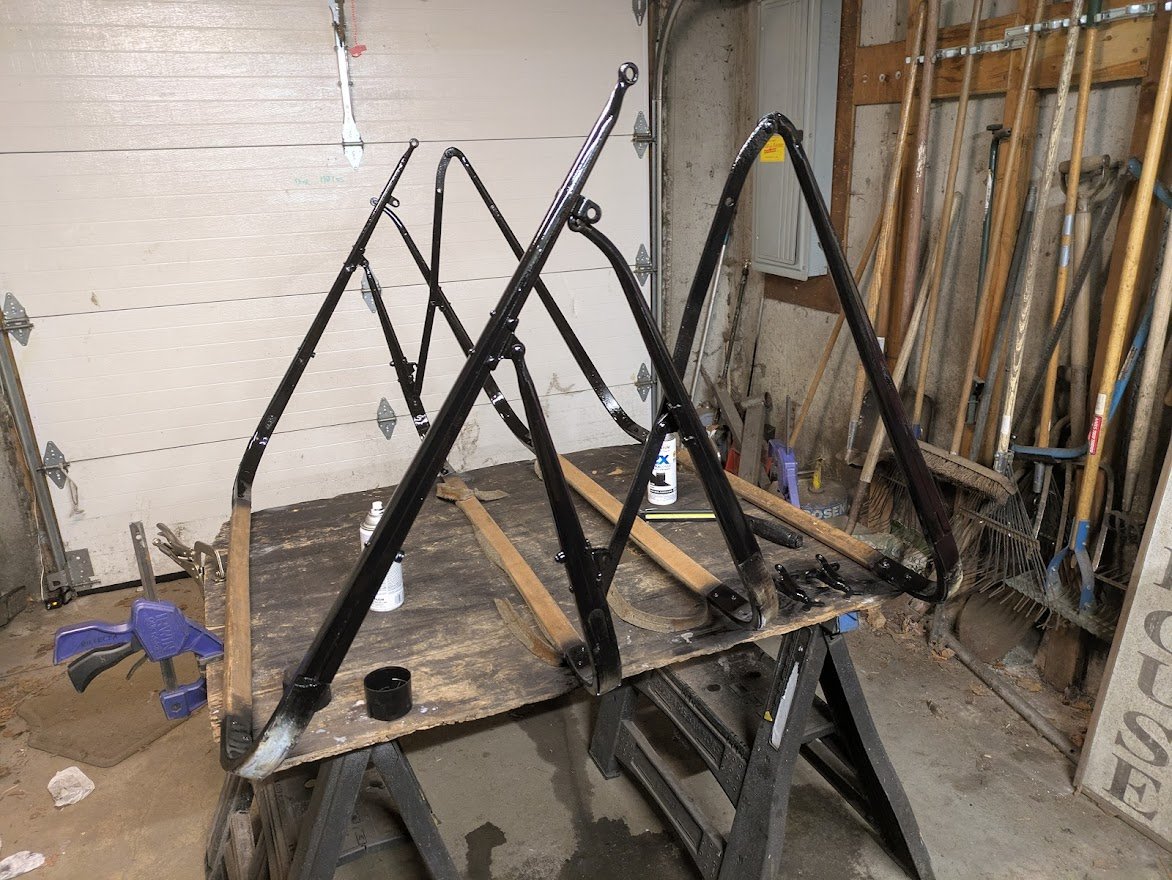

Re: What have you done with your Model T in April

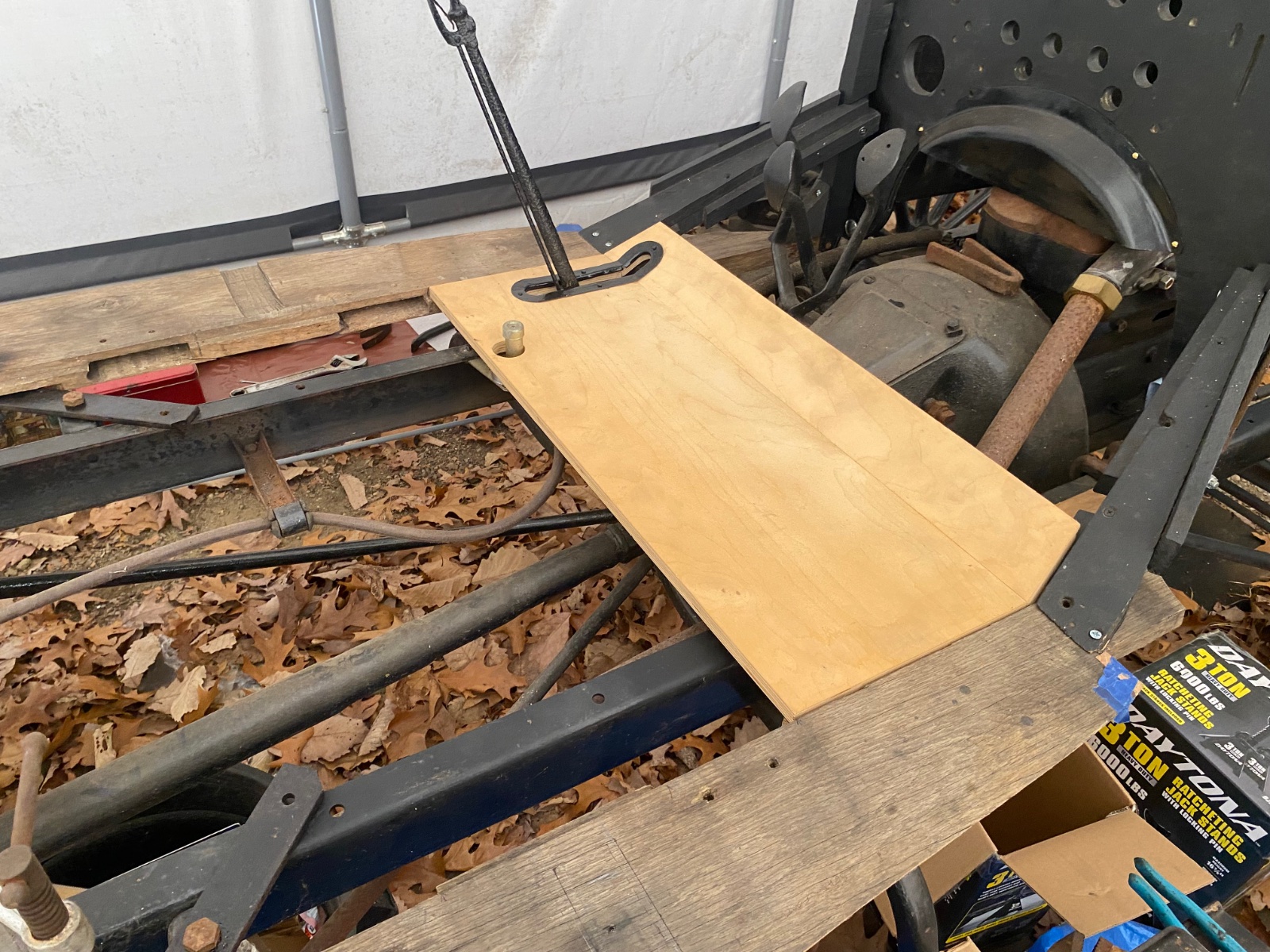

Finally got my top bows painted after many hours of restoring the wood and replacing rotted wood of the rear curve with a piece of azek PVC leftover scrap. The stuff is great for nailing and can be bent with heat. Next up: wrapping the bows, then on to the top.

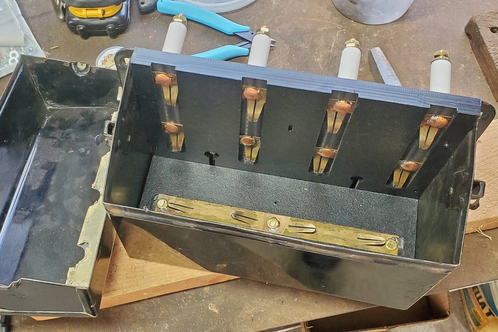

I have continued to enjoy the very smooth performance I get with my 'timer with points' which floats on a bearing on the camshaft.

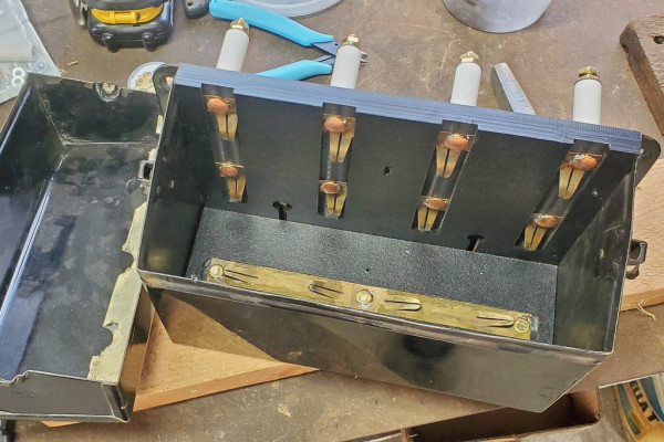

What I like best about your timer is the reinforced hole for the rod. Mine looks like Bakelite and is worn with slop in the timing adjustment.
Vern (Vieux Carre)

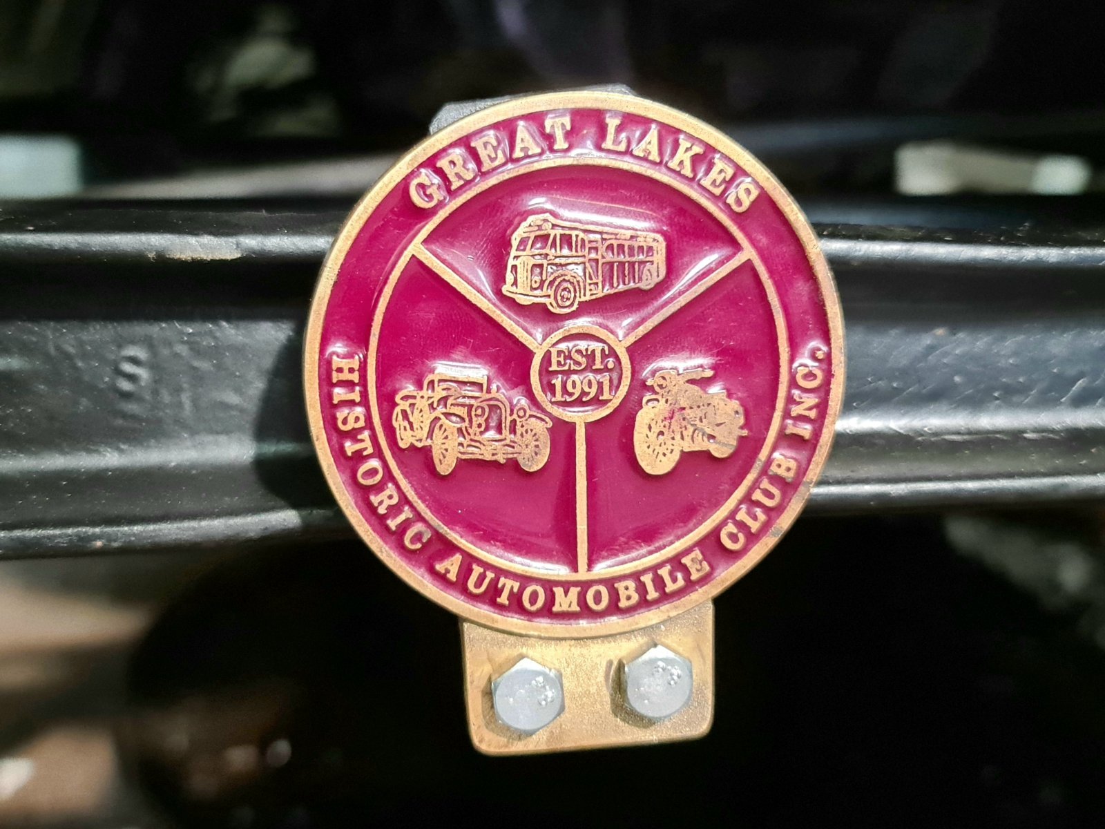

Added a new badge to the front axle. Funny story behind it, the Great Lakes HistoricAutomobile Club, of which i am Vice Presiden, is locatedin Australia. While browsing online to see what had been posted about the club, I came across this badge from around the time of the club's inauguration— and the item location? England! ... Neither me nor the seller could work out how it found its way to the UK

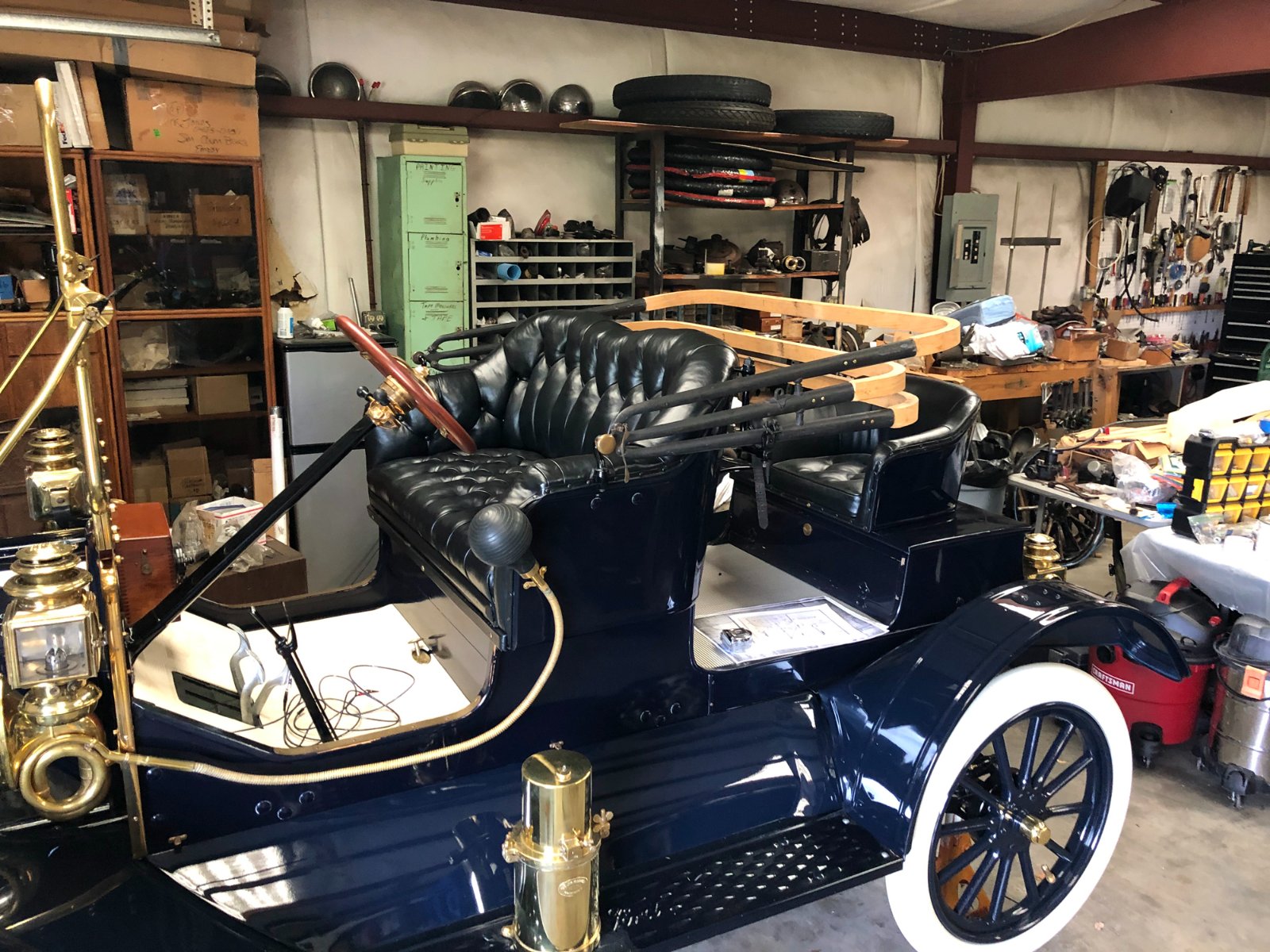

Fitting top bows on my 1912 Roadster.
I bought a set of bows from Snyders where the ends were already formed, meaning tapered and grooved. Took some sanding and fitting but it beat carving the ends from a chunk of lumber. So I cheated and saved myself the aggravation of wood carving, which I ain't too good at. I am a welder/metal worker hobbyist, not a wood guy.

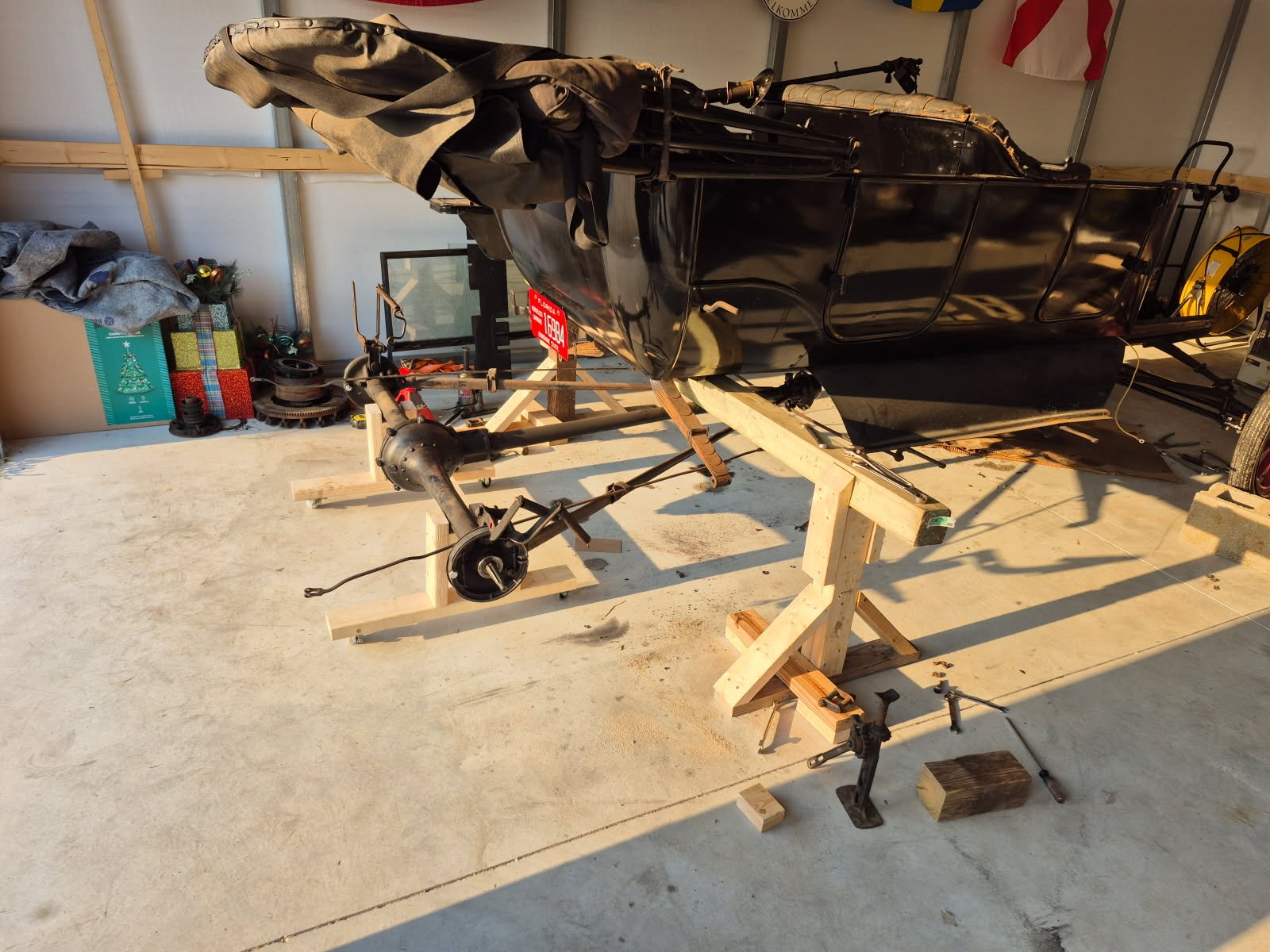

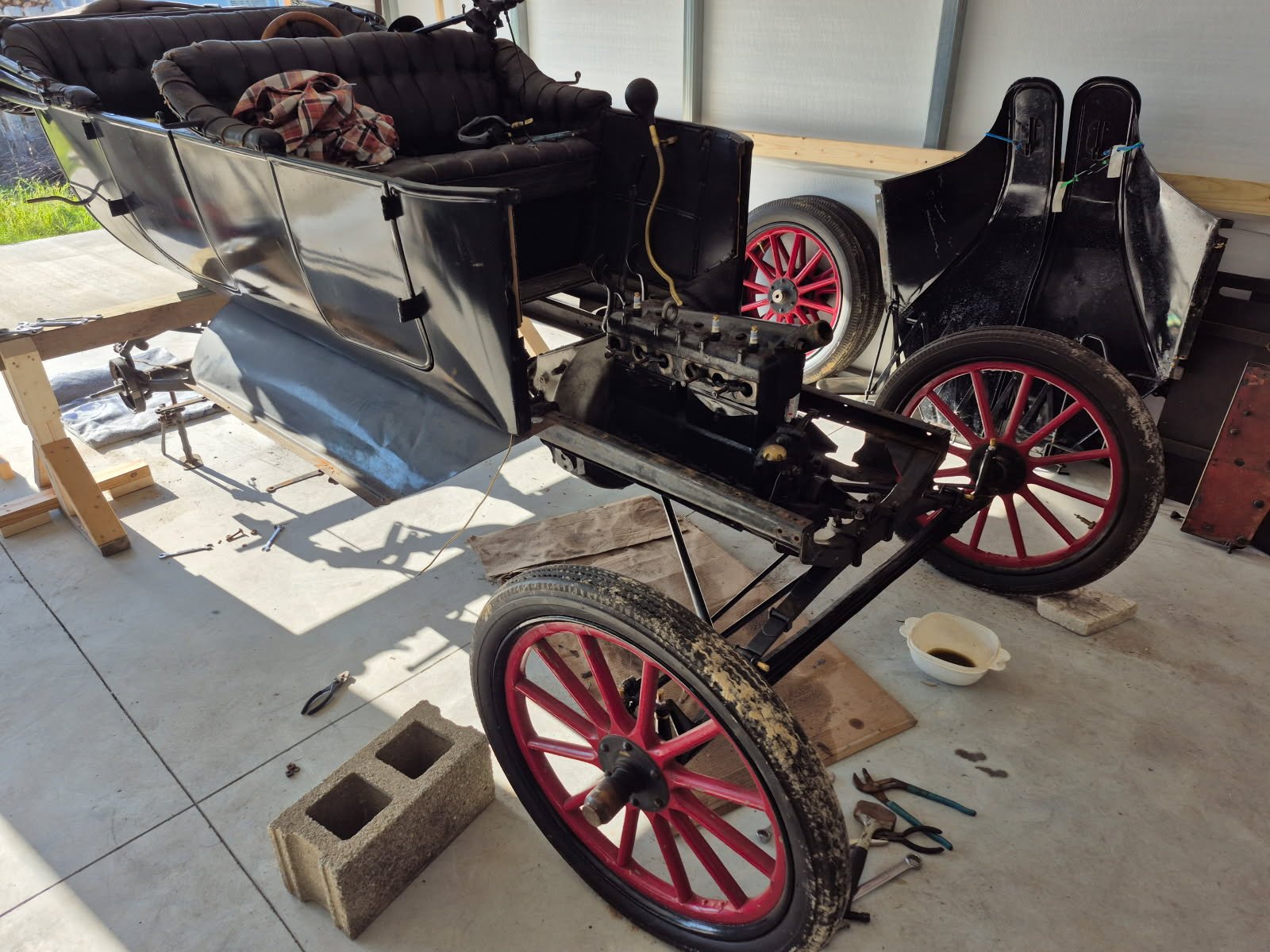

I hadnt really wanted to take Daisy all the way down, but given the rebuild of the rear as well as the tranny, the tear down began yesterday. As good as the top side paint is on the fenders/running boards, the undersides however are pocked with lots of small rust bubbles. Given coastal salt air, that just spells trouble. So, everything's coming off at this point to be stripped & repainted, and will also lift the body off so I can do the frame as well. Surprisingly the body is in excellent shape, and will probably leave it alone other than some minor touch up....will see.
Daisy Mae
- Posts: 548
- First Name: Kurt
- Last Name: Andersson
- Board Member Since: 2024
Pulled the axle today. I don't even need to disassemble the thing to know the driveshaft thrust bearing is shot, simply looking at how chewed up the face of the 4th bearing is!!

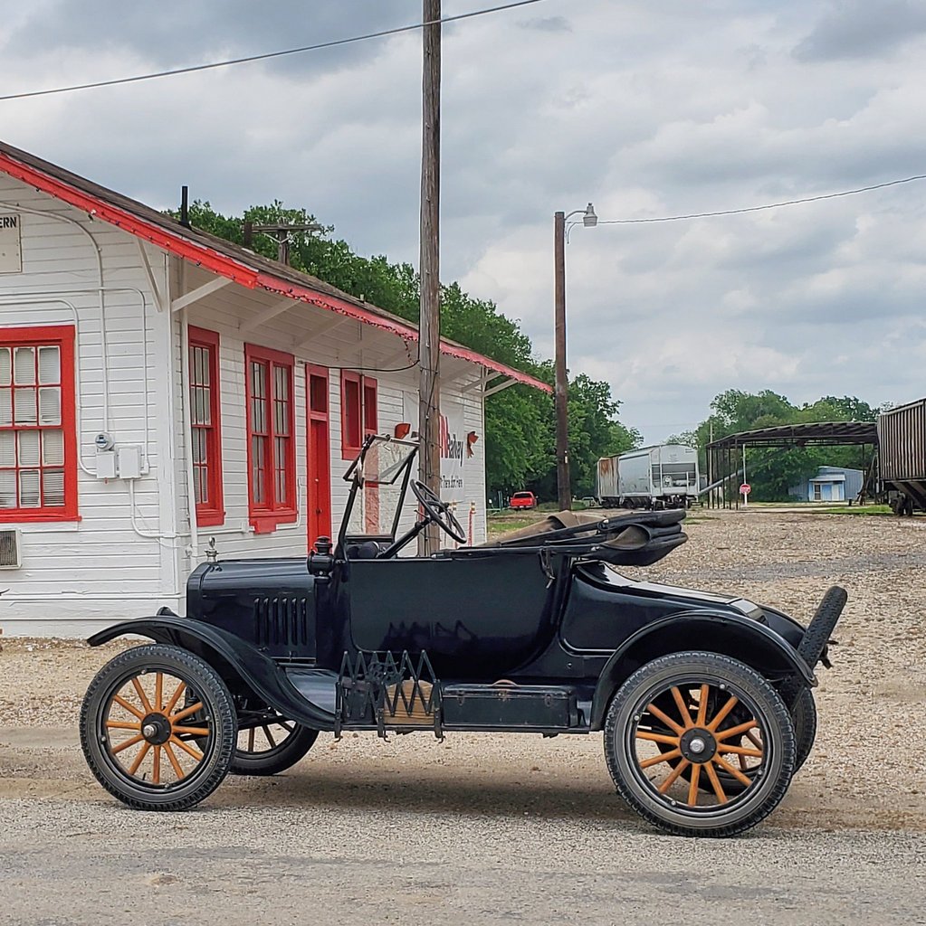

Finally got the 22 Runabout carburetor back on and got it started up. Plan to drive to the Local Museum for a couple hours this afternoon if the weather co-operates. Several months ago I replaced a valve I had installed under the hood so I don't have to crawl under to shut off the gas. That valve was leaking and I bought another one. It was about 1/16" shorter than the former one and I couldn't get the line to pull up to the carburetor. after several attempts, I decided to take off the carburetor and attach the line then pull the carburetor up to the manifold with the bolts. That worked. Then I had to find several very slim cotter pins so I could attach all the adjusting rods including the throttle rod. I got all the leaks sealed up with fuel repellent type sealer and Yesterday started it up. Now just pump the tires and drive to the gas station. It only has about 3 gallons in the tank and will not pull the hill back to my home unless the tank is over half full. Big job when 89 years of age. Would have been much easier when younger. When I get on the creeper, I have to turn over on my aching knees to get up from the floor! Wish I were about 80 again!
- Posts: 4694
Well! Drove it to town and went to the Sinclair Station and filled up with Dinosaur gas for my Dinosaur car. Then on to the museum. Was there a little over 2 hours and it started to sprinkle. When it was time to drive home, it was raining pretty hard. Got quite cold and wet, but made it home and in the garage to dry out. Also changed my wet clothes. I am more creaky now than before because of getting down on my knees or back under the car to work on it. These things would have been very easy for me a few years ago. Anyway, I am now home and dry. Just tired and achy. Will be having dinner in about an hour. The car and me are drying out now

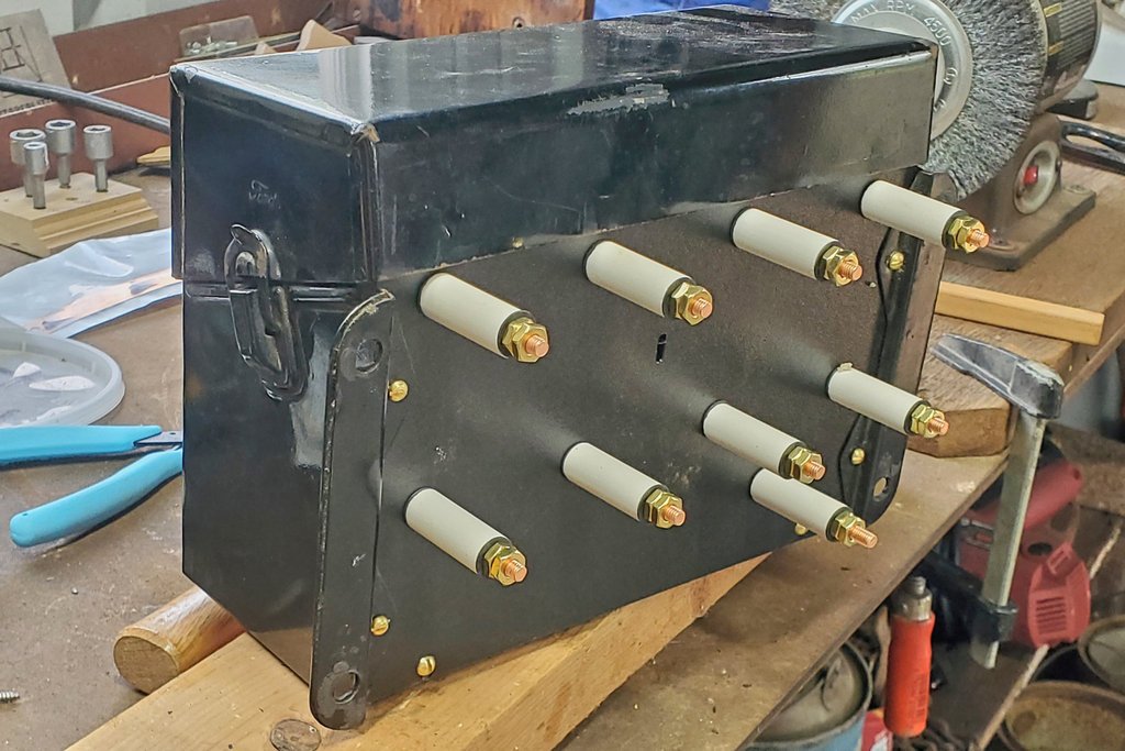

My '23 Runabout evidently craved fiber in his diet and tried to eat his timing gear. Replaced it with an aluminum one to discourage gnawing on himself.
Overhauled coil box with plastic parts kit primarily to cure chronic ill-fitting coil box lid problem. It worked perfectly - hooray!
Last picture taken yesterday in Gonzales, Texas while on a 72 mile Sunday lunch run.
