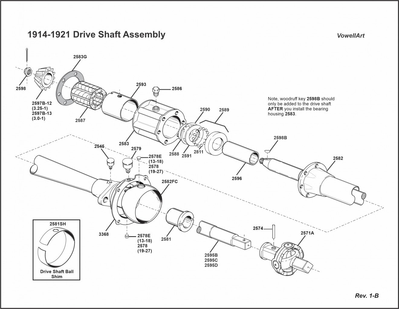

In the midst of rebuilding my rear axle. Car is a 26 Tudor, however drive line is ??? Numbers on engine I believe it to be Oct. 1919. Pedals and hogshead are early 20s. Rear axle is small drum early 20s. The dilemma I have is the universal joint is stuck on the driveshaft. I'm replacing everything except the torque tube/ball assembly. I have removed the two bolts and drove the universal pin out, yet I am not able to free the U-joint. Am I missing something here?? I do have the MTFCA Front and Rear Axle Book, and have gone through it a couple times. Open to any and all suggestions.

What two bolts are you referring to? (oil & grease caps?)
When driving the pin out you may have created a small bur in the pin's hole onto the shaft that is preventing it from sliding off. But you just may need a bit more force tapping it off.

Those "bolts" would be the u-joint pin plugs.

If you put the assembly in a vice, you may find it easier to pry at the pinion gear end. There will be a little play between the gear and the bearing housing as the thrust bearing allows the shaft to travel. That should open up the gap between the pinion bearing spool and the torque tube to give you another point to lever. That should be enough to overcome any burr created when driving out the universal pin.

Post by Allan » Fri Apr 04, 2025 3:08 am
The half inch pipe cap trick works for me.I machined down the ID to go int the bush and left a shoulder to drive on the end. No clearance problems on the rivets.

Post by Shrshot » Fri Apr 04, 2025 9:54 am
Thanks for the suggestions. One of these methods should do the trick, I'll give it a go later today.

Post by Shrshot » Sat Apr 05, 2025 11:02 am
Update..... The bushing puller I got from Snyder's works flawlessly. Babbitt bushing out in minutes.
