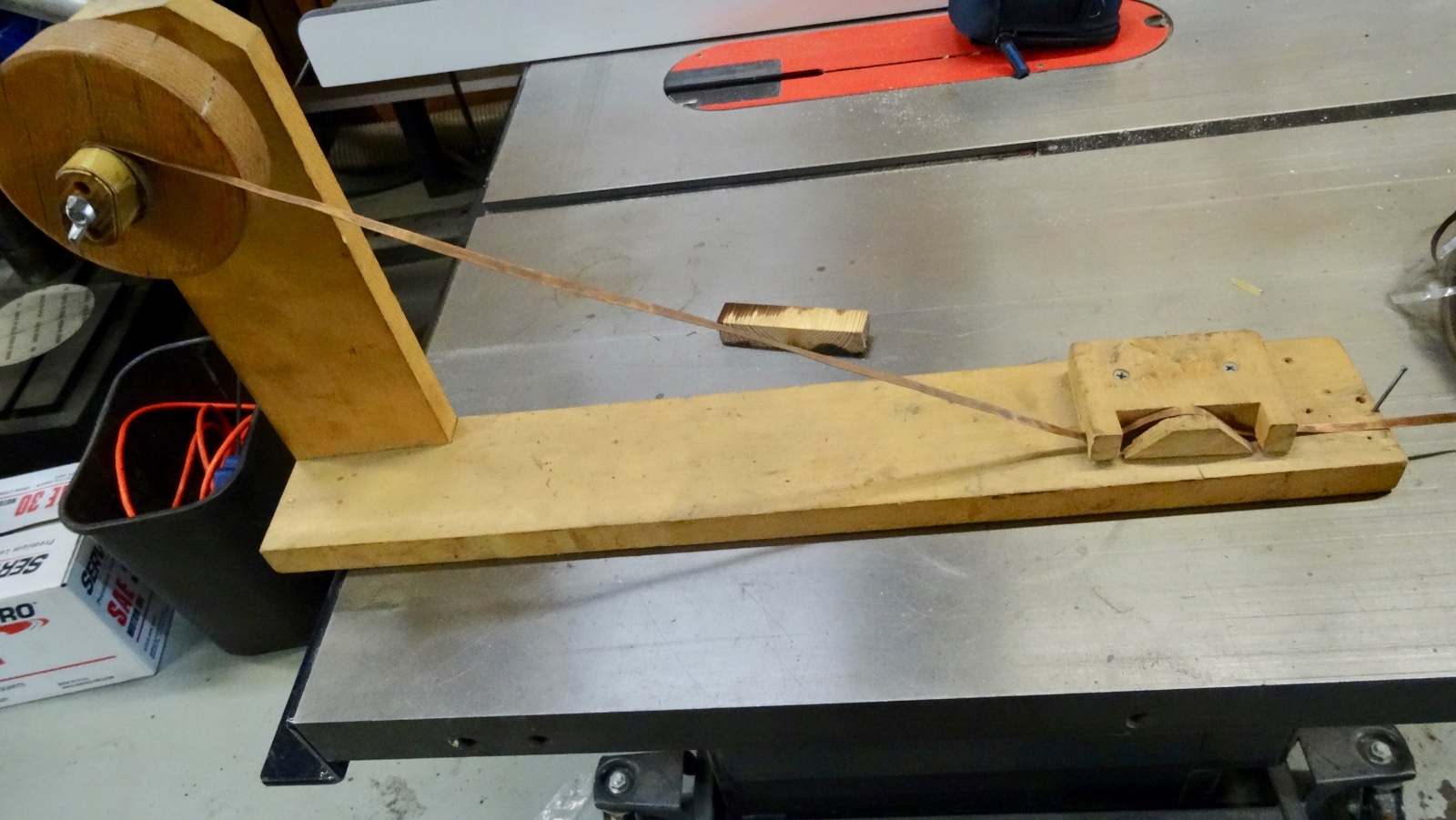

If anyone knows how to contact Wally S I'm sure he would know. If you have a lot of time you can do it yourself. I did.
