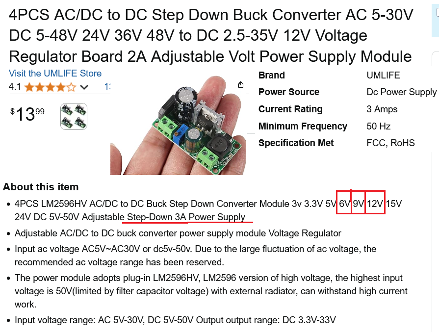

Was wondering if this would work. Magneto to Buck Converter then one to power each bulb circuit depending an amp draw if necessary
Supposedly a buck converter will provide constant out voltage
Topic author - Posts: 7411
Re: LED for MAG lights?
A simple answer is best for my poor little brain. "No" answers my question adequately.

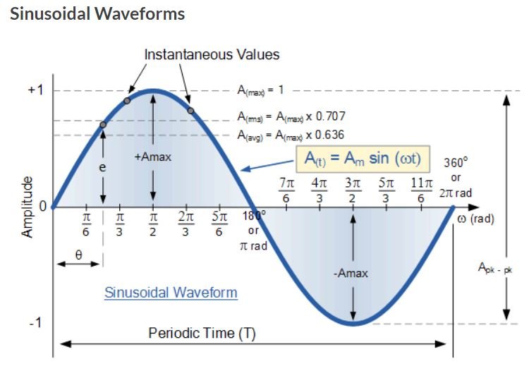

To clear up some details here, and probably cause confusion.
LED bulbs will run on AC power but...
They are diodes at heart so will only light on half the cycle. Not that anyone notices this.
DC is measured at steady voltage, also known as peak voltage.
AC is measured as RMS (equal power to DC) voltage. Example; at 60 Hertz 120volts AC is 170volts peak.
The reason this matters is it is easily possible to exceed the maximum voltage limit forward or reverse voltage rating. These limits are buried in the spec sheets and often overlooked. It is always best to ask if not confident that it is the correct application. Or just take your chances on turning them into flash bulbs.
I love LED's for the old cars and have them in mine. The lower power with brighter light is a win win in my book. I dont have any magneto light ones, that is a gap in the fleet.
In summary: LED's work fine on AC if within the rated limits. If unsure ask the seller or manufacturer.
If someone tests them I am curious how they work. I might need them someday in the future.

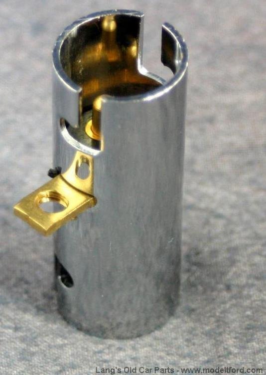

The socket (Part #6574X) will have to be changed to install this. I do not know of a BA15S socket with screw tab to install in the headlight bucket. Not sure how to solve this without creating custom parts. I have installed single pin bulbs in dual pin sockets with mixed results. No matter what the stock wiring MUST be reworked to avoid shorting the magneto and burning out the wiring.

Ok, here is some voltage theory.
A.C. = Alternating Current it is a voltage source that rises and falls in a cyclical pattern called a sine wave.
It can be thought of like a crankshaft rotating and the piston going up and down, plotted over time the piston position is a sine wave pattern. if you use the center of the crankshaft as zero you can see that you have both positive and negative pulses. See the enclosed picture. Rarely is AC all positive or all negative so we will not discuss this special situation.
In a crude way AC is just reversing DC really fast.
Some LED bulbs don't care about polarity because they are built to light either way with back to back parts.
Ir they don't care about polarity they will light at the positive and negative pulses.
If the bulb cares about polarity will only light on half the cycles and just put out less light
On polarity sensitive LED bulbs on AC make sure the voltage maximum in reverse is good enough in addition to forward voltage.
The 1157 bulb is mention but it can not be used because the 1157 pins are offset and the Model T uses parallel pins.
The magneto bulb power comes in one contact and out the other not using the shell in the circuit. This is how the bulbs are wired in series.
The battery bulbs use the same base but in one pin for low and the other for high with both using the shell as a common ground. These bulbs are wired in parallel.
See the enclosed picture as to the differences between the bases and how they are hooked up.
So many details have to be correct when choosing the correct bulb for your application.
