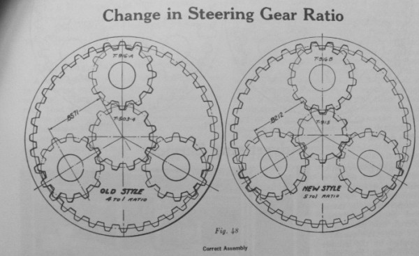

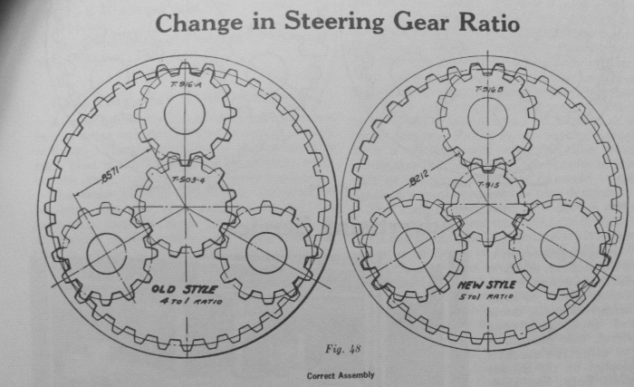

Correct. He needs to swap the 4:1 steering shaft for a 5:1 shaft and use 5:1 gears. Pin spacing on the two steering shafts are different. That may be why slots were made wider to accommodate different pin spacing. After I assembled my converted gear case I had to trim two spots in the slot with a dremel tool to clear the pin.John Codman wrote: ↑Wed Jun 26, 2019 11:52 amAssuming that the 5:1 set is on an "improved car," what will happen is that with the 4:1 gears, the thing will steer hard as Hades. Remember that it has the low-pressure big tires. I'd think long and hard about doing that swap. Ford changed to 5:1 gears for a reason.
- Posts: 4042
Re: Using a 4-1 sterring gear box in place of 5-1
That is likely the engineering change, the wider pinion posts on the 5:1 ratio steering post shaft.

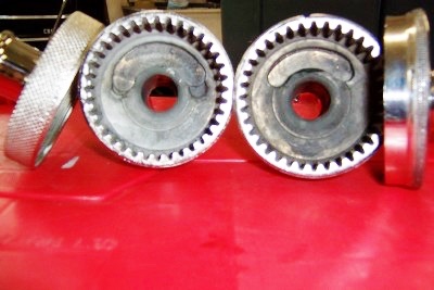

Here are the two cases, on right is the 4:1, on the left 5:1 for the balloon tires, note the longer groove.
