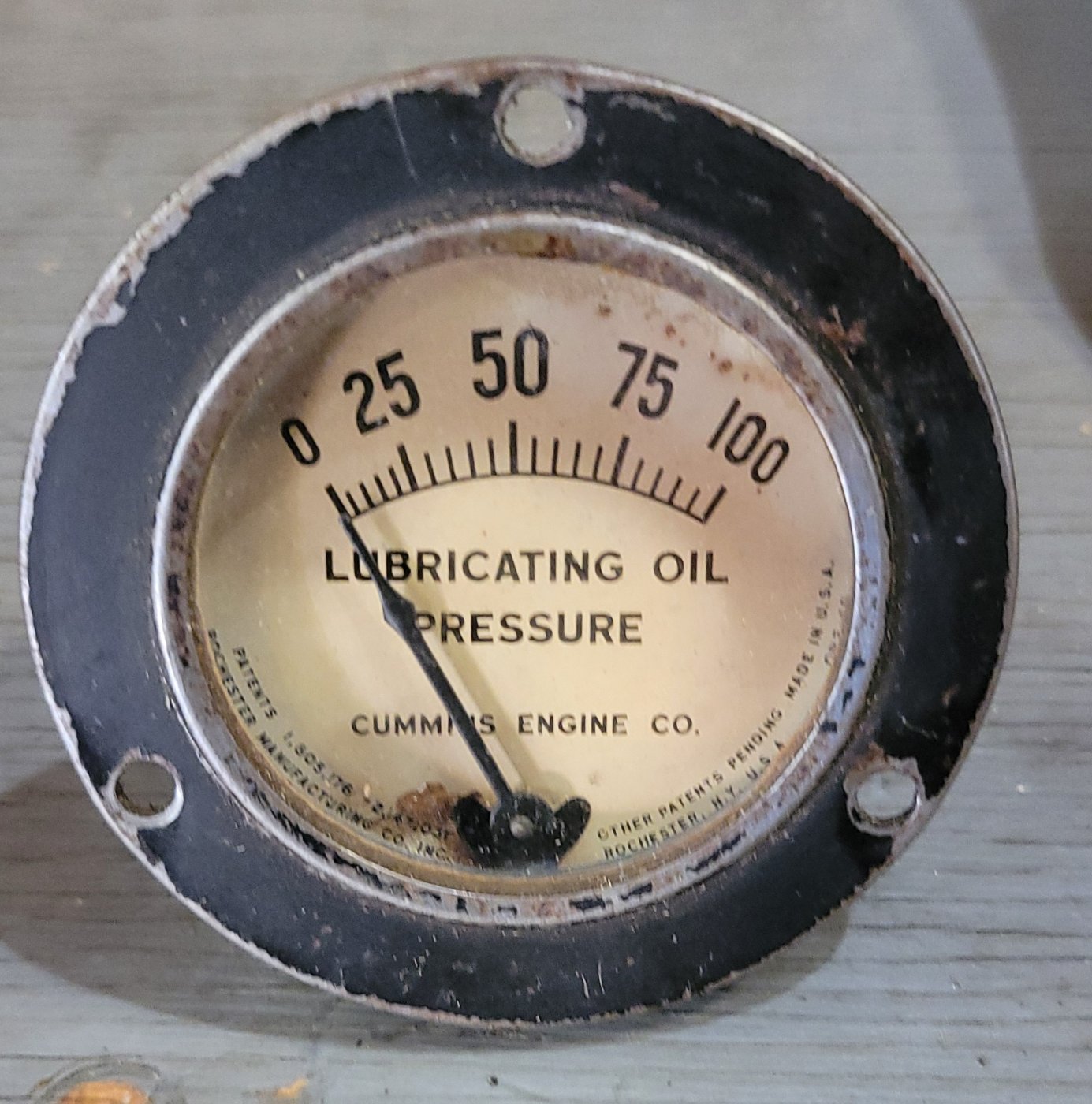

Shall I use this old timey gauge?
Kevin Pharis
Posts: 1640
First Name: Kevin
Last Name: Pharis
Location: Sacramento CA
Re: Oil pump pressure
Post by Kevin Pharis » Tue Apr 15, 2025 10:21 pm
Looks good to me! Just keep in mind that the gage port on the oil pump is 1/8”-28bsp (British Standard Pipe), not 1/8”-27npt

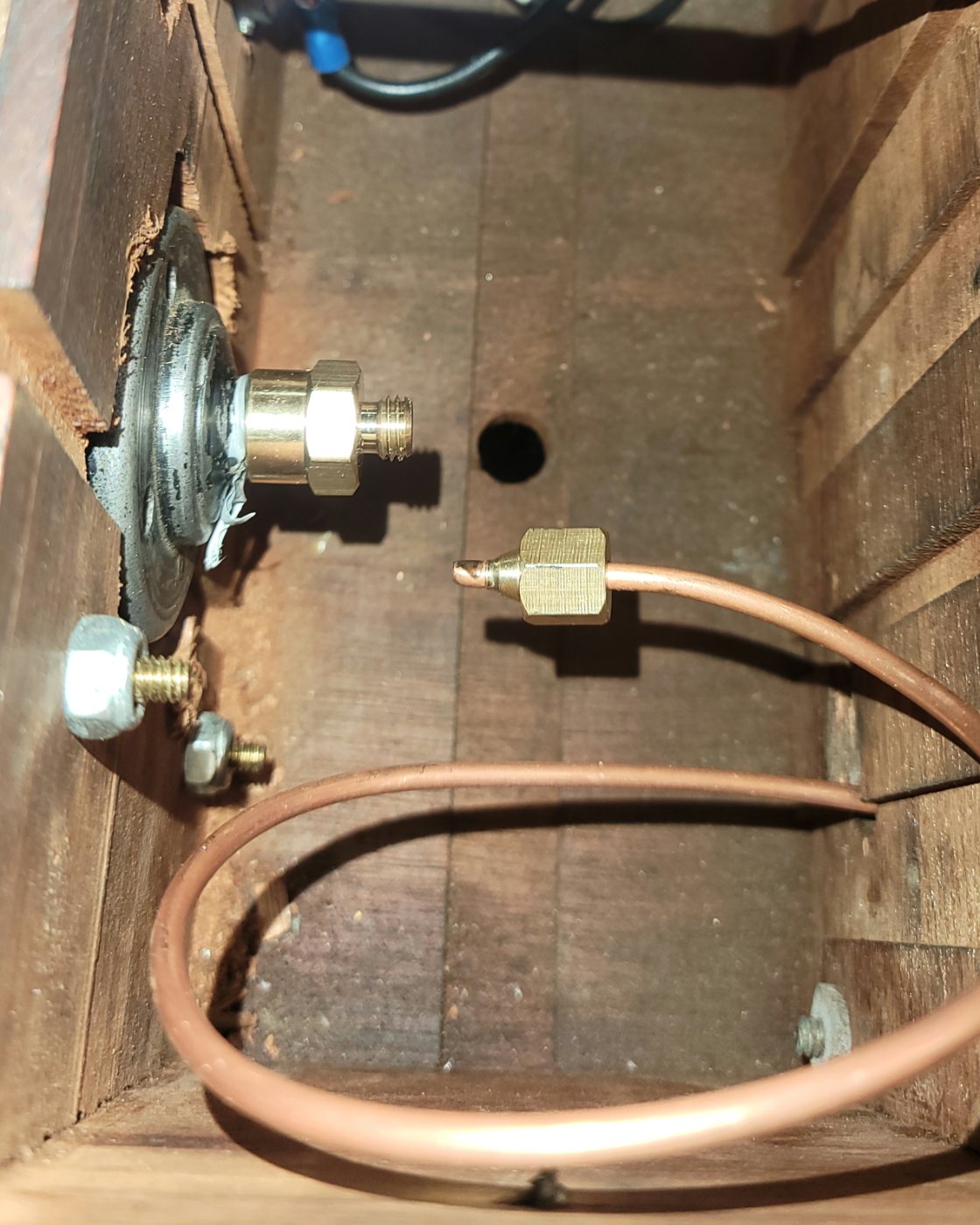

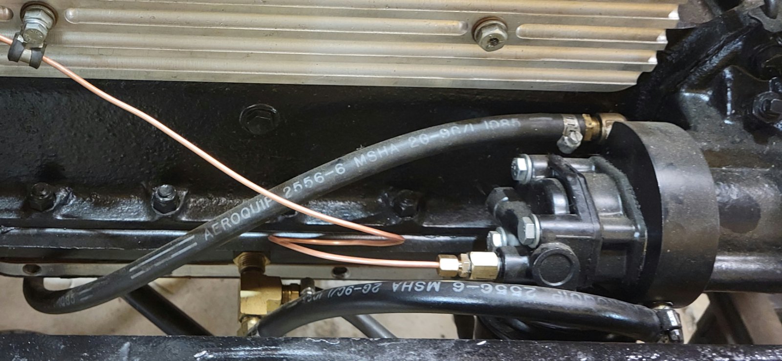

Update pics...

I put in 5 quarts of oil. Is there any procedure for priming a B-210 oil pump?
Should I crank it over by hand and bleed the line until i get some oil to the gauge?
Kevin Pharis
Posts: 1640
First Name: Kevin
Last Name: Pharis
Post by Kevin Pharis » Mon May 19, 2025 1:12 am
I suggest pulling the coil wire and cranking it for a short bit with the gauge port open. Be sure to pre-fill your oil filter to ensure quick response. If no oil, possibly use a hand held vacuum pump do draw oil in from the gauge port
Posts: 5599
First Name: Henry
Last Name: Lee
Location: South Pittsburg, TN
Post by Henry K. Lee » Mon May 19, 2025 9:25 am
I recommend filling oil filter completely, disconnect oil lines , outputs on pump, and fill with an oil can and turn engine by starter. Works everytime.
