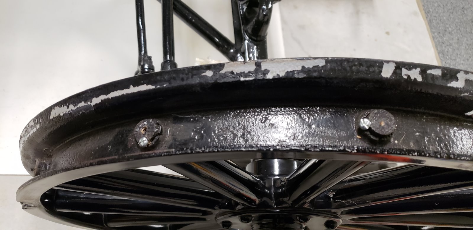

Today, I thought I would try to tighten a couple of loose spokes with screws. They seem to have helped a lot, has anyone else tried this method with success or? Like to hear from others. [/size][/b]

it is in fact a terrible idea that sounds great, and because it sounds great, has been done many many times. If my barn is leaning more and more everyday, is near collapse, and I put up an angle brace on the outside wall, I stopped the leaning movement for now, but did I restore it's structural integrity? Would you let your child play in it's shadow?
If you felt the need to do this, you need new spokes...sorry about that.
- Posts: 4386
Re: Spoke Tightening Method
There are ways to shim a solid but otherwise loose spoke in a wheel, that can be done well and last for a whole lot of miles. But this isn't one of them. A screw, or nail temporarily removes unwanted movement by filling a tiny amount of a large gap. It WILL work the screw or nail into the spoke tenon and get loose again soon, then continue to grind away at a small area making the tenon smaller, weaker, and badly distorted. Any such shims need to be full coverage around the tenon, and shaped so that they CANNOT loosen and fall out. In addition inner hub looseness must also be similarly shimmed so that tightening is spread throughout and cannot be shaken out.
Better yet. Unless you are totally broke like me? Buy new spokes and do the wheel right.

Scott's right. If a spoke is loose at the felloe, surely it's loose at the hub as well. More, driving a screw through a spoke is an invitation to split it. Properly rebuilt wheels are the best (and most important) investment you can make in the safety and "good running" of your model T.

No !! The beginnings of a cracked spoke !

From the photos, it looks like you have Hayes felloes. If you decide to rebuild your wheels with new spokes, be sure to get the 1/32 inch longer spokes that are made for Hayes and Kelsey wheels. Also be sure to get the right size tenons (they come in 1/2 inch and 5/8 inch sizes).

Absolutely want to thank all for responding. I had always understood that the wheel needed to be re-wooded, but thought this might hold for a bit, after all, I have been driving on this loose spoked wheel for years now. New wood wheels will be on the car soon. In fact already have them, just need to sand and have painted.

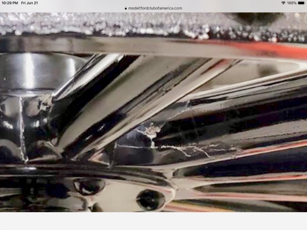

Loose spokes will make clacking sound as you drive giving warning of bad thing to happen.
Close up of that glossy paint shows cracks, indicating poor wood, likely dry rot. As the book title said....’un-safe at any speed’!
