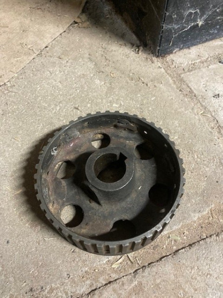

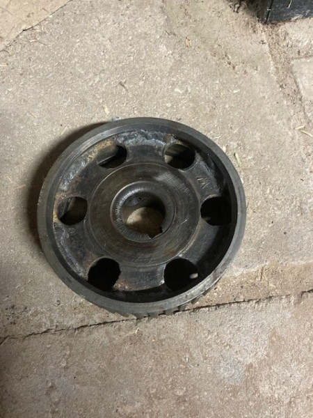

Posts: 4045
Re: The Turbo400 Inner Clutch Disk
Post by DanTreace » Fri Apr 11, 2025 6:30 am
The Jack Rabbit style sold by Synders is IMO the way to go, works in my T’s.
The Turbo drum with the special multi grooves for the turbo discs isn’t made.
Plus in one install the special drum fractured trying to pull it off.
That drum is Cast Steel or some alloy,unlike forged Ford drum. It stuck on the shaft and puller broke away the removal hole on one side. Very little wall thickness at the removal holes, poor design. Had to drill and cut the cast thing off. :x (Posted that on Oct 30 2022)
Jack Rabbit style uses the factory forged drum.
J1MGOLDEN
Posts: 1314
Last Name: Golden
Location: Bowie, MD
Post by J1MGOLDEN » Fri Apr 11, 2025 9:57 am
Dan, thanks for the photos.
Now, I only have to find one that is for sale!
There are plenty of the related disk packs anyway.

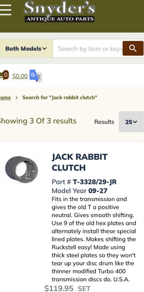

I see from the pic that the material used on the Jackrabbit clutch has changed to the same as the Turbo 400? That may make some more
comfortable with them. I have years on the cut down Turbo 400s with no issue I even put them back in after breaking a low drum.

The Jackrabbit Clutch disk pack was the secret, as it comes with 8 thicker Turbo400 disks and only uses 9 original disks with it, or perhaps 10 and they are available.
The main advantage is it improves the ability to shift from Lo to Hi or Hi to Low.
Snyders had a set and the transmission is back together now.
