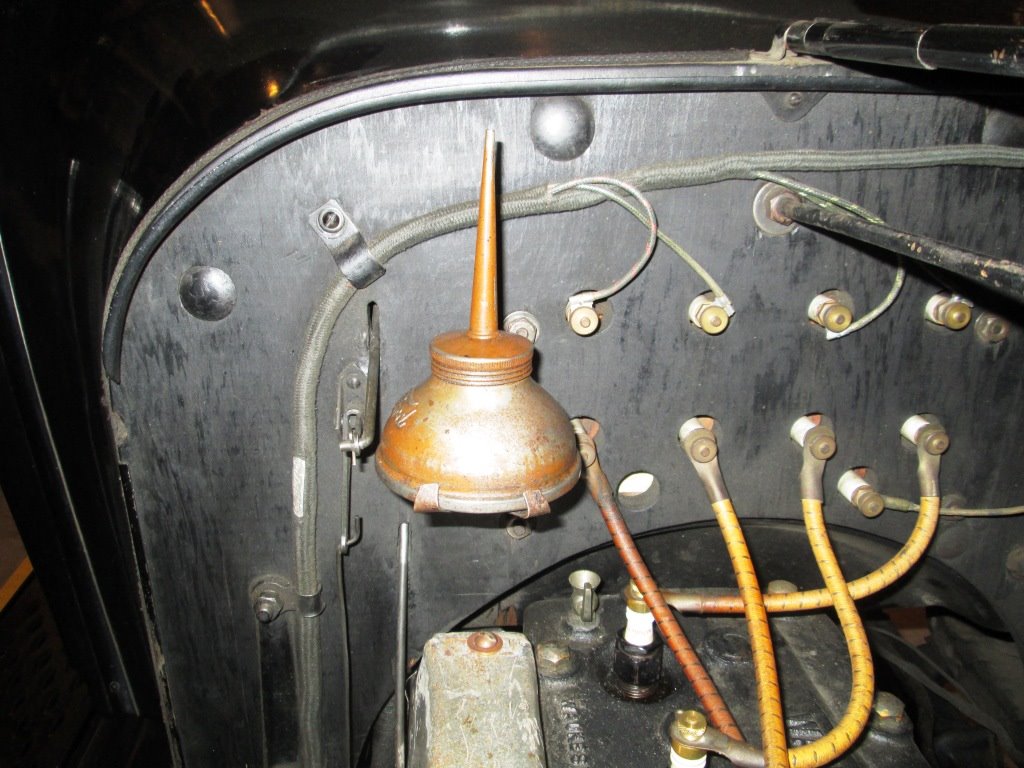

Here's where mine is on our '19 Centerdoor.

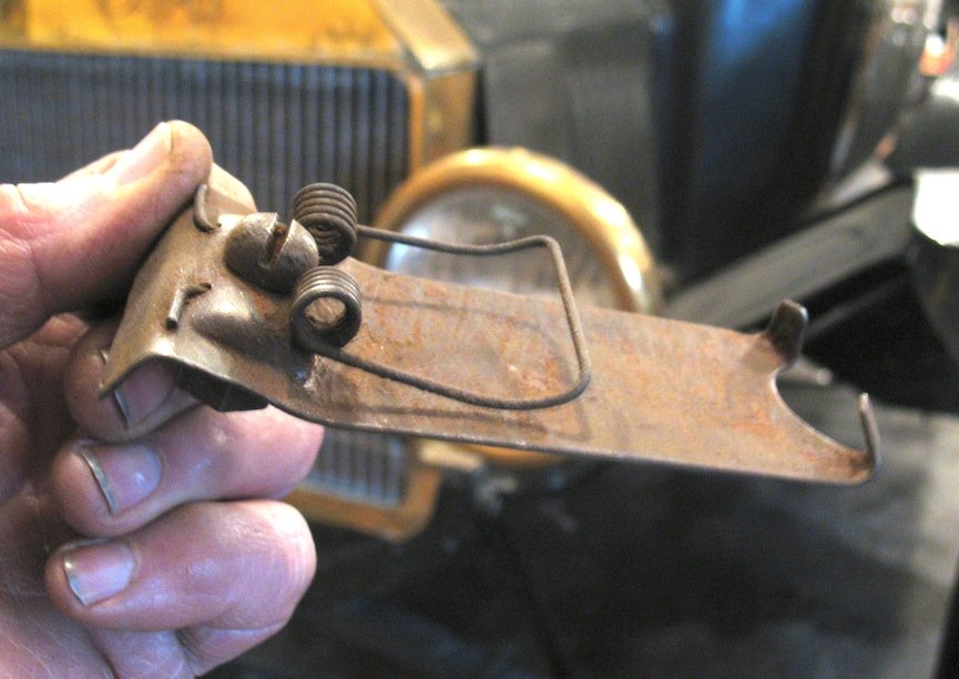

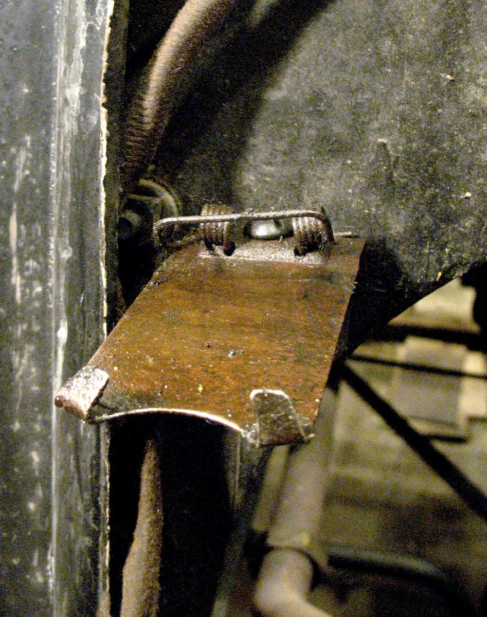

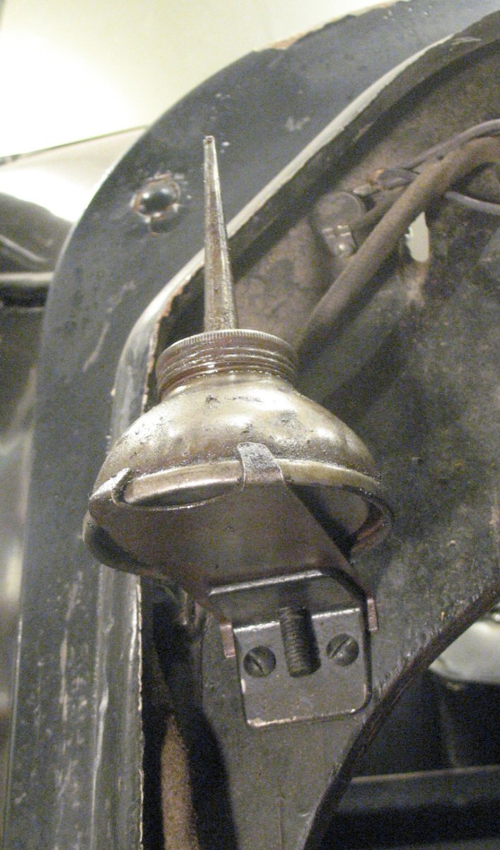

They're not all the same. This is the one I put in my runabout.
I've had it for years and have no clue where I got it. There was just one hole with a short vertical bolt for mounting.
I made a mounting bracket from 2" angle iron and screwed it to the firewall. The bracket has a threaded hole for the mounting bolt which I didn't take time to shorten.
A top view shows the round headed bolt attaching the holder to the bracket. I plan to make a can holder for my touring using a mouse trap spring.
