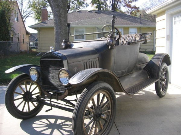

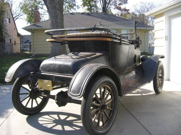

To paraphrase my elderly father, sawtooth tread is "modern tread" and not period correct for a Model T Ford.Steve Jelf wrote: ↑Thu Apr 24, 2025 10:52 amI had to use the link to see what sawtooth means. Is it better than treads on Blockley, Wards, or other Model T tires, or is the attraction here the bargain price?
Regardless, they are good looking tires and, as I posted above, the 30 x 3 tires are true, 30 inch tires so they look great on the 24 inch front wheels of pre-1919 Fords.
My 1917 roadster below has 30 x 3.5 Coker sawtooths all around (some time between 1917 and 1947, the original owner replaced the original factory 24 inch front wheels with later, 23 inch square felloe wheels). Also, if you zoom in the photos, you can see the sidewall cracks. However, they are at least forty years old.

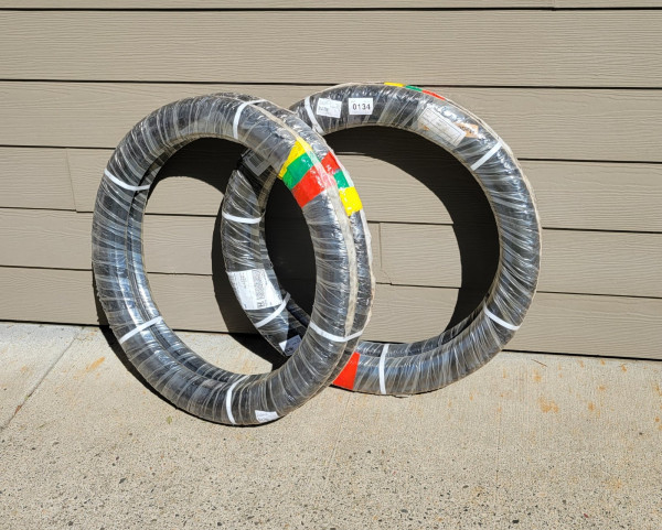

I'm the friend that Keith mentioned, and while shopping for tubes on the Coker website on 4/11, I happened to notice that 30x3 black Non-Skid tires were $78, marked down from $500. I ordered 2, texted Keith, and when I checked on the Coker website about 5 hours later, those tires were now on backorder. Checking 2 days later on their website, my order showed shipped via Fedex and the new tires (wrapped just like ones in Keith's pic) showed up this week, along with the metal stem Hartford tubes that I had ordered. Nothing shady, just a regular online transaction with a trusted vendor. And the contact phone number on their website works just like it is supposed to, during their regular business hours.
I haven't unwrapped my tires yet to look for a date code, but the previous pair of the same tires don't have a date code, so that might be a fool's errand. And just in case anyone cares, the tires have a paper under the plastic wrapping that states "Made in Vietnam", so I expect no country of origin markings on the tires themselves.
Keith does have a good question, what is the best way to store these until I want to replace my current tires. I think that first step is to leave them wrapped in a dry, cool, dark spot. Is there anything else that we should do?

Store in a cool dark place away from any source of ozone, such as an arc welding operation. Leave them wrapped. I would not stack them.
- Posts: 6609
Re: If you need 30x3 tires with sawtooth tread you may want to check this link Coker tire
A cool, dark place is good. Any time you walk past them, pick them up an rotate them 1/4 turn. Long term storage will lead to a flat spot, and any cracking will start where the sidewalls are distorted. Extra long term storage may lead to tyre shrinkage, making them very difficult to fit.
