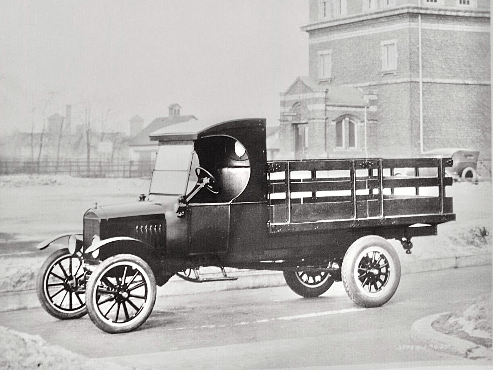

I have my Gramps' TT C-Cab Express - high speed rear end gears & a Warford and I can cruise 35 - 38 most all day !
grandpa's truck0001.jpg (27.44 KiB) Viewed 3323 times
