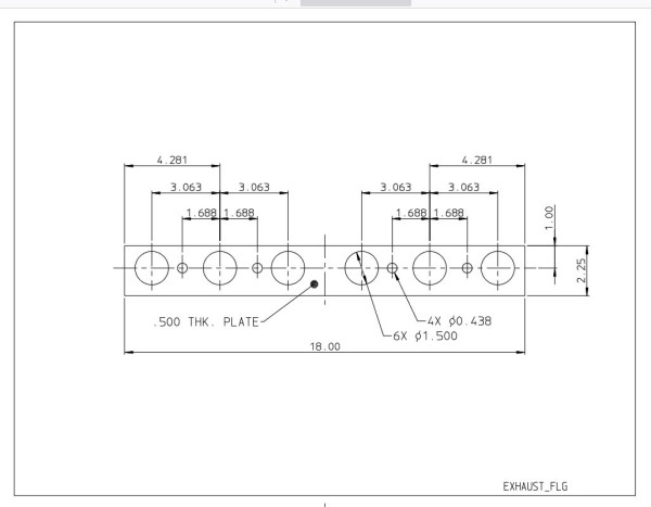

https://www.mtfca.com/discus/messages/8 ... 1543505202
This old post has a .pdf file showing the dimensions to make your own. Chad, I just noticed that this was from your inquiry about it years ago!

Post by TRDxB2 » Thu May 08, 2025 10:47 pm
KWTownsend wrote:
Tue May 06, 2025 3:48 pm
How thick should flanges be for an exhaust header?
From previous discussion
By Scott Elliott, Tigard, OR on Wednesday, November 28, 2018 - 06:32 pm:
Here is a pdf of a Header flange. It shows the dimensions between the ports and the bolt hole spacing. You might want to make the 2.25 dimension 2.50
Include the picture instead of the PDF of it

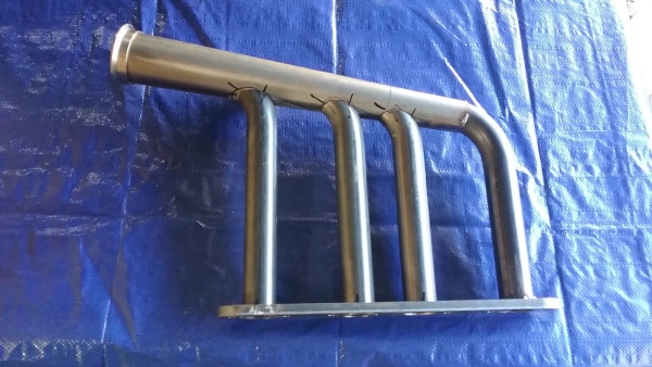

Posts: 1503
First Name: Keith
Last Name: Townsend
Location: Gresham, Orygun
Re: Header flanges?

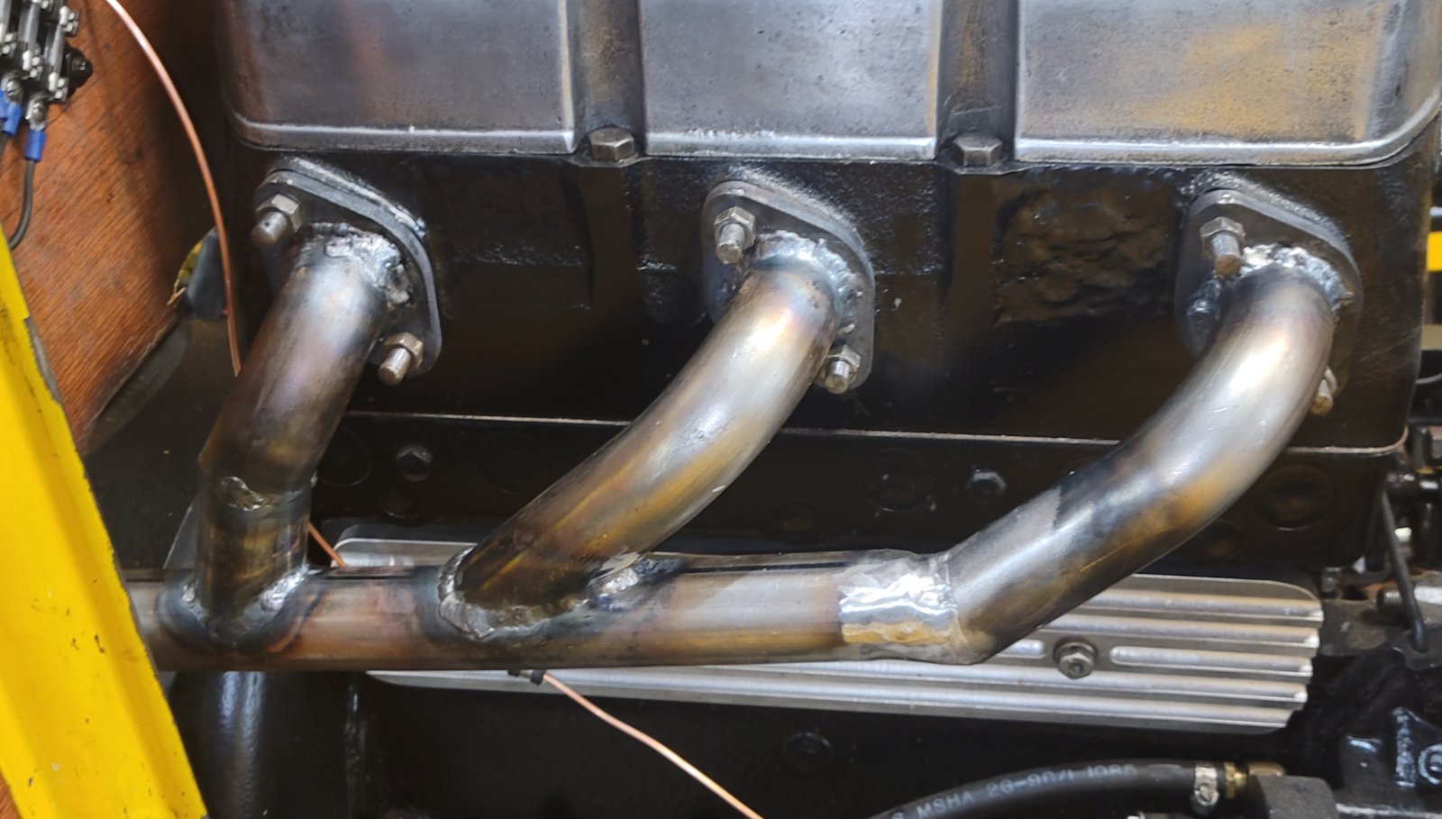

Post by KWTownsend » Sun May 18, 2025 8:48 am
Here is what he's got put together so far...
Mild steel, 3/8" flanges, 1-1/2" steel pipe (1-5/8" OD).
Still learning about heat and warping...
Now I need to find some 1-5/8" ID flex pipe.

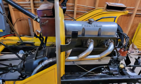

Posts: 1503
First Name: Keith
Last Name: Townsend
Re: Header flanges?

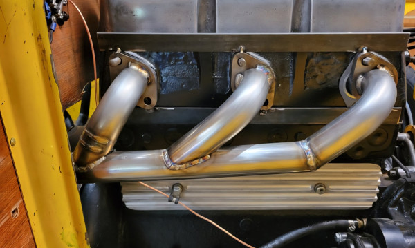

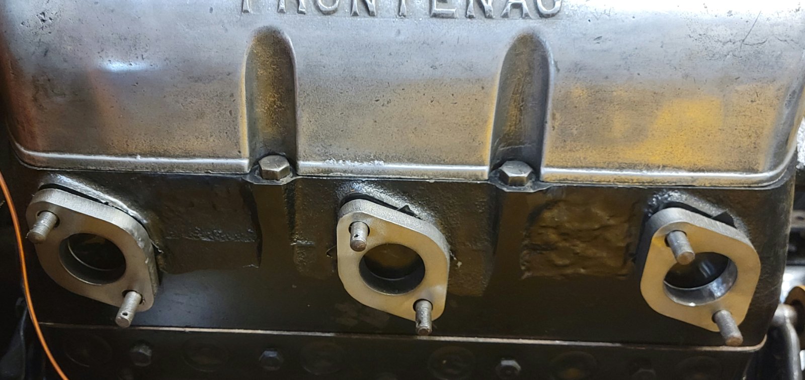

Post by KWTownsend » Thu May 22, 2025 8:21 pm
Spencer is now working on the stainless steel unit...
Kevin Pharis
Posts: 1646
First Name: Kevin
Last Name: Pharis
Location: Sacramento CA
Re: Header flanges?
Post by Kevin Pharis » Thu May 22, 2025 9:34 pm
Lookin good! Noticeable improvement with both tube fitment and welding. I like your flange bracing, did it keep the flanges in place?

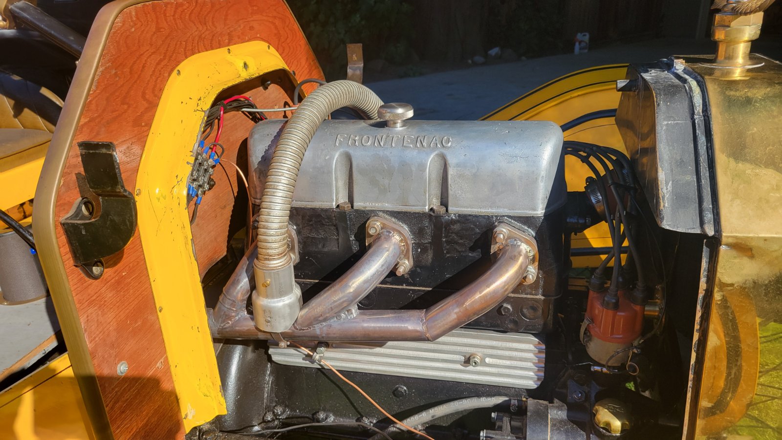

Post by KWTownsend » Tue Jun 10, 2025 11:04 pm
We got the engine running but it was running really rough. Very sputtery and the intake manifold was really cold. I arranged a heat tube from the carburetor to an area near the exhaust header and it ran considerably better, so we made a heat collector and plumbed it into the carburetor. It runs much better.

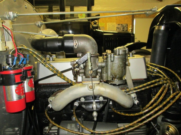

Posts: 5489
Re: Header flanges?
Post by RajoRacer » Tue Jun 10, 2025 11:15 pm
My RAJO has to have HEAT !
Posts: 1503
First Name: Keith
Last Name: Townsend
Re: Header flanges?
Post by KWTownsend » Tue Jun 10, 2025 11:17 pm
What carburetor is that, Steve?
Kevin Pharis
Posts: 1646
First Name: Kevin
Last Name: Pharis
Re: Header flanges?
Post by Kevin Pharis » Tue Jun 10, 2025 11:37 pm
Hmmmm… carb looks kinda familiar ;)

Looking good! I do not envy your son making the flanges out of stainless steel unless he has access to plazma or better still abrasive water jet.
Posts: 1503
First Name: Keith
Last Name: Townsend
Re: Header flanges?
Post by KWTownsend » Wed Jun 11, 2025 8:54 am
Bill,
He cut them with a plasma cutter.
Posts: 5489
Re: Header flanges?
Post by RajoRacer » Wed Jun 11, 2025 11:37 am
My Racer sports a Winfield SRBD.
