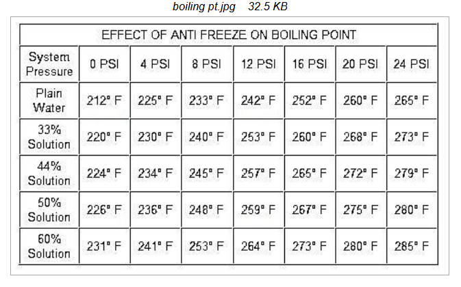

Some facts
-Most agree that Model T engine operating temperature between 170-190°F
-Water boils at 212°F
-Water's high heat capacity and thermal conductivity allow it to absorb and transfer heat more effectively, making it an ideal coolant for various applications.
-Anti-freeze & Coolant specifications for boiling points are for pressurized systems.
-Anti-freeze & Coolant specifications for freezing points are independent of a pressurized system.
-A pressurized system significantly increases the boiling point of coolant. For example, a 15-psi radiator cap can raise the boiling point of a 50/50 coolant mixture by 45°F.
-Rislone® Hy-per Cool™ Super Coolant (and others) containTechnology wetting agents that make a system dissipate more heat more efficiently, reducing engine temperatures by up to 25°F helping to prevent overheating.
-A 50/50 mix of coolant and water in a car's pressurized cooling system typically operates within a range of 190-220°F
-The Model T uses a thermosyphon engine coolant system using the natural movement of heated fluid to circulate coolant and remove heat from the engine. This method relies on the principle of convection, where heated coolant becomes less dense and rises, pulling cooler coolant behind it. No pumps or other mechanical devices are required for coolant circulation.
-Distilled water is“ionically hungry,” so it will actually strip electrons from the metals in a cooling system as it attempts to chemically re-balance itself.
-Softened water has removed the impurities and minerals during the distillation process buy than replaces the stripped electrons with a sodium ion. making it ionically balanced. The process used is reverse osmosis that eliminates contaminants such as lead, pesticides, heavy metals, and fluorides.
Okay so what?
-Model T's cooling system is unpressurized so its boiling point is dependent upon altitude.
-The coolant chart shows that the best ratio of water/coolant is 60% coolant. Higher rations give a negative effect on the freezing point.
-The pressure chart gives a good indication of boiling point based on antifreeze mix.
-Use Softened water
Conclusion:
-The higher the elevation the lower the boiling point of water is naturally, but more concern on freezing in the winter. So selecting a coolant ratio based on freezing point. The boiling point will be lower naturally & in selecting based on the freezing point 8-)
-If you cause the boiling point to be to low, then the thermosyphon action may be ineffective. Then this could effect the engine efficient operating temperature, 170-190°F.
boiling point.png (297.37 KiB) Viewed 7486 times
