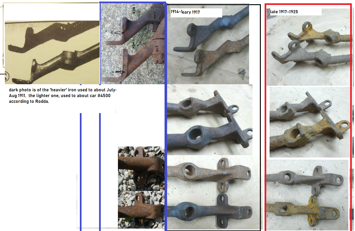

Can't get the link copied. so Google Front Fender Brackets TRDxB2 MTFCA. There is addition pictures and explanation by year

'15 - '17 posts have straight, parallel sides that fit into the one sided fender iron mount, if that makes sense - later stems were "beveled" for the re- designed iron mount as Frank shows above.

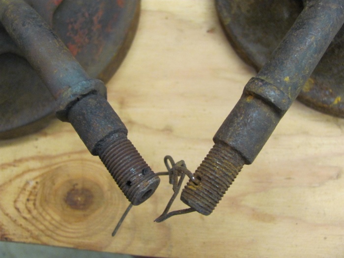

Early style bucket stem on right, has straight sides to fit the early fender post mount, '15-'17.
Later on right, with wedge type stem.
