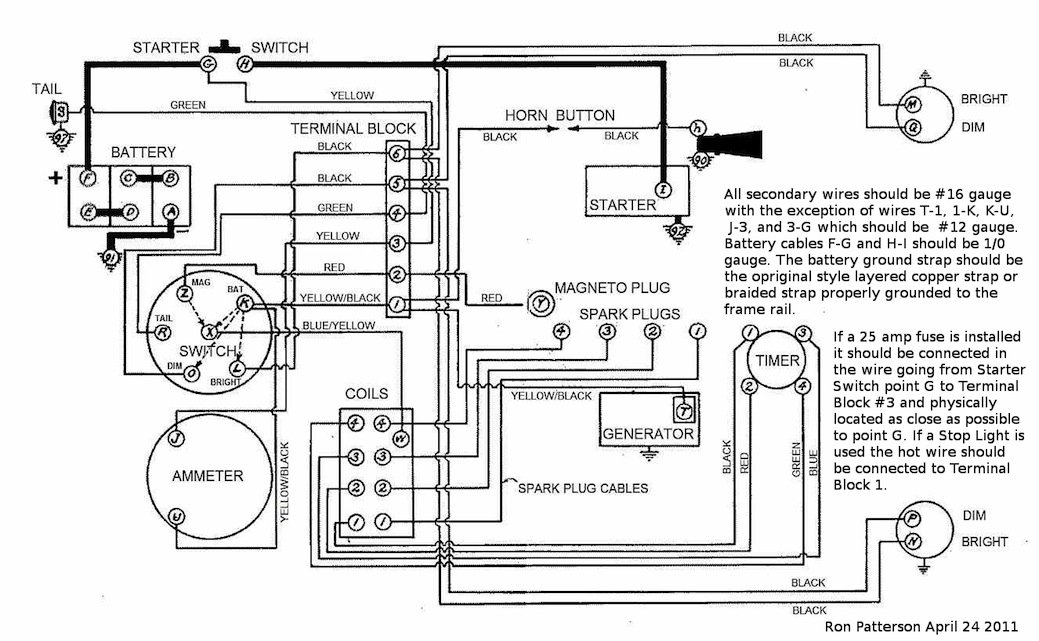

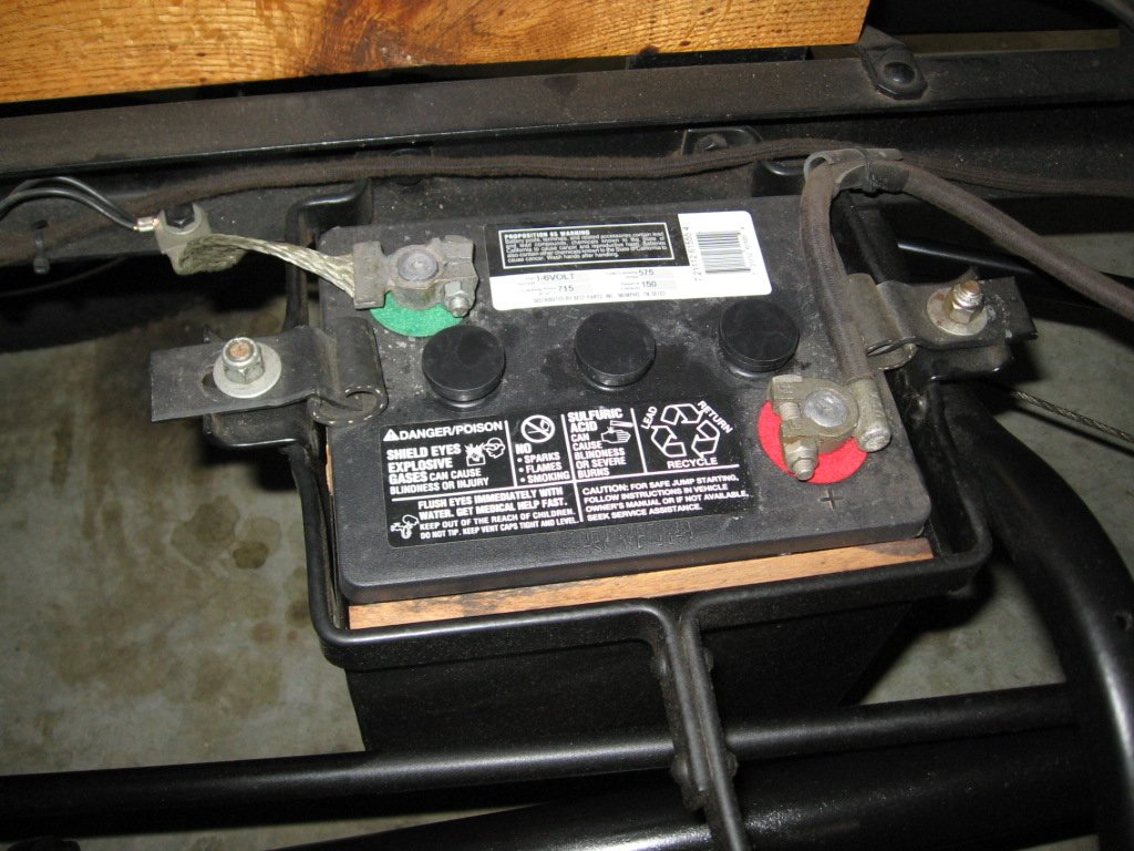

Re: Changing ground + to -
Post by Moxie26 » Wed May 14, 2025 2:53 pm
Dan has good advice, except your battery cables are at a set length.......It's better to unclamp your battery from a carrier. Pick it up. Rotate the battery 180° reinstall so the negative terminal is closest to the driver side rail of the frame, the connect the " short " negative battery cable... then the longer cable ( positive + post ) that goes to the starter foot switch.
Post by Moxie26 » Wed May 14, 2025 3:59 pm
Hope these online pictures are helpful.
Post by Moxie26 » Wed May 14, 2025 5:35 pm
Close-up on positive terminal starter switch cable

The Model A ran with a positive ground. The cutout is different. The Model T is negative ground. Don't know whether the starter is wound differently for pos or neg ground, but it might be. You don't want the starter to spin backward. The coils should work either way, however, if you have a distributor, Not sure.Your spark plugs might have a problem? If you are using a radio in the car, it might also cause a problem So be sure why the polarity has been reversed.
Posts: 2026
First Name: Robert
Last Name: Jablonski
Location: New Jersey
Post by Moxie26 » Sun May 18, 2025 8:01 am
Good morning Norm... I totally agree with you.... The whole basis of this problem reverts back to improper battery installation. I've seen this a few times in the last 40 years where people, on their own, assume... the Model T electrical system worked the same as the later Model. A electrical system being that it was a positive grounded system..... Not purposely ignoring any Model T information but just assuming that it was the same. ..... And for those who experienced these assumed " problems " , installing the battery with the proper negative ground fixed the problems. It is amazing how by following manufacturers guidelines will cure assumptions and ignorance.

The "20%" in Tom V's post refers to the potentially weaker spark when the high tension current flow is not in the preferred direction (preferred = electrons from spark plug center electrode to grounding strap).
I do not have any questions about wiring the connections in the car and have no disagreement with Ron's diagram. The connections I am referring to are on the internal high voltage secondary windings inside the coil boxes which are not shown on the diagram.
If Martin's car has a distributor, then Tom's suggestion is easily accomplished. If Martin's car has stock coils and timer, then likely no connections involved were modified when converted to positive ground, so nothing needs to change to revert to negative ground.
