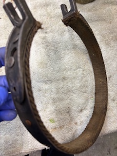

Post by LittleTimmy52 » Mon May 19, 2025 2:35 pm
The cotton linings look a lot like cotton web you can buy by the roll off Amazon, can I use cotton web that's the right width and length of course? (I need to just replace my low band)

1917, I'm no expert hence my asking but cotton web looks just like Scandinavia cotton linings and are a good deal cheaper.

Whatever current "cotton" webbing you are looking at, in no way has the same weave pattern as original Scandinavia & some later Cantex lining - the latest Scandi "tar babies" have a weave like modern cotton webbing - all I looked at online has the weave that "fades" under pedal pressure.

I don't see the mention of several other things such as the weave and thickness of the belting. Most of the woven belting is going to be too thin and a loose weave.
