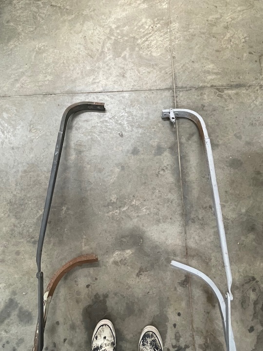

Well it's time to start looking at the top and boy do I have questions. So here we go
1. Are these the correct top irons for a 1926 Touring car?
I got a work kit from J P Auto Wood.
So why are there no holes in the irons for the rivets that came with the wood kit? Do I need to drill them? Was the original wool just crimped in the irons?

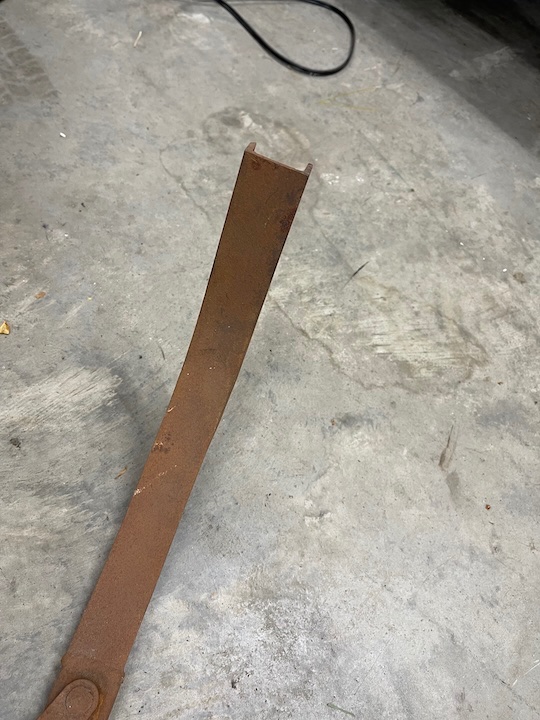

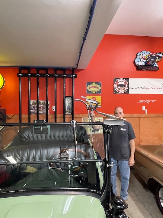

This clamp was welded on but I've seen them screwed into the wood and it looks like there are holes in the clamp to mount to the wood.
But it does seem to fit the car. Maybe when the wood is placed in the iron the clamp will then lind up on the front wood bow?

Post by Norman Kling » Tue May 27, 2025 10:40 pm
The most important part of the wood installation is the distance between the two clamps on the top of the windshield posts must be exactly the right distance apart. I took a strip of oak veneer and laminated it as I bent it to fit in the curved part of the bows. It will accept tacks works very well on my car.

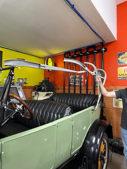

On my '27 touring the front brackets are bolted and screwed to the windshield post. The rear of the front bars are bolted to the next bar back. All of the other bars are riveted together except where the long rear bar is bolted to the body. The only exception to this is that the second bar back is attached to the rear upright bar with a pin and spring clip.
FWIW - I don't think there is a single factory weld in the car.

To Mopar_Man/Robert G.,
This is all excellent advice you've been given! However, I'm sorry to say that I would be hesitant to try fitting an expensive top kit to those bows. Do a lot of trying out & inspection before committing the top material to those bows.

Re: 1926/7 Touring top bow questions.
Post by Mopar_man » Mon Jun 02, 2025 11:25 am
Well leave it to Steve Lang to solve the mystery. He noticed that each top looked like it was welded on. Sure enough I looked and he was right. Someone must have cut the tips off and welded C channels on each part. I can not overemphasize the value that Lang's is to the Model T hobby. What great people to work with and what a knowledge base. I just sent an e-mail to Jeff who has a set for sale. This looks like his first time posting so I've got some checking to do.
