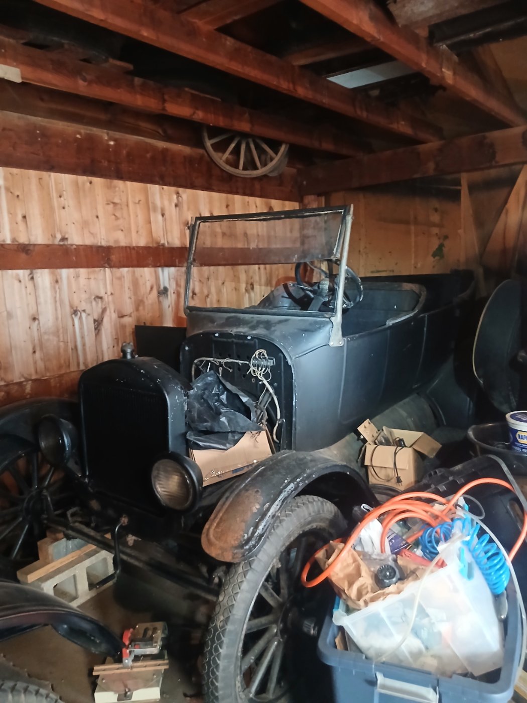

Here is the car as of now, in the corner of the garage.

I recommend that you get the mechanicals working before starting on swapping the body.

In my over 50 years in the model t hobby, I have found it is best to avoid major modifications and spend the time and money making a good reliable car as close to the way Henry made them. You look like you have a solid and rather complete touring. I would leave the touring as a touring, and if you really want a roadster pickup buy a decent roadster to start with. In any event, good luck with your project.

Get it out and get it running as well as you can, then you'll know what it needs.
