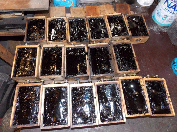

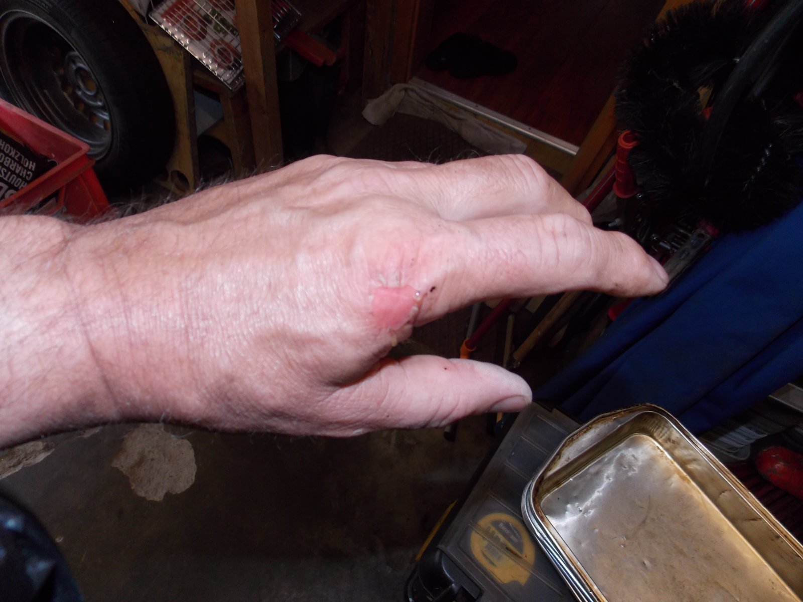

After rebuilding a few hundred coils during 12 years, I now know why I should wear gloves while pouring Tar in the rebuilded coils.

Owwie ouch!.... ( plus explicatives )... Been there done that, it happened with my second set of rebuilt coils years ago.

Where do you source the "Tar" from Andre? I have reused some from old coils but never have enough.

Ouch! I wear my welding gloves when I pour coils, this is a good reminder for me.

I use the old tar I took out of the coils.
To fill up the missing tar I have 10 kilo of new tar that I had from a nearby roofing business for free.
