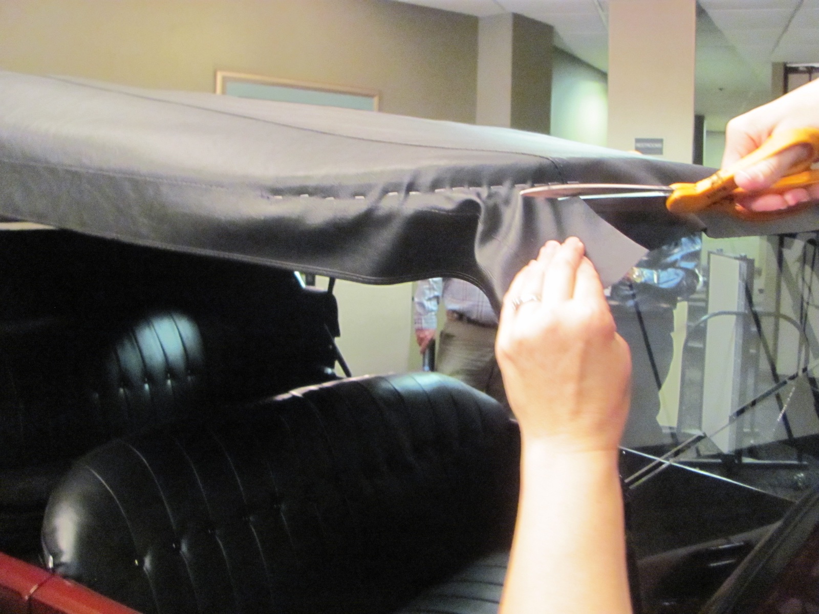

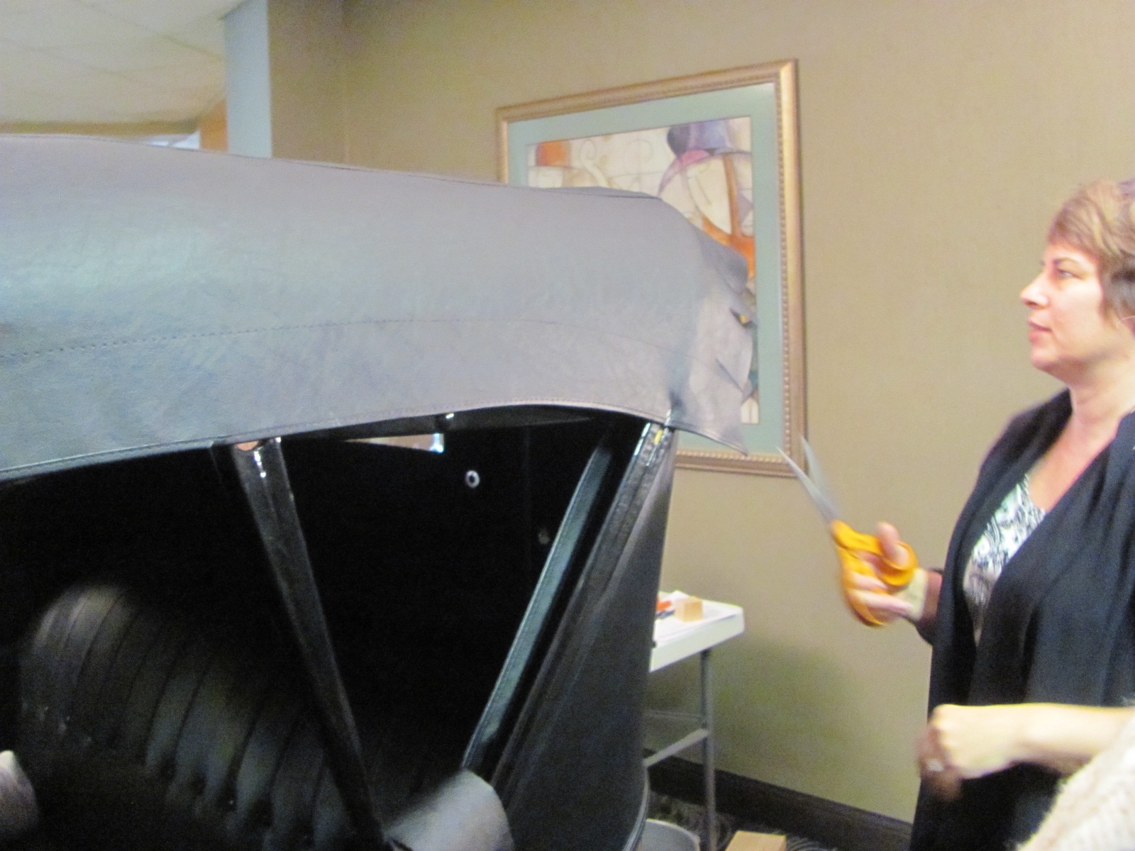

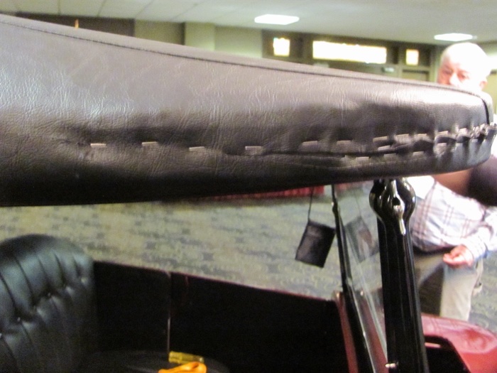

And some photos of of Elizabeth on doing a '27 top, these were taken at a work session she gave at a T meeting.
This video is from Classtique Auto Upholstery, while it is a '23-'25 still very useful for the '26-'27 as its a one-man top with slant windshield.
Just the mentioned dimensions may not apply fully, but real good for install details.
https://youtu.be/h6Y8gKaKIrs
