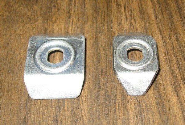

I agree with Steve. I think they are ugly. and they are using the wrong valve stems for their tubes.

Take note of the original bridge washer pictured above. The reproductions don't have the ridge seal stamped in.

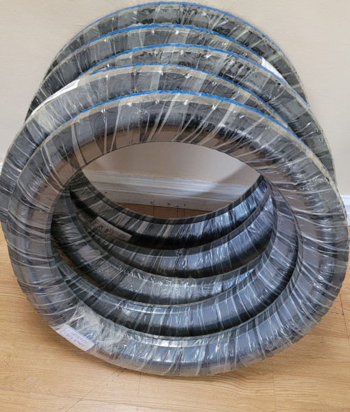

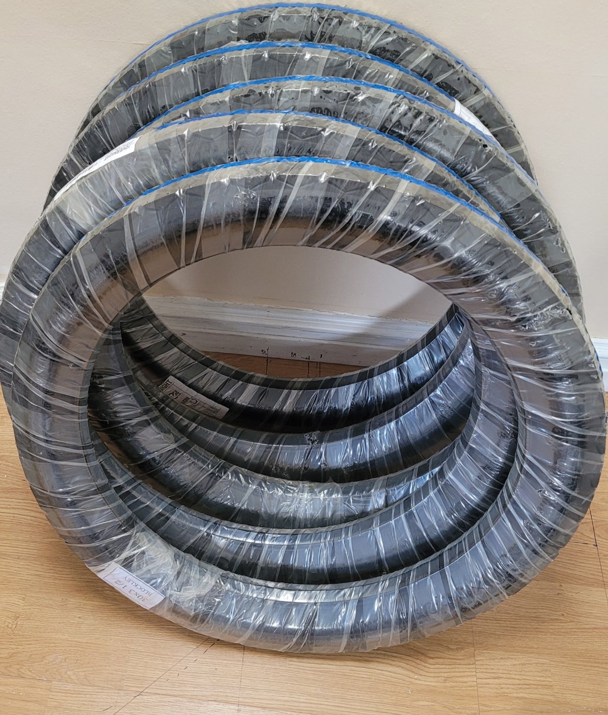

Here is my new set at a friend's house in London.
I guess I'll find out when they cross the pond.

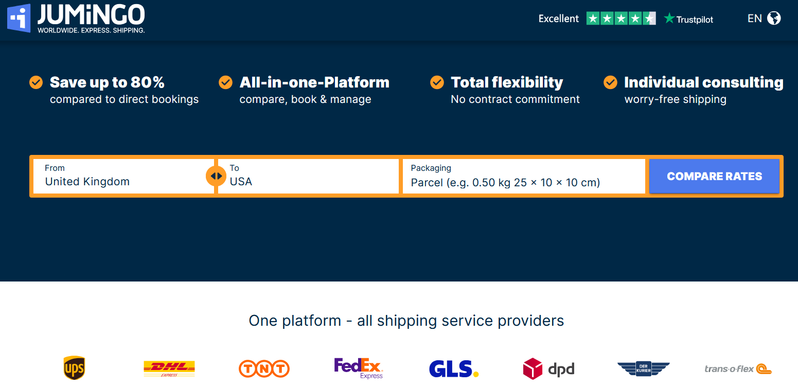

You or your friend should look into the JUMINGO shipping app https://www.jumingo.com/en
It provides many alternative carriers. At the advice of a friend in Germany, I shipped to packages each 9"x9"x9" to him. One 25lbs the other 15lbs via DHL. DHL heavily discounted the shipping cost when both packages were shipped together. In fact it was almost like the 12lbs traveled free.
I dropped off the packages for a Monday DHL pickup location (Mailboxes & Parcel Depot), he got them Friday of that week.

Regarding bridge washers, the Model A Ford bridge washers currently offered by the vendors do have the sealing ring stamped into them. However, they are wider than Model T era bridge washers and have to be cut back and the edges files smooth.

My friend is looking into this shipper. He ships a lot of Corvette parts from here to the UK.TRDxB2 wrote: ↑Thu Jun 19, 2025 1:22 pmYou or your friend should look into the JUMINGO shipping app https://www.jumingo.com/en
He just dropped off my blockney tubes. He carried them on the plane in luggage. LOL

It's nice to see someone finally posted a correct photo of a Model T bridge washer! Why can't Coker do this?
