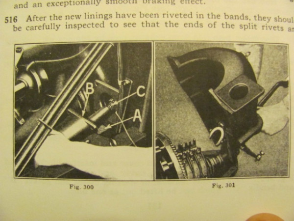

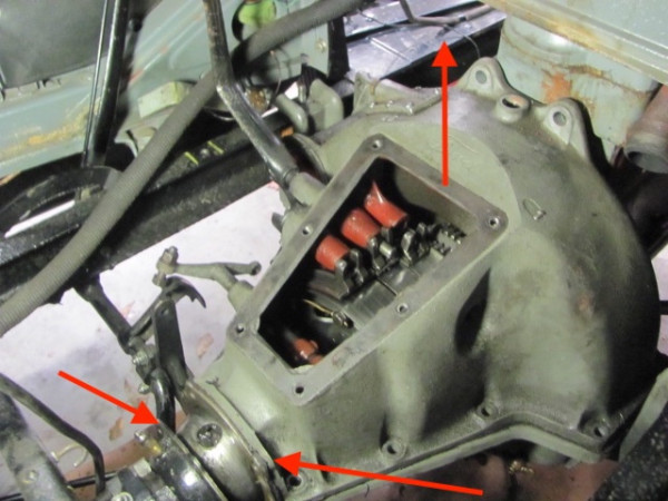

The hogshead should remove by lifting straight up, sometimes a small tilt to the rear. Then when free of the engine block, tilt back to remove.
But be sure the rear U joint ball cap is free, remove bolts top and bottom. Sometimes sealant there keeps the back end down.
Free bands, and all other attachments like outside oil lines.

Remove the exhaust manifold. (it may be possible without removing the manifold, but I found it must be removed to re-install, so pull it now.)
Remove the 4th main bolts.
Pull back the 4th main about 3/8". You can use a stack of spacer washers or a 7/16 nut with a longer bolt to keep the ball cap back @ one or both of the lower 2 mount holes.
Pivot the HH up @ the front.
