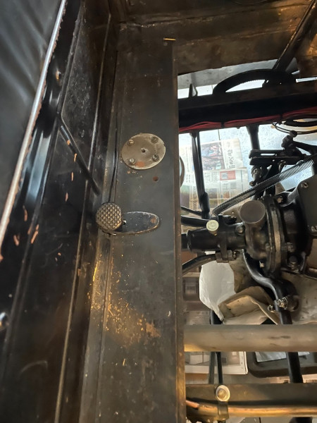

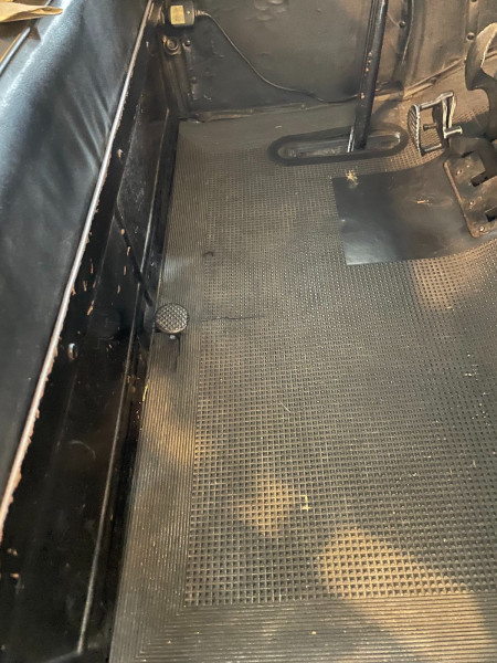

aDave
Posts: 354
First Name: David
Last Name: Dufault
Re: Aermore exhaust whistle pedal mounting
Post by aDave » Fri Jun 13, 2025 12:08 pm
Small Pedal is for the Whistle; large disc is the top half of the Bermuda Bell (plunger hole)
....either operated with right heel.
Post by WillyR » Fri Jun 13, 2025 12:33 pm
Small Pedal is for the Whistle; large disc is the top half of the Bermuda Bell (plunger hole) pedal2.jpgpedal1.jpg....either operated with right heel.
awesome thanks so much!
I have my bermuda, about where the white plastic bag is in your first pic so my passenger can actuate it.
I think I'll mount either a pedal or a choke cable about the same vicinity as your pedal.
I think I'm leaning more toward a choke cable mounted to the seat riser...

Posts: 7309
Post by Allan » Fri Jun 13, 2025 5:13 pm
Thanks Dave. That board is also what is on my Van. I am fortunate to be driving a RHD car. It makes it much easier to make the connection to the pedal and whistle using a rod rather than cable.
