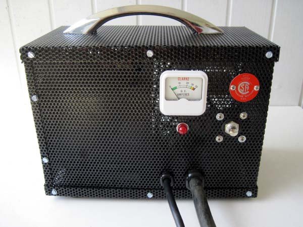

I use an old Golf Cart Battery Charger that used to charge six 6-volt batteries.
It puts out 40 Volts DC and $0 amps DC or a little less if the Mag Coil Ring measures more than 1 Ohm.
The Timer was changed to push button and three 5 second Zaps does a full charge.
Laying the Mag Coil Ring on the Magnets, with the transmission assembly sitting on a 5 Gallon bucket will let me pick up the Coil Ring and the transmission will still be attached.
Back in the vehicle I just did, this will provide 11 VAC at Idle and 22 VAC at 25 MPH.
