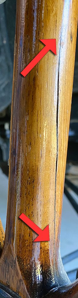

I have 30 x 3.5 demountable wheels. Two have been rebuilt by Stutzman and two are original. One of the original wheels has a single spoke that has a crack. In fact, there is a crack on both sides which may go all the way thru....I don't know. The spoke is otherwise very solid and the other spokes are likewise very solid. The tenons are in good shape, not eroded away like some.
My question for the group..... I'm considering a repair by injecting an epoxy resin into the cracks. Alternatively, if the collective wisdom of this group is that it's time to rebuild....that's what I'll do. I've some health issues that have slowed me down this year but I do hope to be able to drive my car and participate in a couple of Michigan events before the season ends.

Thanks for your comments. I have to scale back my driving this summer due to medical reasons so this is what I think I'll do. Inject epoxy into the cracks, at the same time giving the wheel a very thorough inspection. When the season ends, the wheel is off to Stutzman's for rebuild.

Also inspect the back sides of the spokes. There might be other cracks which do not show.

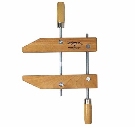

I think “Titebond Ultimate III” exterior yellow wood glue would be better than epoxy and wooden screw clamps are the only clamp that could apply enough pressure to close the crack completely. To get the glue deep into the crack, press it in with your finger tip and keep putting it in. You can use a blower or blow it using your lungs to blow the glue to the deepest points of the crack. Have a damp rag handy when you start clamping because much of the glue will come out. You will probably need at least two clamps to apply uniform pressure to the crack.

That's the stuff I use. Just be careful clamping. Completely closing the gap is not the way to go. Clamp firmly but not so tight that you expel the glue. I n your situation clamping may not be needed.

Sorry. I must disagree. Wood glue will not hold if the gap is not totally closed. If the gap is even slightly open the glue will fail as the glue is very weak if not adhering to something other than itself. The glue will not attain full strength unless the two sides of the crack are totally closed and making tight contact with eachother. Any glue that is squeezed out is not needed. The only glue that is needed is the glue remaining between the two surfaces after they are clamped tightly closed.
