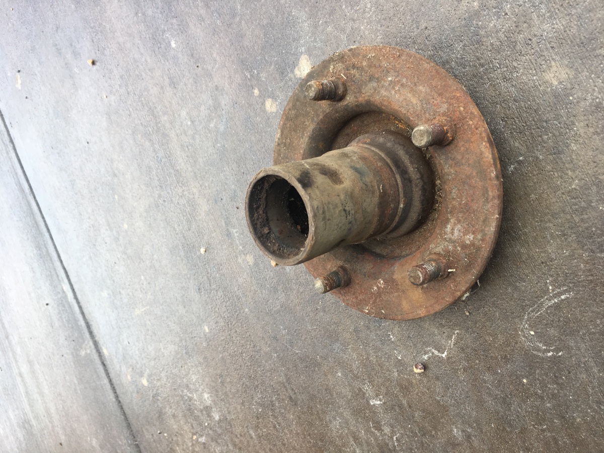

Help identify wire wheel hub?

Post by Dennis Fleming » Thu Jun 27, 2019 5:48 pm
What does this hub fit?

Re: Help identify wire wheel hub?
Post by HornsRus » Thu Jun 27, 2019 6:40 pm
could be model a ford. charley
Post by Henry K. Lee » Thu Jun 27, 2019 7:07 pm
I agree with Charlie, if it is 5 on 5 1/2" pattern.
Hank
Post by Mark Gregush » Thu Jun 27, 2019 7:12 pm
Ford Model A
Post by HornsRus » Thu Jun 27, 2019 8:41 pm
it would be 29 - 31. ars are not like that.charley
Post by Tim Williams » Fri Jun 28, 2019 1:13 pm
why did Ford go to different spacing on the bolt pattern with Model A? I know question has probably been answered before.
Post by Henry K. Lee » Fri Jun 28, 2019 1:14 pm
Strength vs more speed, safety, of course.
Post by Layden Butler » Fri Jun 28, 2019 4:24 pm
