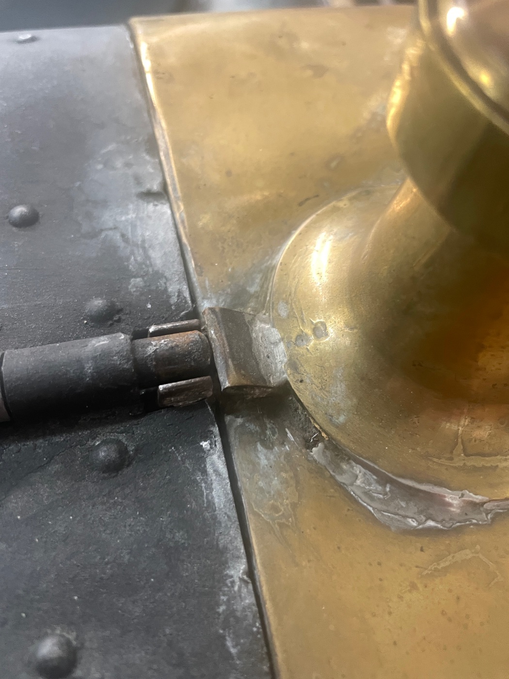

John, there is no mention of it being cut shorter. As others tell, they can migrate, either forward or back, probably due to vibration. The radiator will stop it going too far forward, but the mod shown in one of the photos will stop it wearing a hole in the top tank. There is nothing for it to come up against at the back. It can disappear into the void in the hood shelf. The shoulder I soldered on stopped this, and helped disguise the worn hole in the shelf. The other trick is to do some damage to the hinge rod to make it a firmer fit in the panels.
