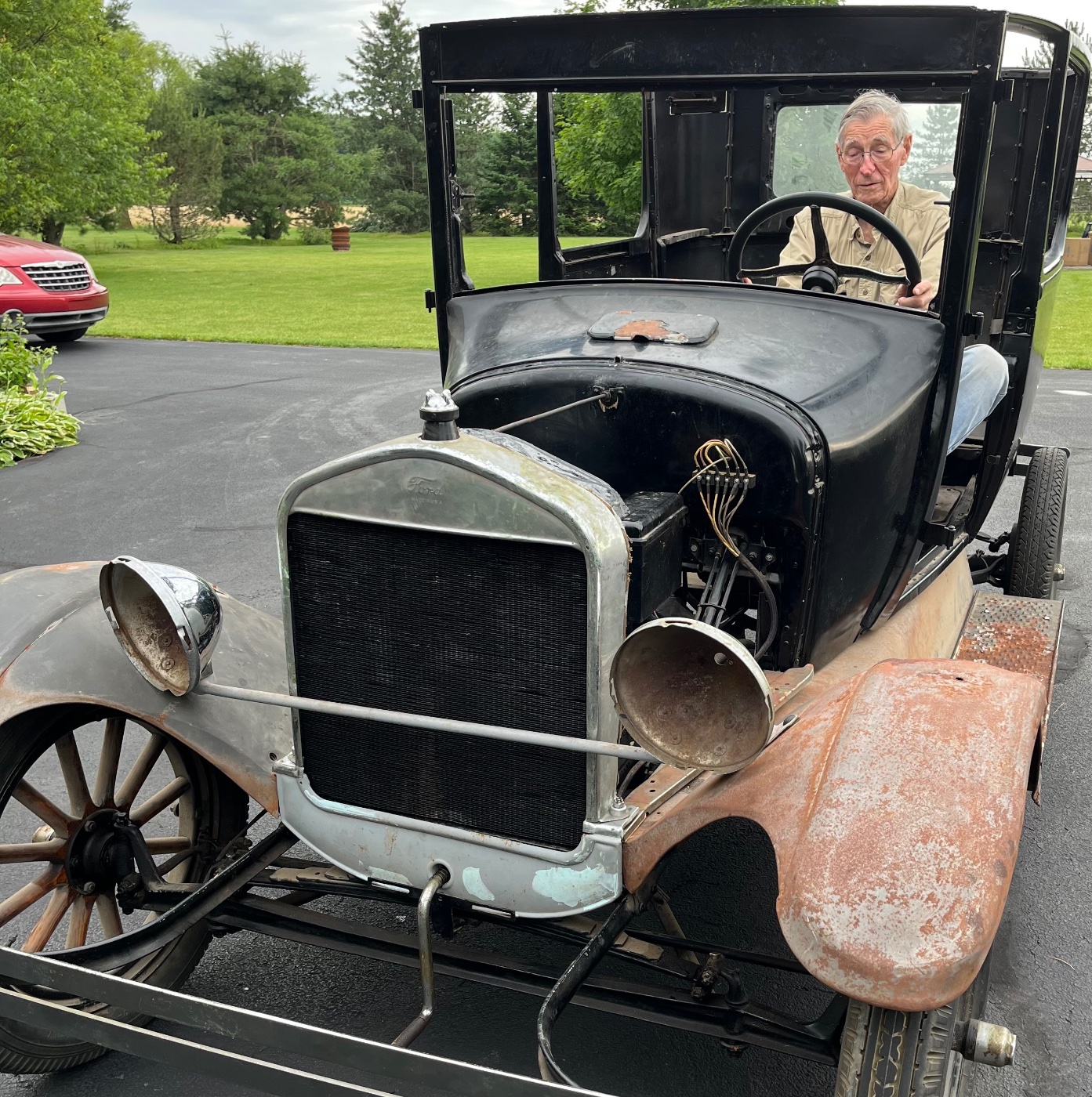

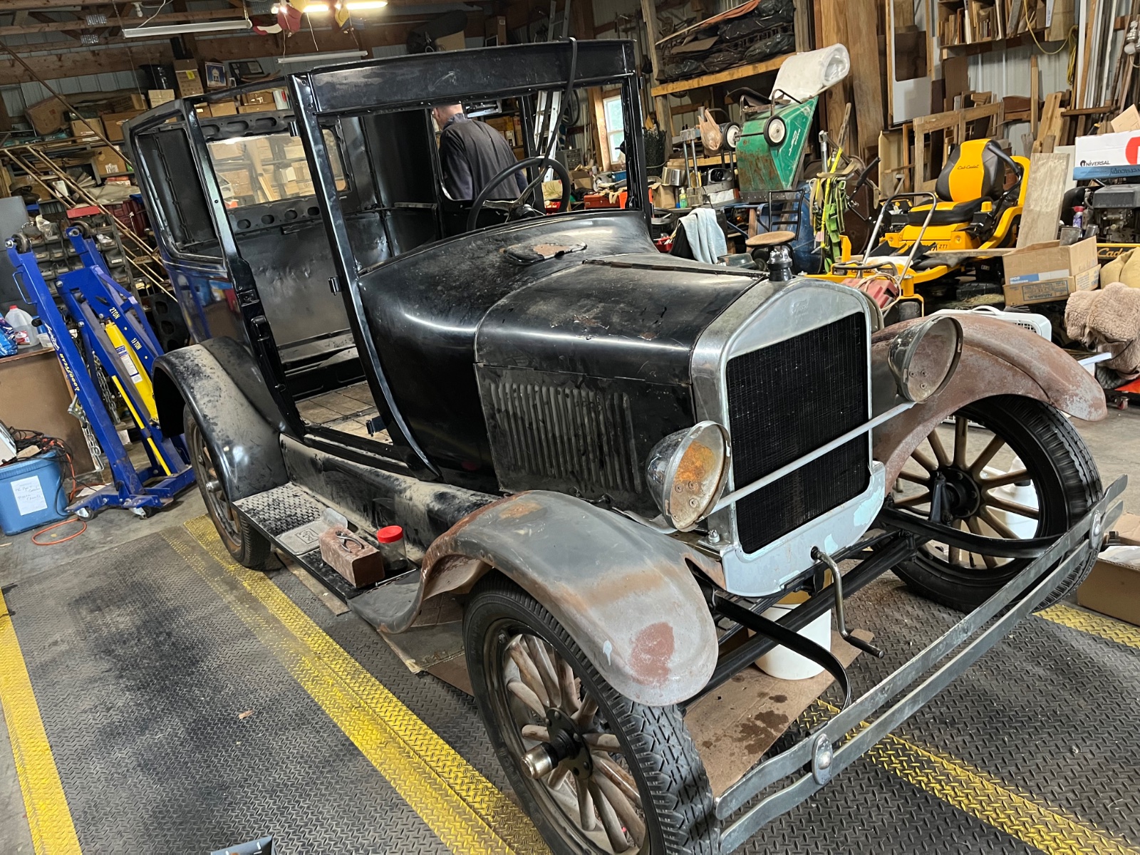

So I finished another week at my parents working on the model T with my dad and sister. I feel like it’s mechanically and electrically good enough for now so we started on getting the body all together. My dad had bought this partially restored 35 years ago but life kept him too busy to work on it.

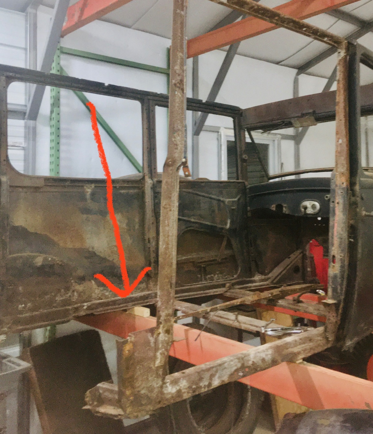

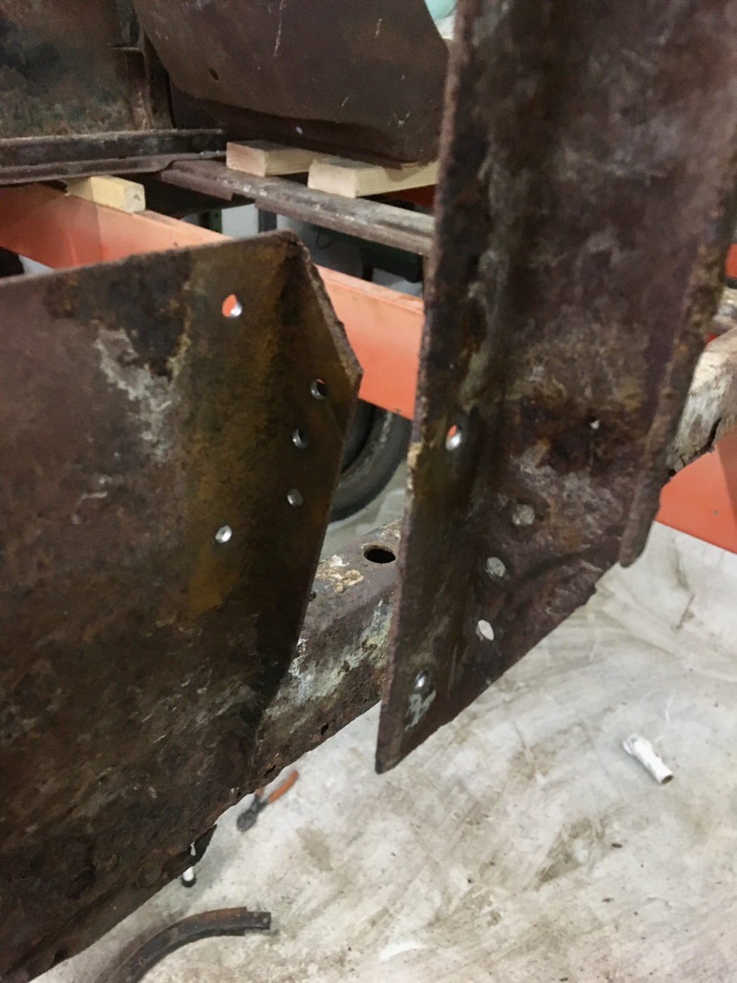

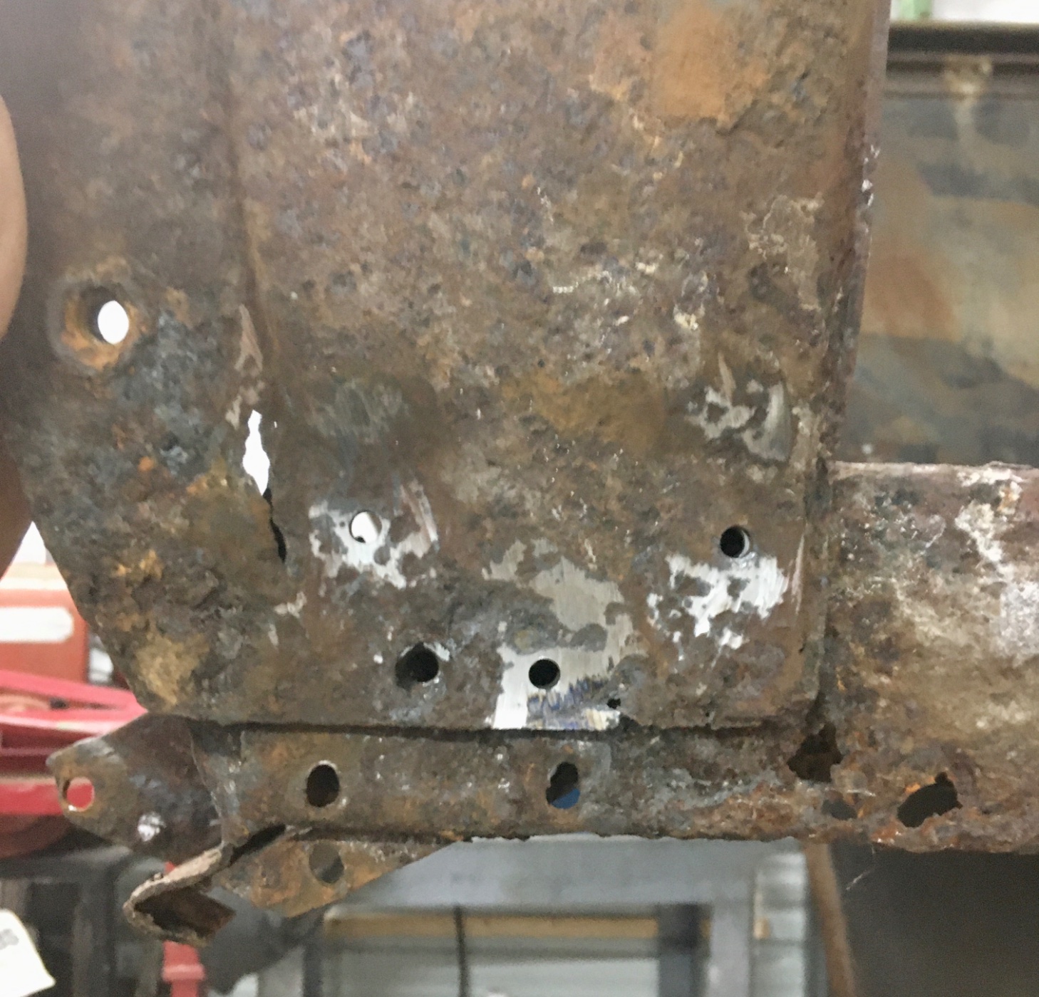

Question#2
This I believe is the little plate you are referring to for the fender mount.
I would try to drill out the bolt and re tap or cut the attached nut off and re weld a new one on. The plate is spot welded in many places that require removing the quarter panel.
these show spot welds removed and it also is attached to a vertical support.
Mine was a complete mess. I decided to disassemble everything and turn it into a closed cab pickup.
