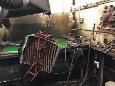

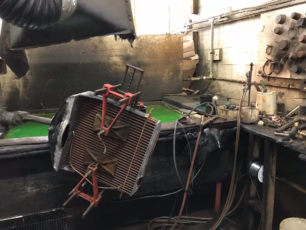

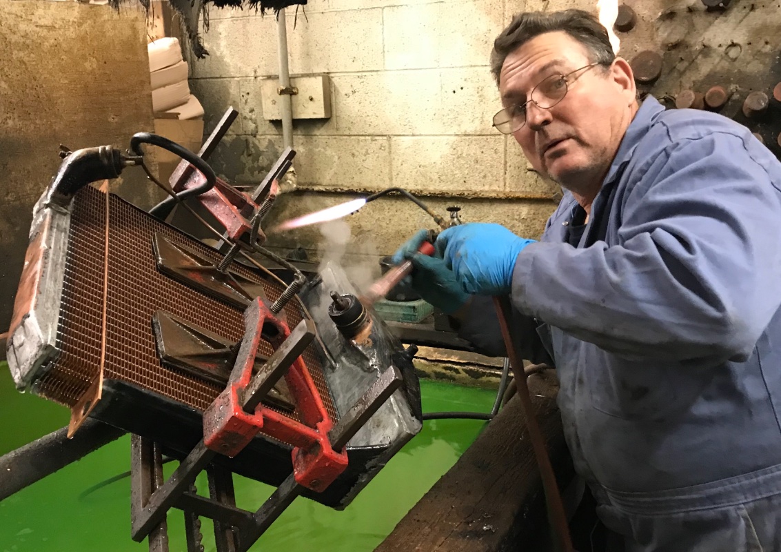

I took a break from working on the website today and stopped by the radiator repair shop to check on progress. The core arrived yesterday and the owner, Randy, was assembling it and he let me watch the whole process. There really is an art to doing this right, and Randy is an artist. He’s been rebuilding radiators with his dad for 50 years.

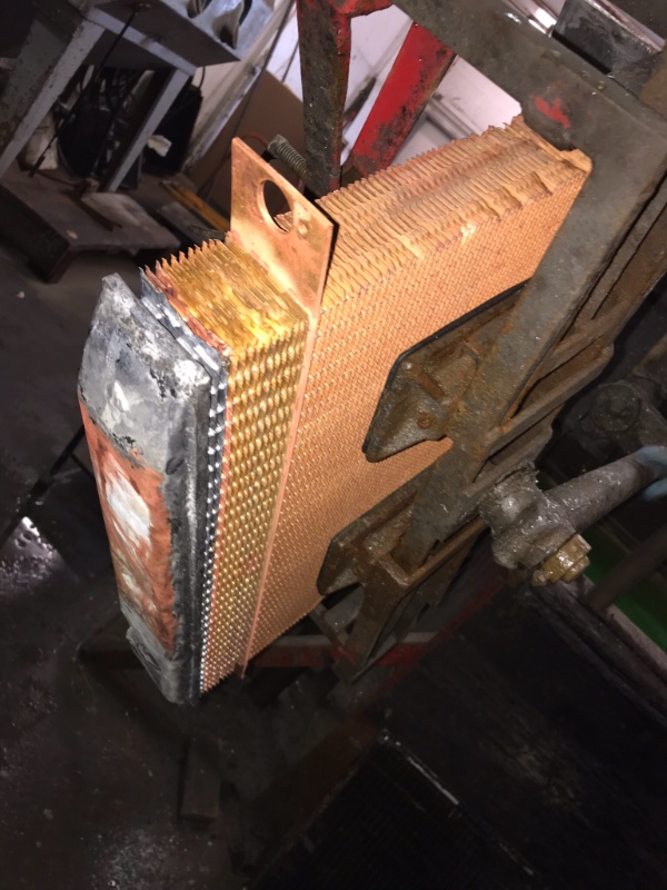

The core came from a shop owner in Oakland who worked with Randy’s dad for decades. He has all the jigs to build literally any radiator core. It took one day to turn my core out after he got the exact specs from Randy.

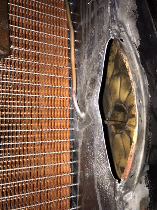

What a great rig for holding this awkward unit! Hole for the overflow had to be drilled and then soldered in place

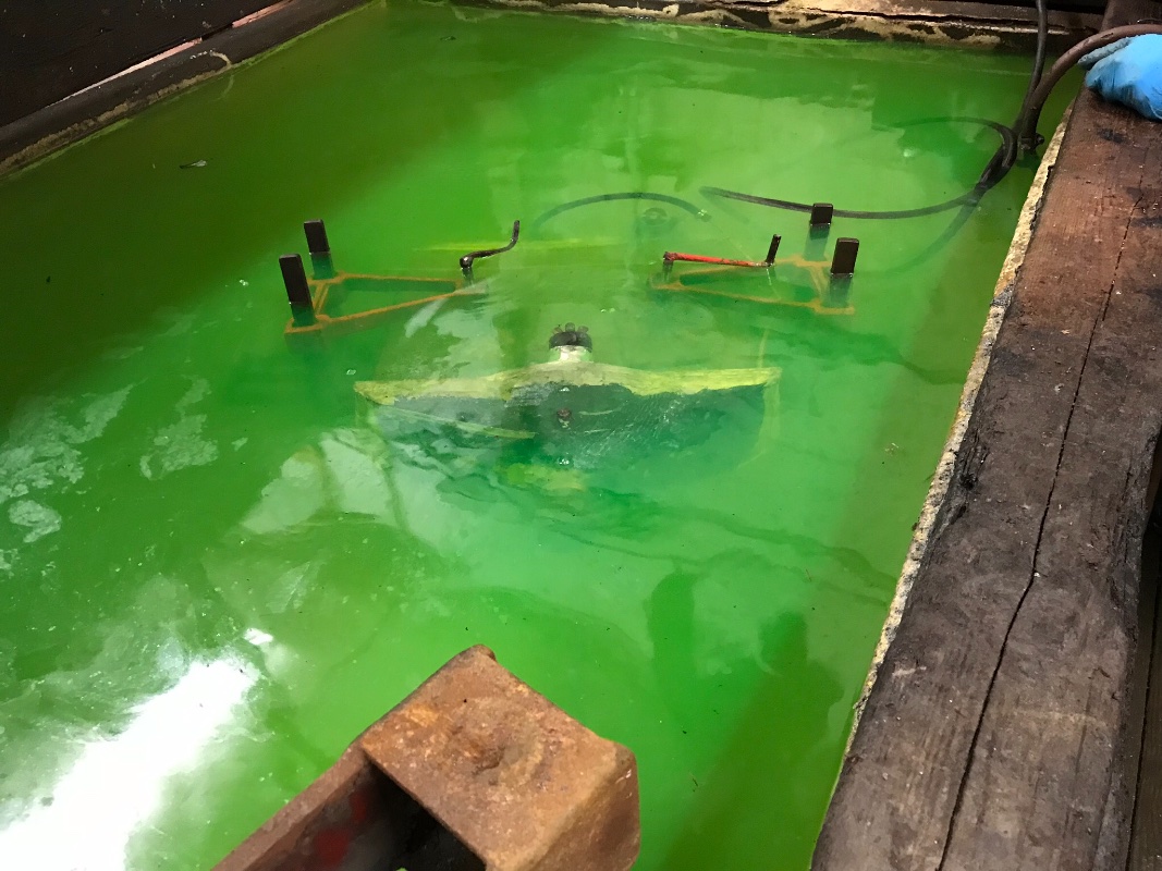

The bottom cap was soldered in place The inlet and outlet fittings were added next And finally the whole unit tested for leaks. No more than 5-10 PSI. Success! Tomorrow it gets painted and I put it back in the car just in time for our Polar Bear tour Saturday morning. This is cutting it close!

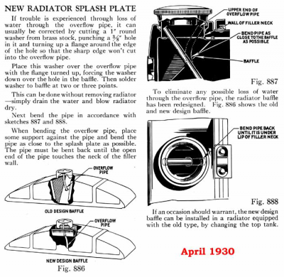

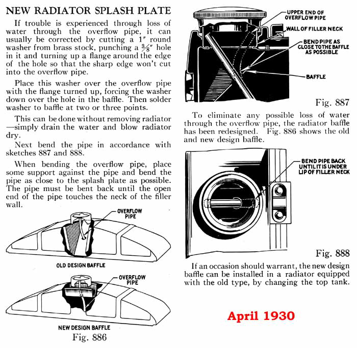

I don't see a baffle? Nice work.

Aha!

An interesting point in fitting the bottom outlet after the tank is fitted. My man always fits the outlet to the tank first, and then fits the unit to the core. He does it this way so there is less chance of the extra heat used on the cast outlet upsetting the work he would otherwise have already done if the tank was fitted first. I guess its all up to the individual craftsman. We have lost two locals, and now I have to drive 30 miles through the city to find anyone with the skills they used.
