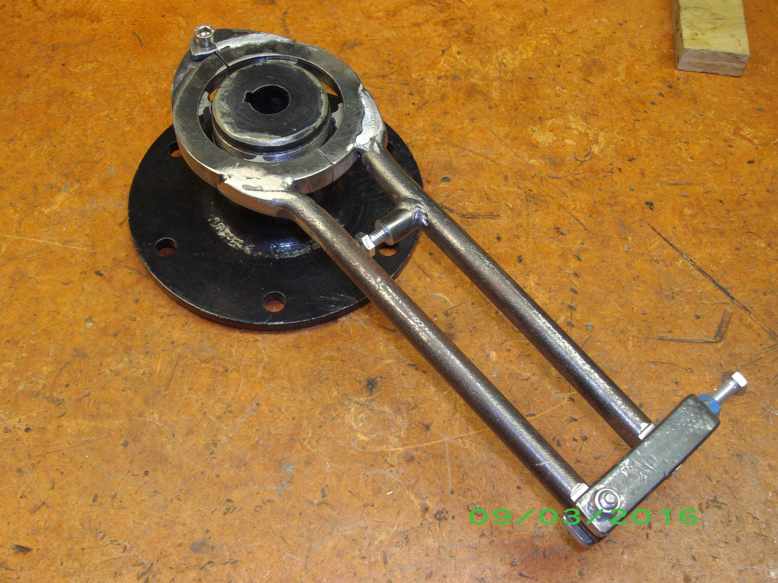

Re: Looking to Borrow a Hub Thread Repair Tool

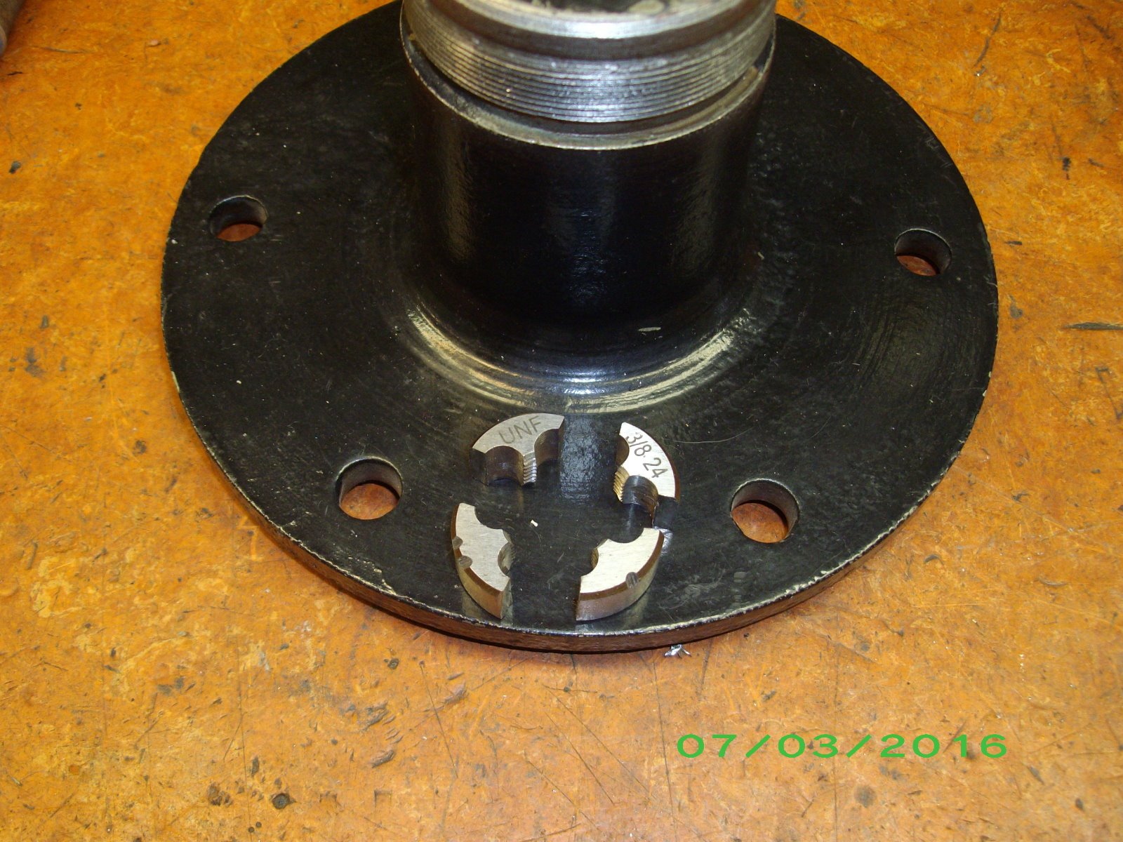

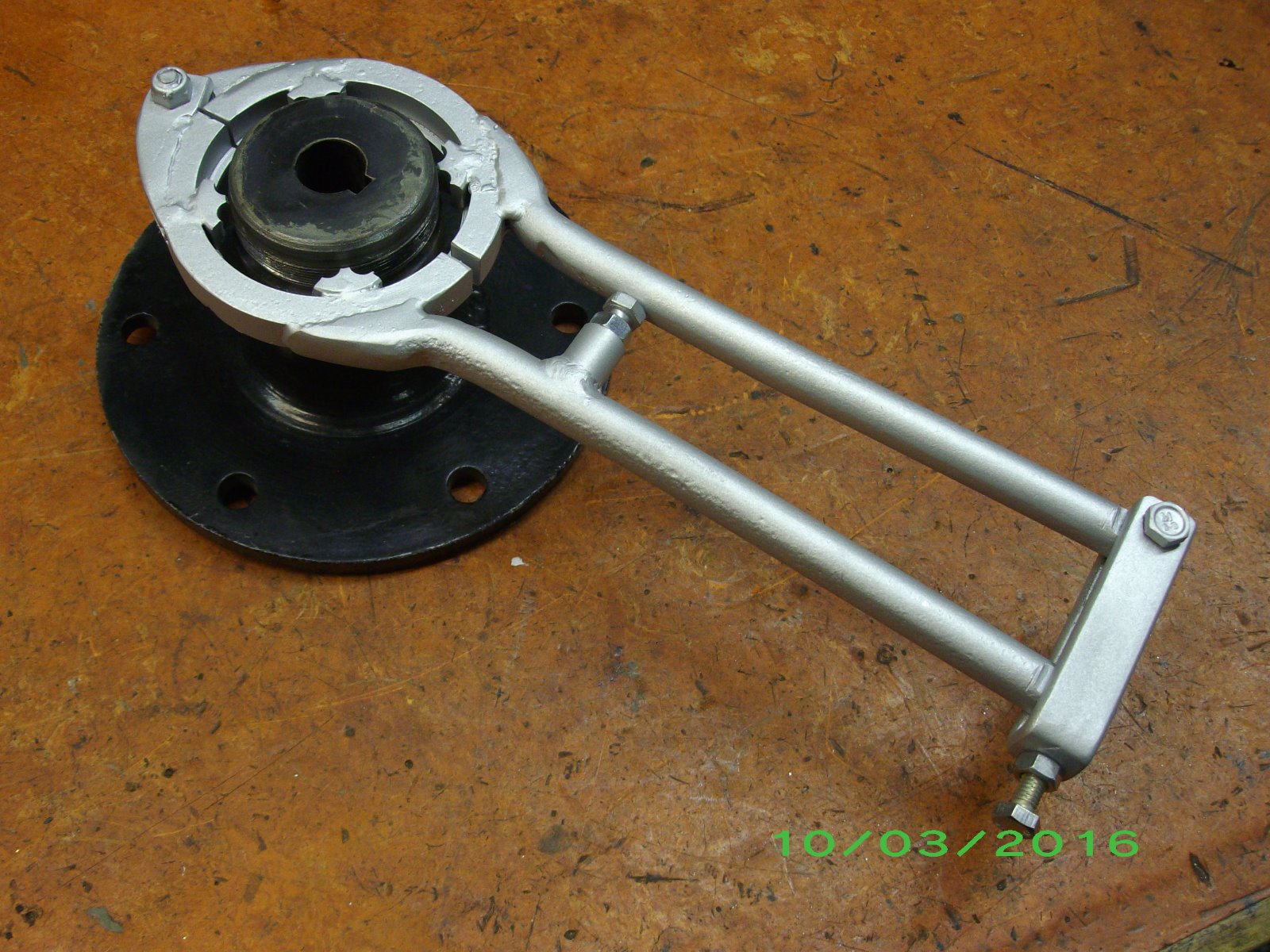

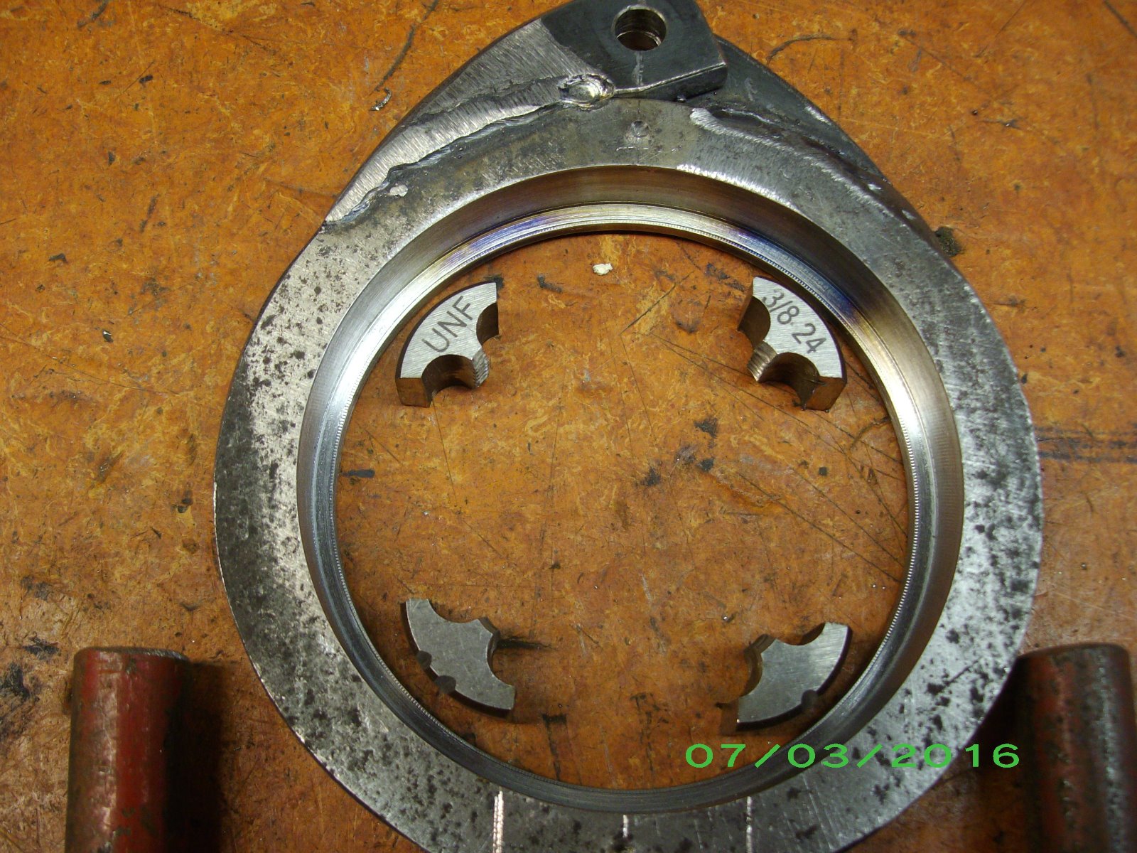

Eric ; As I could not find one here in Holland , I had to make one .
Greetings Toon
Greetings Toon

I had emailed Jack Putnam (yesterday) about potentially purchasing a repro one from him, but he has yet to get back to me. Might be a bit expensive for me anyway. I like the design that Anthonie posted in this thread, I might try to replicate it in the future if I have need again.

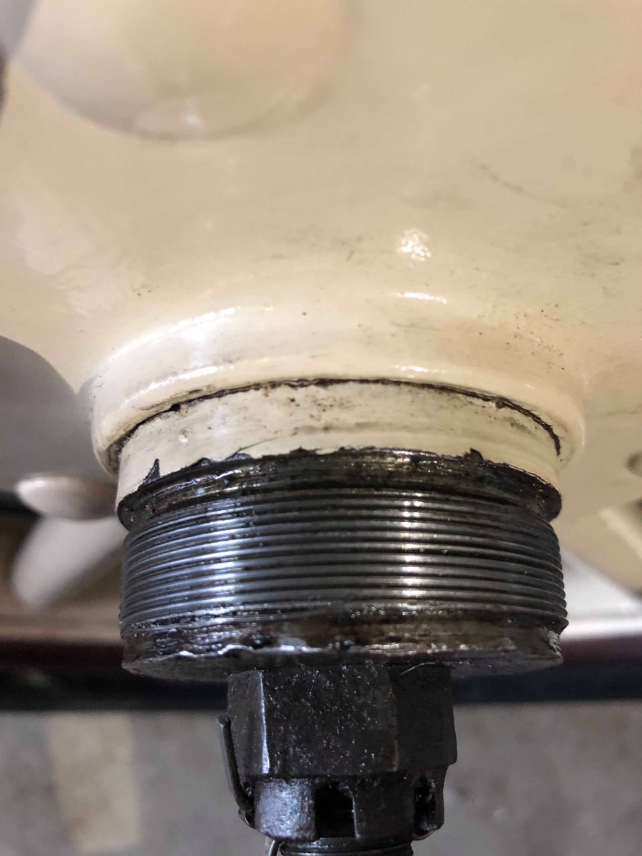

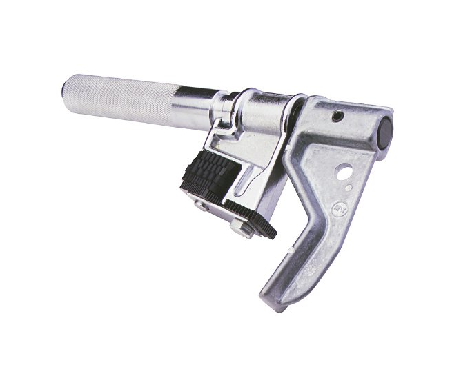

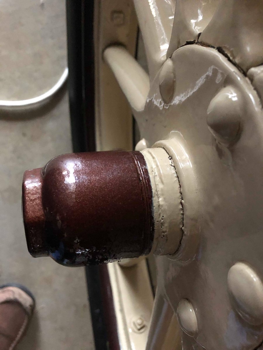

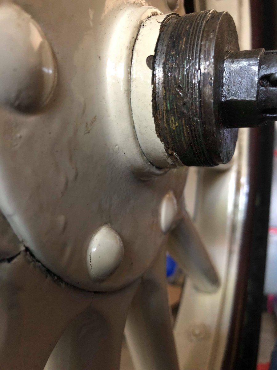

UPDATE (with pictures) for posterity purposes:
After attempting to use the hub thread chaser from Lang's (for about 6 hours total) in combination with plenty of oil and (eventually) an 18" wrench with little results other than some choice words and a bruised hand, I broke down and got an OTC Thread chaser, like that shown in the picture. Lang's chaser worked alright for one damaged hub, but the other was too far gone for the Lang's tool to work. This OTC chaser was about $70 on Amazon with same day delivery. Also commonly available at auto stores. After about 2 minutes with this OTC chaser (which required almost no effort at all), I was able to screw the hubcap all the way onto the hub using only my hand. I almost cannot believe how well it worked. The amount of grime and metal shavings that this tool was able to clean out of the threads is ridiculous. For anyone that might need this info in the future, simply select the right TPI die, attach it, oil up the hub, place the tool on and carefully thread it counter-clockwise (outwards from the wheel). It only took one sweep. A thread file is probably useful for cleaning up lingering burrs, but probably not necessary.
Pic of the thread chaser
Hub with painted over grime.
Bad gash in the worse-off hub. After thread filing and some scraping, before chasing.
Same bad gash after OTC tool. Not pretty, but the hubcap goes on all the way with no wrenching and that's good enough for me.
After OTC tool, other side.
Hank: I will send your Lang's chaser back to you tomorrow. Thanks again!
