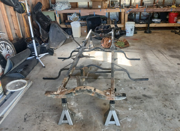

I've began the process, finally.
To build up, first, you must first tear down. We trailered the car down to where I wanted it. I spent a good part of this past weekend pulling the body off and getting it close to just the frame. I've been taking pictures, but probably not enough... (probably foreshadowing)
I did have to have a little fun driving the chassis around the yard before I tore it apart. It was kinda hard to get myself to tear the rad off and pull the car apart knowing it will be a while before I can do that again.
I'm hopefull the engine is sound, I got a few free starts with it even. I want to keep it mobile until I get my touring back and get the fordoor home again. This is all new to me so if anyone has any pointers, I'm all ears

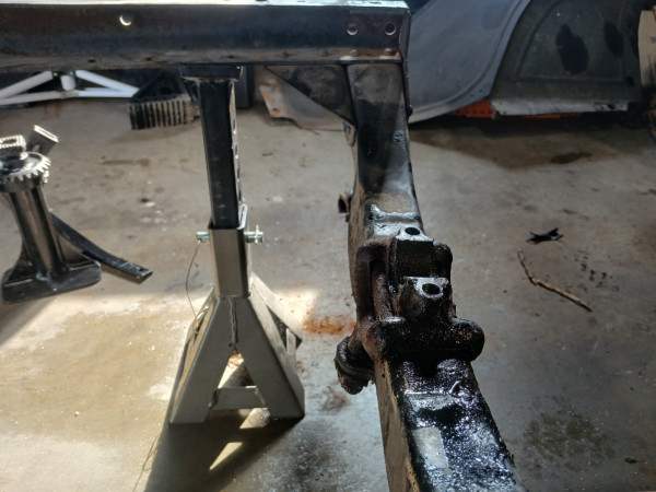

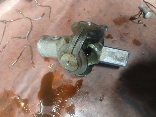

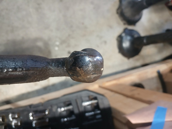

The past few weeks I've been able to make good progress on the car. I tore the car the rest of the way apart, down to the frame and clean the frame up with an angle grinder and a sanding pad. I removed both the front and rear axles and tore each apart to gauge what all parts I needed. I have began to put the rear end back together, and I'm waiting on parts for the front end. I also cleaned up all the spring leaves, surprisingly they were in nice shape, all things considered. What I found interesting was all of the Ford scripting I found on all of the leaves. Each leave had at least one Ford script, and the main rear leaf over the rear axle head not one, not two, but three scripts on one leaf!
Someone had been in the rear axle not too long ago and replaced all of the bearings in both the drive shaft and the axle itself. But what I found interesting was the fact that they had saved and reused the original Ford thrust washers, so it is a good thing I decided to tear it apart. I am now in the process of testing and installing new brass washers. Another thing I found interesting was that there was a lot of flash rusting inside the differential. It did have an adequate amount of modern gear oil in the back, so maybe this is more common with today's gear oil, than with the original really sticky Grease.
As far as the front axle goes I am going to replace the axle itself because both spring purchases are welded in place and are worn out completely. The pitman arm is going to be replaced as well because it is worn both on the ball and shaft end. A 'new' wishbone is going to be added as well, as the ball on the old one was pretty chewed up. The front crossmember was bent. I pounded it back the best I could. I had to cut the front engine mount/ spring Mount because the two nuts on the bottom were completely rusted and did not budge. Thankfully I have another mount to use. The frame almost completely stripped down. My one axle shaft was pretty pitted on the driver's side. Luckily I have a replacement that should work from another axle. Oroginal ford U joint with script
was in really good shape, all things considered, so it will be reused.

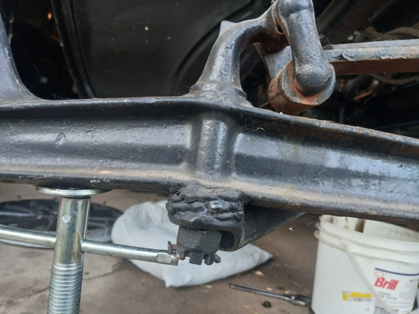

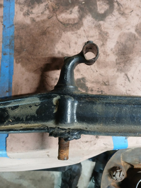

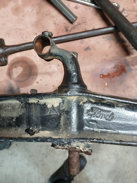

Someone decided to weld the wishbone to the bottom of the front axle and therefore locked the spring perches in for life. I won't scrap the axle, but it will be a project for another day. As you can see, one of the perches is extremely worn, I elected to buy two new spring perches, I figure these parts take a lot of stress and load, I want them to be in good shape.

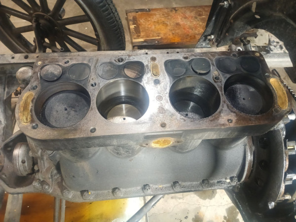

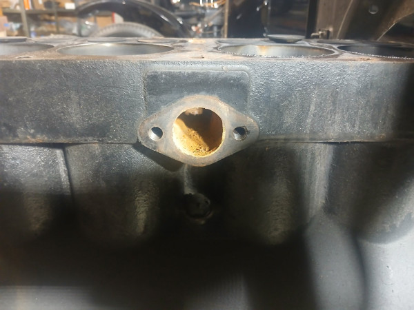

Thanks, Steve. It's funny you mention that because my engine block is actually a replacement 26-27 without any number stamped in it.Steve Jelf wrote: ↑Thu Oct 23, 2025 12:42 pmThe hinges on your touring body say 1925. I expect the engine serial number will indicate 1924 after August 1.
https://dauntlessgeezer.com/DG90.html
I don't have pictures at the moment, but most of the structure in the forward cowl section of the body is still wood, with the exception of the floor board risers which are steel. A lot of the 25s to my knowledge are mostly steel in the front.

A block with no name.
