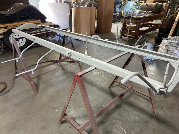

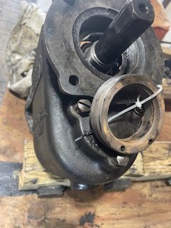

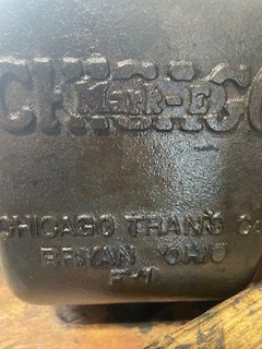

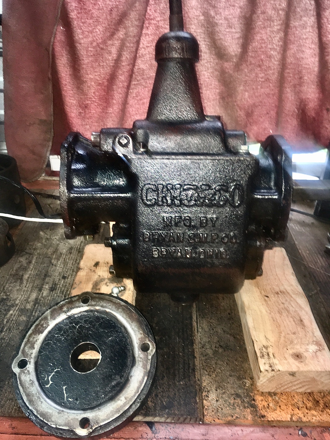

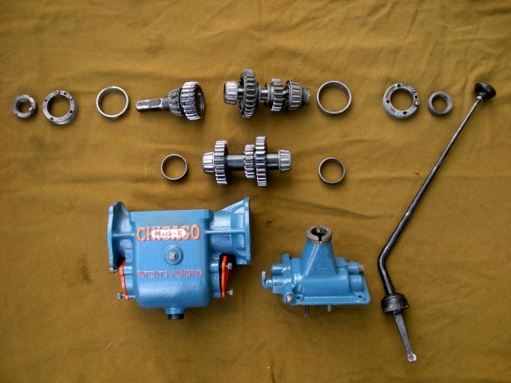

Looking for information pertaining to the Chicago Mark-E Auxiliary transmission.
What I am looking for
Literature on installation
Original sales ads and the like
Part sources, part numbers
Rebuild specifications/tolerances
Information on manufacturing dates

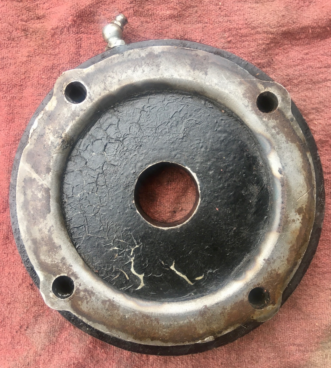

Information on the round disk with the grease zerk pictured below.
And any other interesting things we can come up with.

This one doesn’t have the patent pending on it.
Says FO-1
hopefully an Obtainable model.

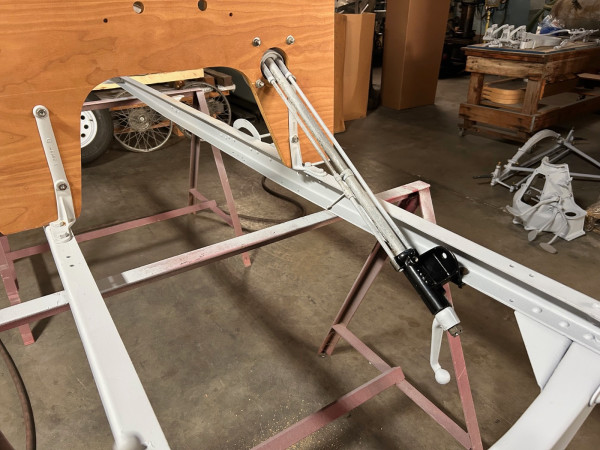

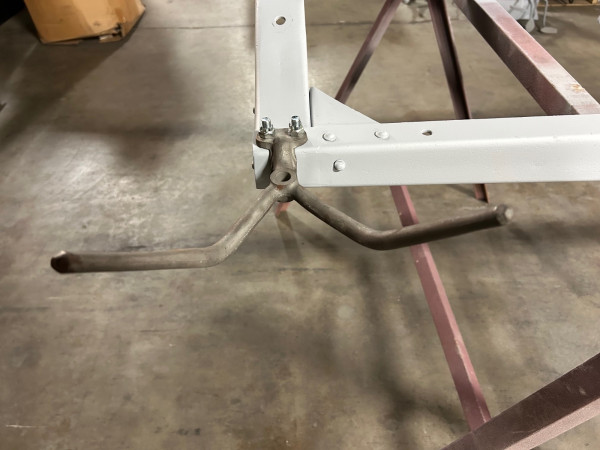

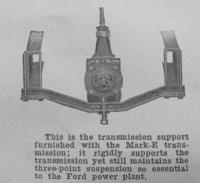

Also looking for a source for a transmission mount/brace. It probably wouldn’t be to much different than a Warford set up. Or any pictures of such a thing.
Bryant
Posts: 4081
Re: Chicago Mark-E Aux Transmission
Post by DanTreace » Sat Jul 05, 2025 9:35 am
This older post has pics of the bracket.
https://share.google/WOg6e4p3l45PrG8Wv

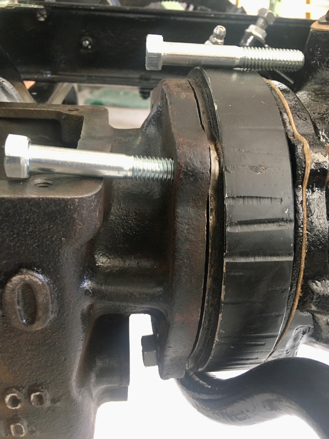

Post by Bryant » Sat Jul 05, 2025 7:24 pm

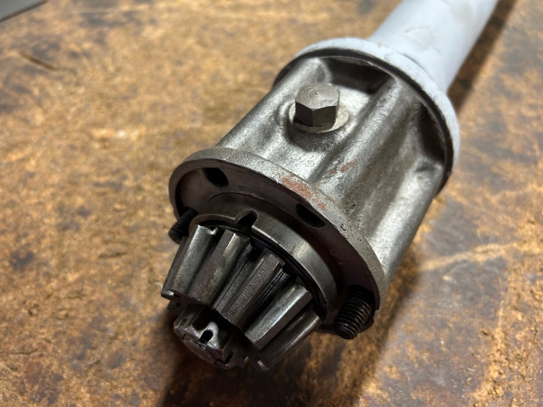

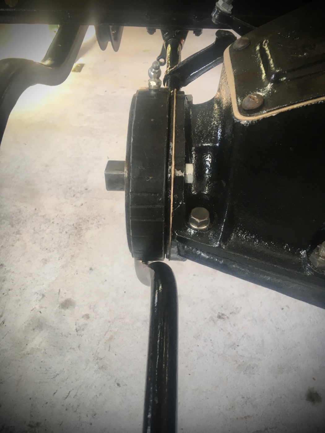

Putting the round disk in place I realized it’s purpose. Giving just enough spacing so the brake equalizer doesn’t hit the transmission. Pump it full of grease for an oil seal.
Bryant
Posts: 5539
Last Name: Gregush
Location: Portland Or
Post by Mark Gregush » Sun Jul 06, 2025 11:01 am
There are work arounds that eliminate that spacer by making your own equalizer. I have made a couple like shown in the link. Instead of the round rod with brake levers attached at each end, I just used flat bar with ends folded down. These allow the U part to be extended down to give more clearance for the transmission. I have not calculated the force applied but seem to work.
https://www.mtfca.com/discus/messages/3 ... 1384711491

I actually like the simplicity of the spacer. However to get it installed I believe it will require studs. The through bolts would need to be to long to be able to get them to fit into the holes.
Bryant

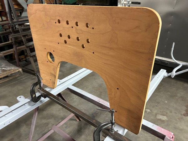

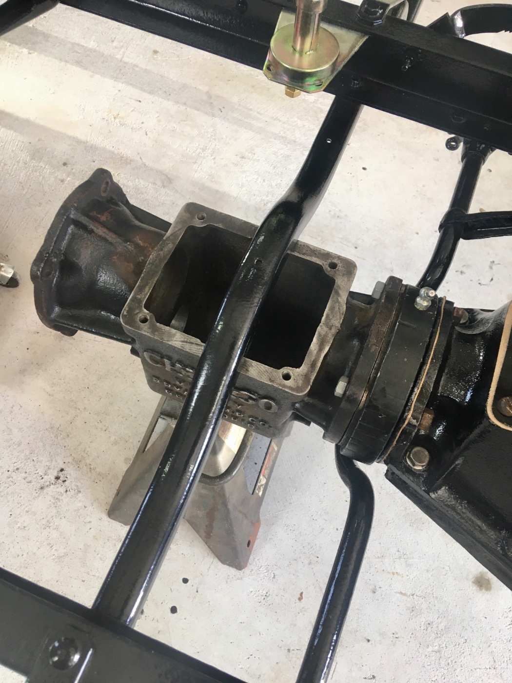

Now for another issue…..

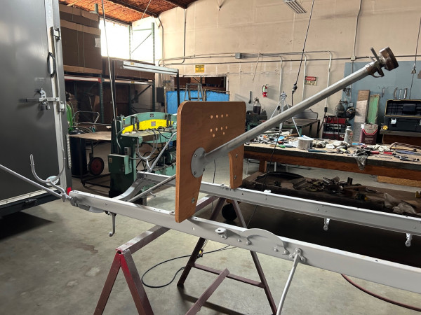

the running board brace is now in the way. Is this normal for Aux transmission installations? I just love a challenge.
It’s a 26 Tudor
Bryant

Post by DanTreace » Sun Jul 06, 2025 2:11 pm
Yes. Cutting the front running board channel is a must for these trans.
This older post has a great write up on install of several types, but not the Mark E
https://share.google/pQHtf6DScZ85zGlzd

Post by Bryant » Sun Jul 06, 2025 2:35 pm
Thanks again Dan! I guess I will sacrifice the part. :( But looking at the piece that is cut out I see a possibility to re-purpose it for a trans mount. It’s got that shape to it.
Thinking….

Post by DanTreace » Sun Jul 06, 2025 10:51 pm

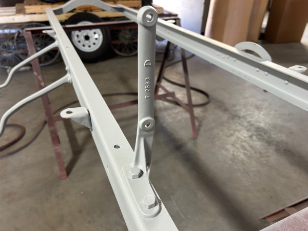

Located an image of the Mark E support brace. Likely for the TT, but gives the idea of design.
Bryant

Post by Bryant » Mon Jul 07, 2025 9:10 am
What a beauty! Where did that come from?
And is there more?

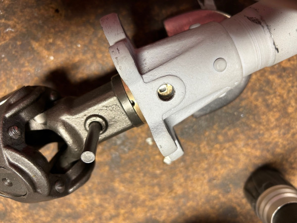

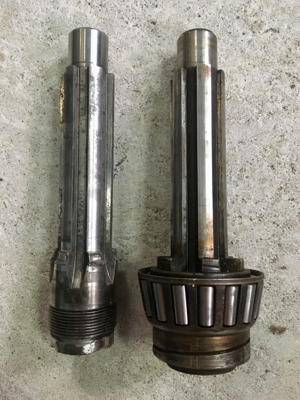

Post by Bryant » Mon Jul 07, 2025 2:51 pm
main input shaft. Zoom in for details! she has seen better days. Sad but true this hobby sometimes.
Looking for one in the classifieds but also talked to a friend of mine that’s a retired machinist.
He said “ I can make that”
A glimpse of hope

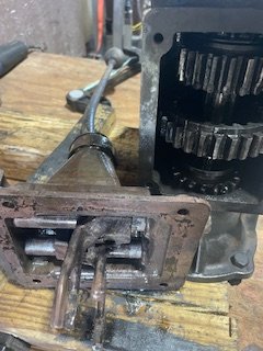

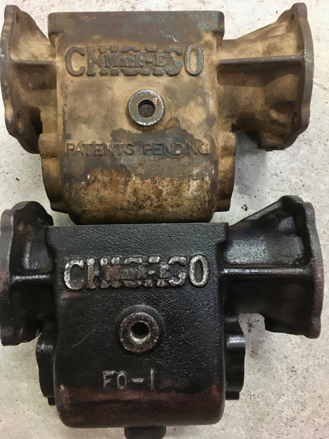

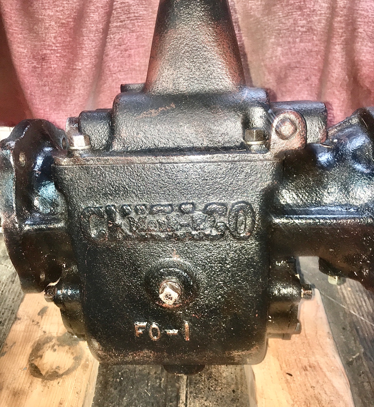

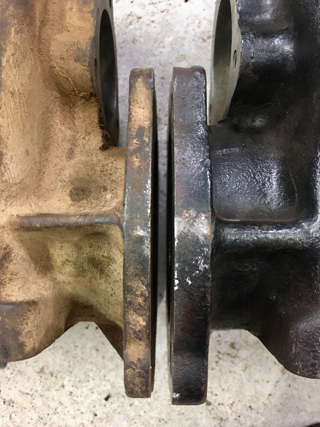

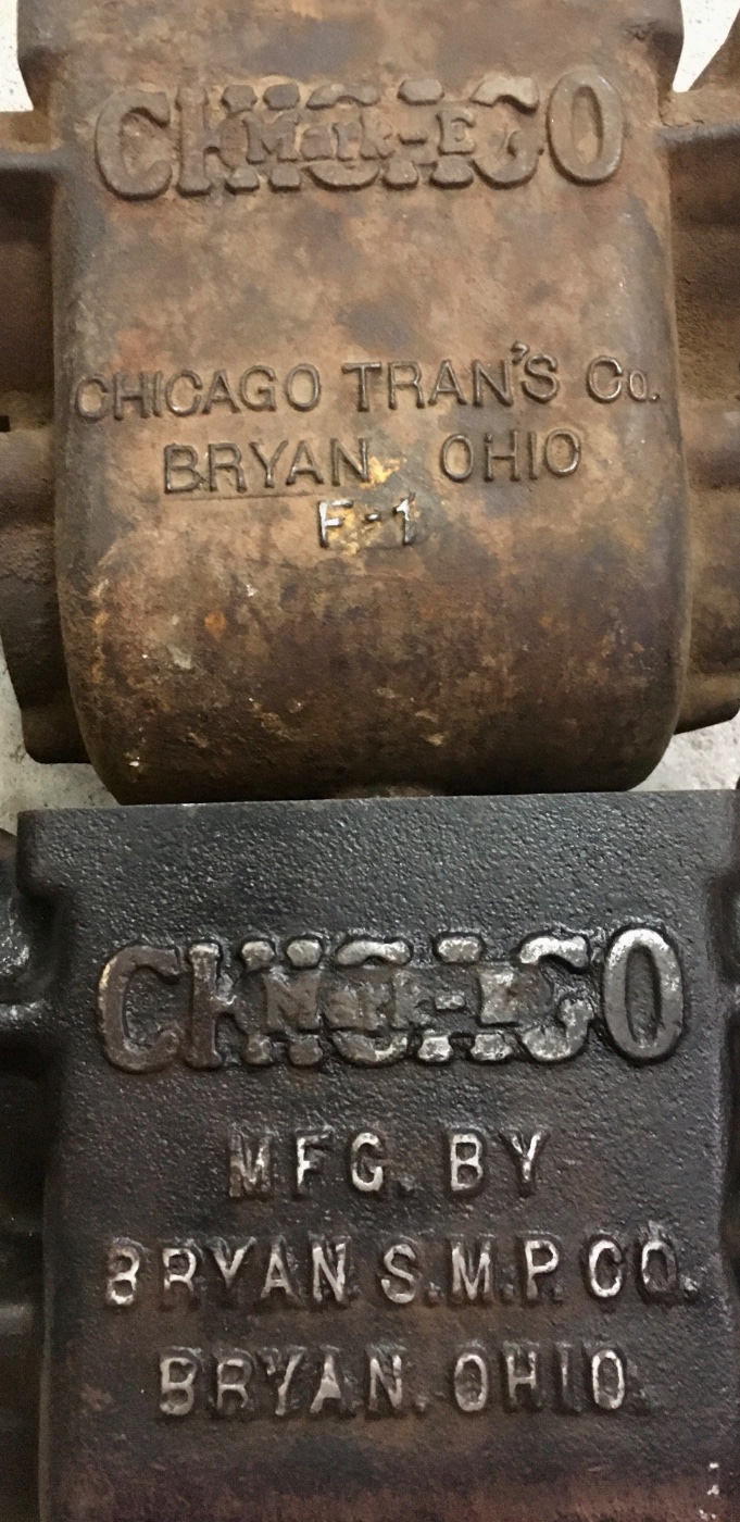

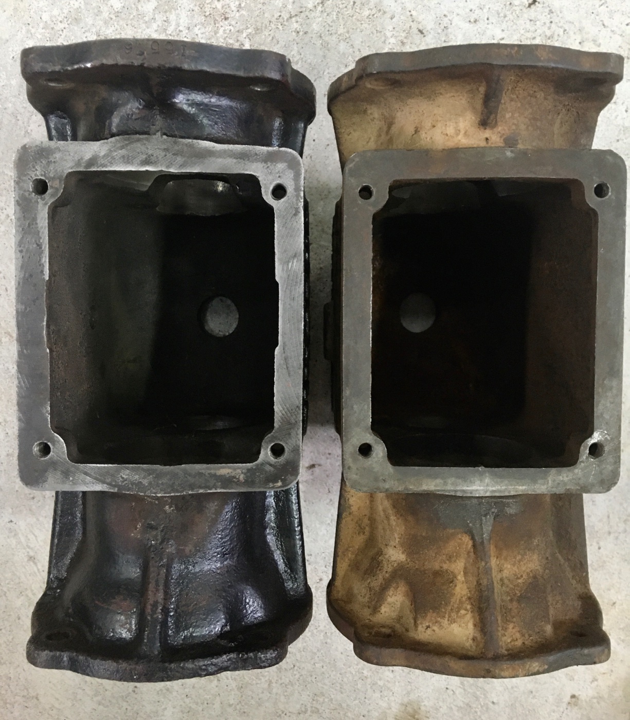

Received another chicago to try to build one out of two.
Some Notable differences. The black case is the F0-1 case and the rust colored one is the Patent’s pending F-1 case.
Bryant
Posts: 1216
First Name: Bryant
Last Name: Shafer
Location: Myersville Maryland
Post by Bryant » Fri Aug 01, 2025 9:13 am
The F0-1 case seems to be more robust. The input flange is thicker, the webbings thicker.
Bryant
Posts: 1216
First Name: Bryant
Last Name: Shafer

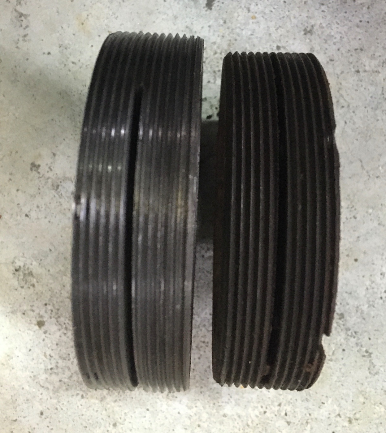

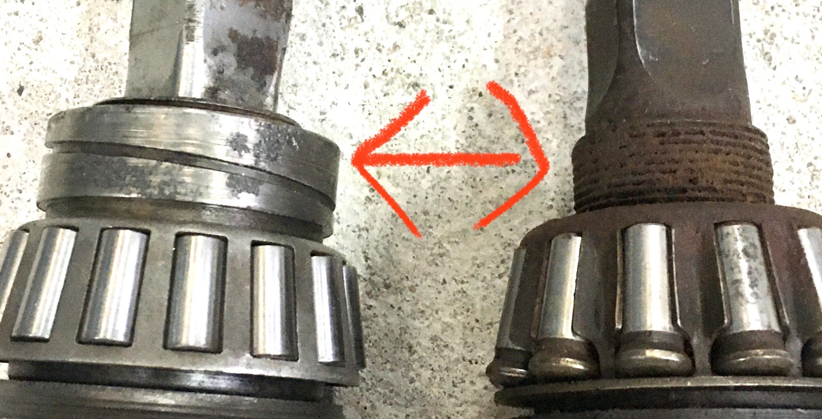

Post by Bryant » Fri Aug 01, 2025 9:19 am
The input bore on the F-1 case is a smaller diameter. This makes the preload collars different diameters and the input shaft bearing is taller but not as wide.
Bryant

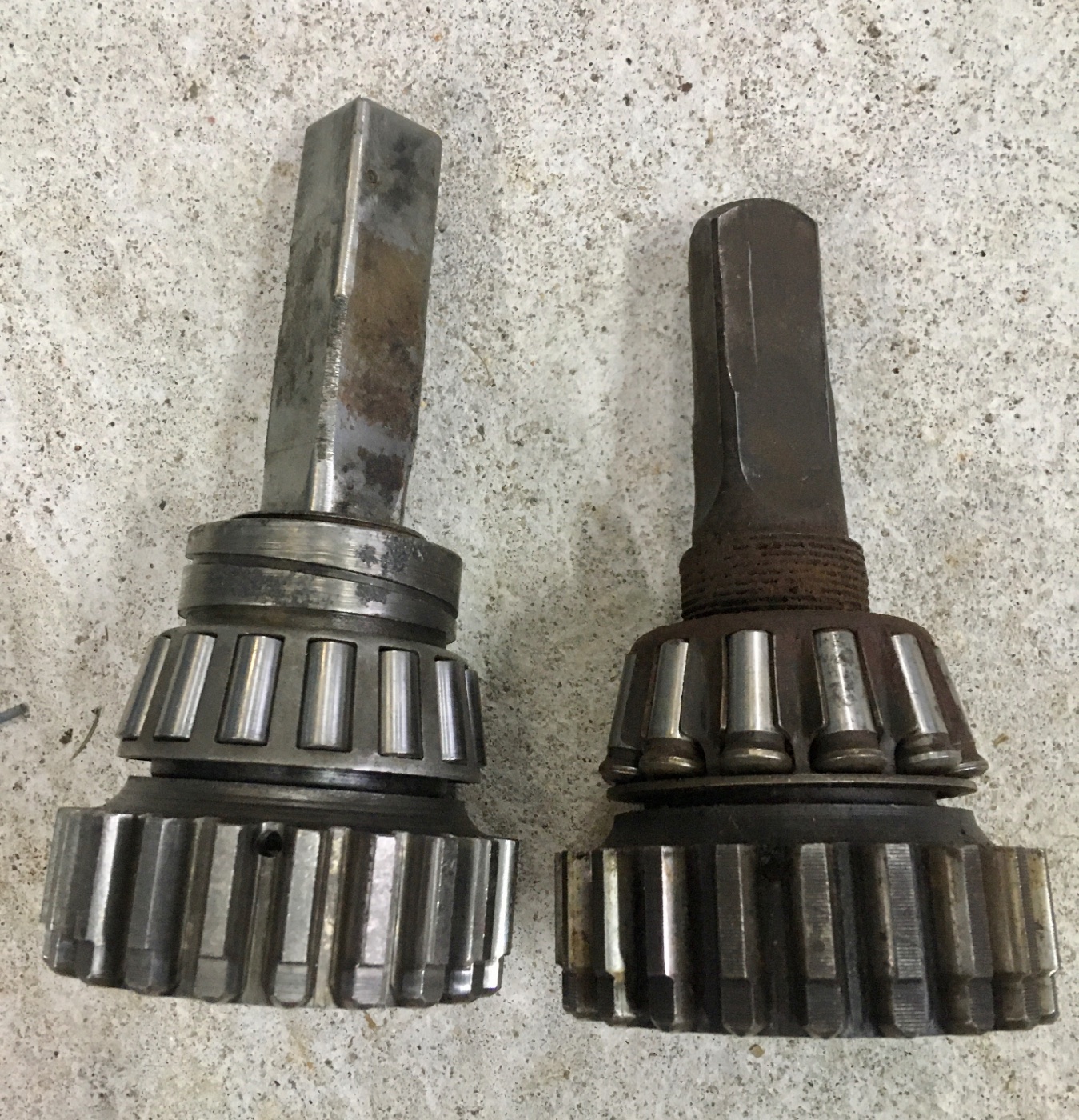

Post by Bryant » Fri Aug 01, 2025 9:27 am

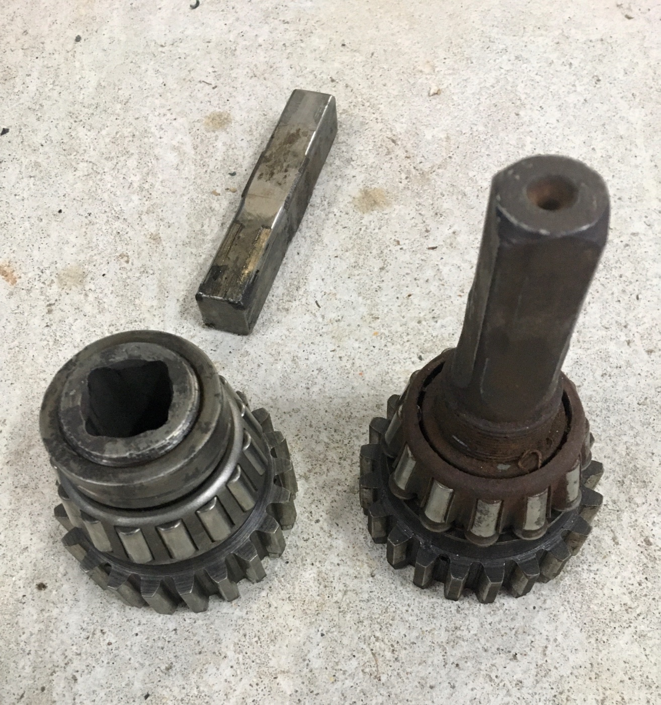

The input shaft difference
F0-1 case has a removable input shaft that is about an inch longer to accommodate for the trans spacer. The bearing retainer that screws on to secure the bearing has a larger diameter due to the preload screws diameter difference. Then there is the bearing size difference.
I haven’t seen anything else that has stood out after that. Lot of good gears in the F-1 case so Iam happy to start getting this thing assembled.

Post by Bryant » Fri Aug 01, 2025 12:33 pm
this logo appears on gears and shafts all over. Anyone recognize the logo?
I see letters F,I,G,H,C,T maybe…
Bryant
Posts: 6577
Post by TRDxB2 » Fri Aug 01, 2025 2:02 pm
In case you didn't get to this link https://www.mtfca.com/discus/messages/3 ... 1385651181

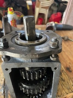

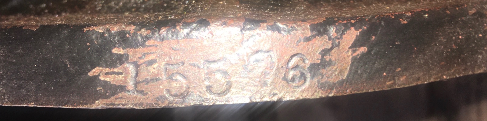

Post by Dave Foley » Sun Aug 03, 2025 1:53 pm
Thank you for all the information and discussion on the Chicago transmission F1 and others , i have a Chicago F1 i got with a pile of parts and the discussion prompted me to clean it up and am also looking for a part, a inner bearing retainer preload for main shaft . see below in pictures ill put it in the classifieds WTB. Does anyone have any detail on assembly preload and how to set up these? how does the center retainer work? and how would you get it off the shaft? I have left the transmission assembled so i don't hurt something
The transmission was well protected by ancient grease and bearings and gears appear in good shape with shifter and knob.
i wanted to share the crossmember bolt and spring mine came with, as well as stamped number on transmission, I appreciate all the information shared
learning every day, sorry about picture orientation Thanks Dave
chicago F1 side view.jpg (30.68 KiB) Viewed 2502 times
f 1 missing inner bearing retainer wih outer shown.jpg (32.26 KiB) Viewed 2502 times
f 1 stamping 10100 on edge.jpg (90.76 KiB) Viewed 2502 times

Post by Bryant » Sun Aug 03, 2025 11:07 pm
it simple threads on. It was standard direction thread. The F-1 case has a smaller input preload collar that the F0-1 so the bearing retainer will have to match its ID. A machinist could easily make this collar knowing your two measurements. (Threads and preload collar ID) my donor trans unfortunately did not have this part intact. Preload tolerances are still a mystery to me so if anyone has the information please let us know.
