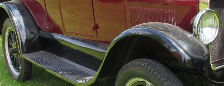

My problem is more concerning than using the block kit sold by the vendors The previous partial restoration (30 years ago an old gentleman partially restored the car with the exception of the interior to the best of his ability) included a 2X6 piece of lumber between frame mounts and body mounts the length of the car to bolster the body. Now that I have the car I want to finish the restoration. It needs a complete steering column. Is this 2 inches lift going to adversely affect the angle of the column and the clamping in the dashboard?

John, no, a 2" lift will not work. The steering column will be the wrong angle, the pedals and hand brake will not have proper throw, the starter switch will dissapear, the hood and radiator will not align with the body, there will be a 2" gap between the splash shield and body...children will laugh and women will faint at the sight...no it will not be workable.

John
Jeff may be correct depending on how the rebuild to the body was done.
Can only visualize why a length of 2x6 wood was placed on the frame unless the touring body was in total rusted shape of the metal subframe that holds the body panels. Or perhaps the lower body metal was rusted and then folded under the replacement wood structure?
Can’t really tell from the photo but appears to me the lower body is too close to the splash shield, the doors don’t seem to have much sheet metal under the openings.
Normal appearance.
