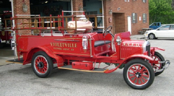

Here is a slightly fuzzy blow up of the only one I have ever found and it was on this early Fire Truck.
J1MGOLDEN
Topic author - Posts: 1308
- Last Name: Golden
- Location: Bowie, MD
Re: Needed - A Rim Identification
The Fire Truck.

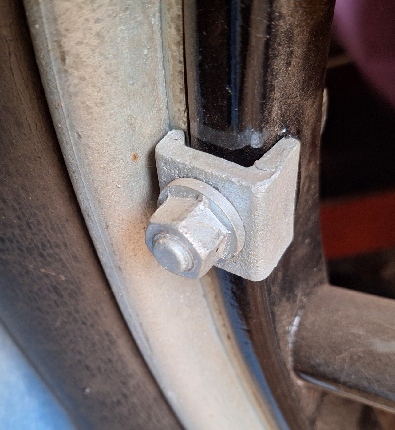

John has it nailed. Our Canadian sourced cars had loose lug rims up until 1925. Ours are Kelsey. The rim will have a bridging lug which goes over the bolt nearest the valve stem. It is there to stop the rim migrating around the felloe if the lugs get loose. The lugs may have Kelsey stamped on them , or 88, or nothing at all. We have two styles of rims. One has a rolled in groove around the rim to engage on the felloe outer land. This type will have a slot cut into that rolled land on which the foot of the lug rests. The slots allow water into the rim. The better type have a continuous steel land around the rim, the rim having a flat base. This land engages on the felloe and the lug engages on the band.
Hope this helps,

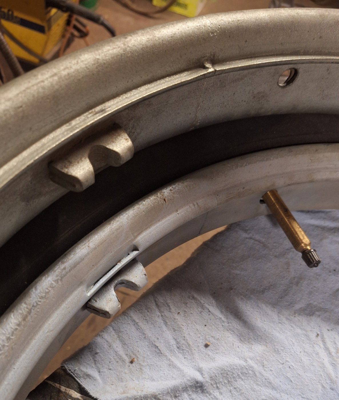

These photos show the two different types of rims, and the mounting hardware.
The rim with tyre fitted has the rolled in groove. You can see the relief cut in the groove to accept the foot on the lug. Water can get into the rim through the cut in the groove, helping rust. At the same time, the lug has less material to sit on.and this accelerates wear at that point.
The second rim shows the continuous land around the rim on which the lug engages. No perforation of the rim and a wider land for the lug foot means less wear. A bonus is a weld repair on this type of rim is much easier.
The second photo shows the mounting hardware. Langs have CNC machined replacement lugs and the special nuts with built in washers on them. Allan from down under.
