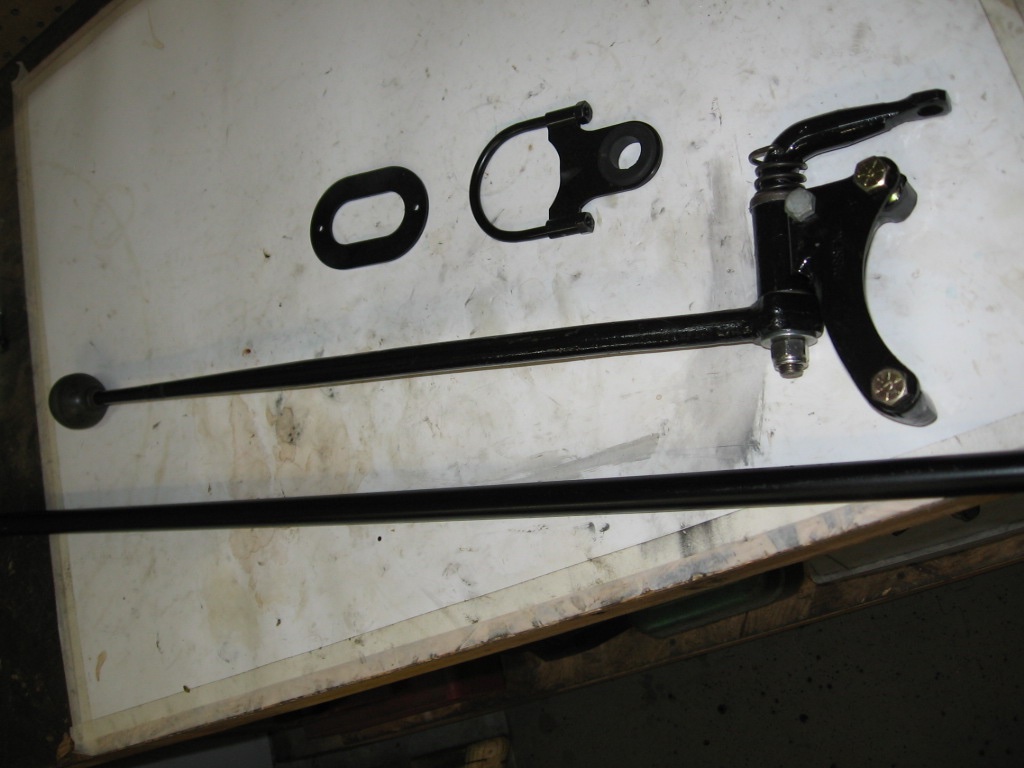

You described one fix, add some locking nuts. And be sure you have installed the P206, that support helps prevent bending of the rod, and helps reduce rattles too.
Original rod were two piece, and the connector was a solid bar cylinder, fitted into each end, and riveted to each tube end, provides a solid connection and tough to bend.
Shift tube support .JPG (49.44 KiB) Viewed 5366 times

Hmmm, can't edit. Don't worry Dan, I found it - thanks. Can I use this even though the lever is on the left?
Posts: 4082
Re: Ruckstell push/pull rod question
Post by DanTreace » Sun Jun 30, 2019 3:19 pm
That shift support , P-206, can be positioned anywhere around the torque tube. Just a C-clamp with a rubber grommet, I like to add some silicone paste lube to the grommet for easy sliding of the metal tube.

When I did the Ruckstell in my 1915 the shift rod and support bracket were missing. Generally now-a-days guys use metal conduit for the shift rod. But since I did not have the support bracket, I made made out of 1/2" black iron pipe. That sucker does not flex!

The rod I got from Chaffins is one solid rod with an adjustable clevis on one end. You can adjust it so the lever is just where you want it and so it doesn't interfere with anything else. That clamp on bracket will also help to keep your rod from flexing. Those can be bought from the suppliers too.

The late original Ruckstell shift levers are splined. These are problem Eaton. They can be adjusted anywhere you want them. I would never use the floorboard plate that Dan Posted. Ruckstell never made them. You only need a hole that's big enough for the shift lever.
