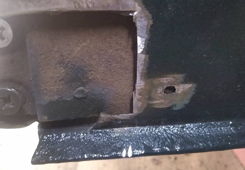

Upon repairing the Coupe passenger door, i noticed what looks like two spot welds.
The outer green skin had two round holes which I figured were just rust holes but when I removed the really bad part, I found that the inner structure had separated from the skin. So, I was wondering, "Did Henry start using spot welds late in T production?" Then I remembered that the driver door came from a Model T donor but the passenger door came from a Model A truck. Perhaps someone else knows.

Thanks for the responses. I fixed it with three plug welds.

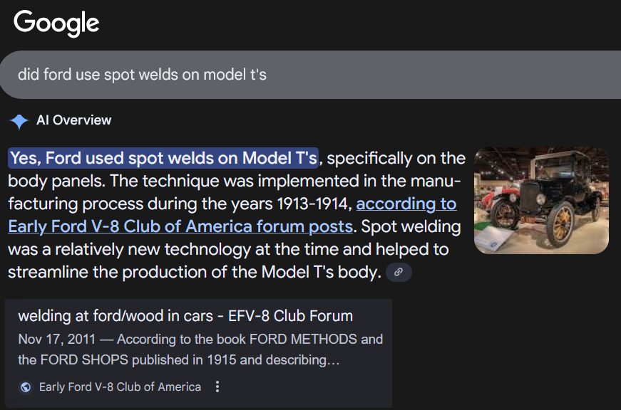

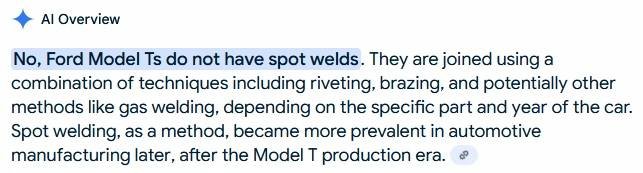

But you're gonna luv what A.I. has to say:

"AI" equals automated incompetence or automated idiocy. Google was always questionable in its quick answers, however, in the past year they have become laughably unreliable.
Yeah, Henry used electrical spot welding going way back.

The AI output in search engines is nothing more than a machine generated summary of the target subject collected from various data sources across the web. Despite the name, or presumption, there is no intelligence, there is no proofing, it merely is garbage in garbage out...it just does it faster.
The old adage of not believing everything you read on the web still holds true, regardless of anyone trying to convince you the "I" in AI is actually operative....
