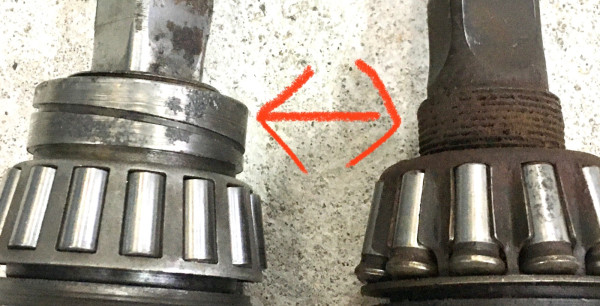

The input bore on the F-1 case is a smaller diameter. This makes the preload collars different diameters and the input shaft bearing is taller but not as wide.
Bryant
Topic author - Posts: 1214
- First Name: Bryant
- Last Name: Shafer
Re: Chicago Mark-E Aux Transmission
The input shaft difference
F0-1 case has a removable input shaft that is about an inch longer to accommodate for the trans spacer. The bearing retainer that screws on to secure the bearing has a larger diameter due to the preload screws diameter difference. Then there is the bearing size difference. I haven’t seen anything else that has stood out after that. Lot of good gears in the F-1 case so Iam happy to start getting this thing assembled.

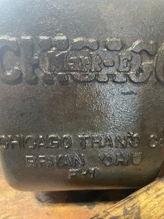

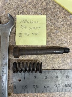

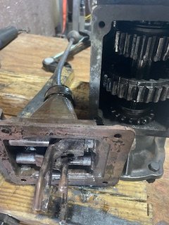

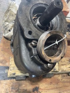

Thank you for all the information and discussion on the Chicago transmission F1 and others , i have a Chicago F1 i got with a pile of parts and the discussion prompted me to clean it up and am also looking for a part, a inner bearing retainer preload for main shaft . see below in pictures ill put it in the classifieds WTB. Does anyone have any detail on assembly preload and how to set up these? how does the center retainer work? and how would you get it off the shaft? I have left the transmission assembled so i don't hurt something
The transmission was well protected by ancient grease and bearings and gears appear in good shape with shifter and knob.
i wanted to share the crossmember bolt and spring mine came with, as well as stamped number on transmission, I appreciate all the information shared
learning every day, sorry about picture orientation Thanks Dave

it simple threads on. It was standard direction thread. The F-1 case has a smaller input preload collar that the F0-1 so the bearing retainer will have to match its ID. A machinist could easily make this collar knowing your two measurements. (Threads and preload collar ID) my donor trans unfortunately did not have this part intact. Preload tolerances are still a mystery to me so if anyone has the information please let us know.
