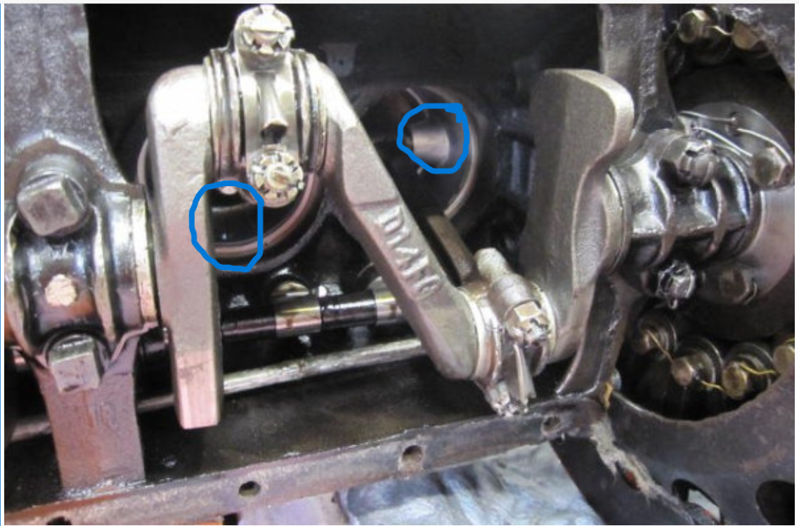

Can anyone identify this crankshaft
This crankshaft is in a 1927 block I want to rebuild. 14,719,XXX
I have an EE crankshaft I was going to use. But I’m curious if the crankshaft currently in the block would be a good choice to use?
Can anyone ID it. Thanks for any information you might have on it.

Re: Can anyone identify this crankshaft
Looks like a Sure Mike. (spelling ?)
- Posts: 5083
Yes, that's a "sure break" crank.

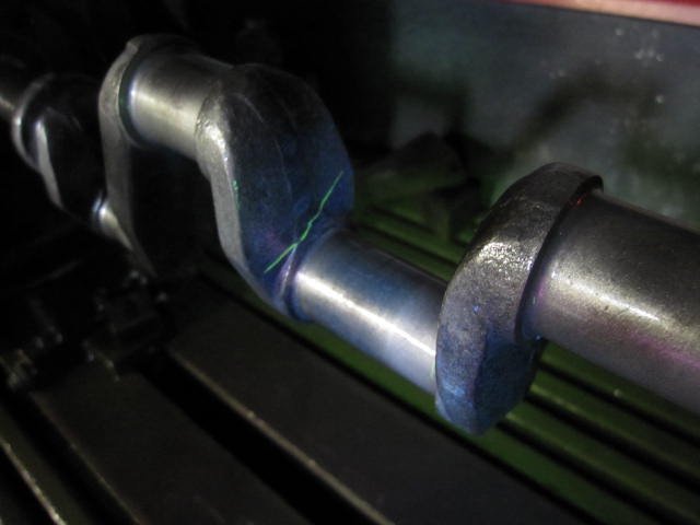

There's no need to have the crank "dye penetrant tested" if you are to have the crankshaft wet magnafluxed.John Codman wrote: ↑Thu Aug 07, 2025 9:51 amI would have the crankshaft in the OP cleaned, dye penetrant tested, and magnafluxed before I would put it into an engine.
Wet magnaflux as I have shown in bottom picture will work better than the dye penetrant and is faster more reliable.

Funny that you should say that.Dan McEachern wrote: ↑Thu Aug 07, 2025 4:26 pmHang 'em on a string and tap them with a hammer..............
Standing in front of my magnaflux machine with the local T club present on tour of our facility, explaining what the magnaflux machine does.
I asked the club members how they check their cranks prior to rebuild as the other machine shop rebuilder was present .
They chimed in unison; "We hit it with a hammer and it'll ring" !
I did the same procedure with hammer in hand and our crank also rang like a bell. I placed it in the magnaflux machine and their mouths hit the floor as in this picture is what they saw. !
Just because it's an ABC, DB or even EE crank they all need to be magnafluxed. Just because it's EE doesn't make it unbreakable.

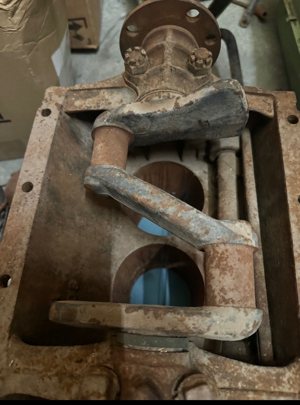

I think there are 2 different counter balanced crank made in the day. Sure Mike's have a bad reputation, the other 1 is very durable. I don't know how to tell the difference, but I have 1 that was on a originally on a overhead stick, that I now have on a OHV. It has suffered much abuse from me, and previous owners.
- Posts: 8341
Running an engine hard with a very light flywheel might allow destructive high frequency torsional vibration at some speeds.
ModelTWoods
- Posts: 1548
- First Name: Terry
- Last Name: Woods
Steve, there have been many forum posts on Sure Mike crankshafts over the years. One of them I read, said that there were two different series of Sure Mikes, made: Sure Break and May Break (just kidding). Maybe Sure Mike realized they had a problem with the early cranks and, later in production, changed the metallurgy of their cranks to be more durable.got10carz wrote: ↑Thu Aug 07, 2025 8:13 pmI think there are 2 different counter balanced crank made in the day. Sure Mike's have a bad reputation, the other 1 is very durable. I don't know how to tell the difference, but I have 1 that was on a originally on a overhead stick, that I now have on a OHV. It has suffered much abuse from me, and previous owners.
- Posts: 4384
Of those two styles, I believe one appears to be heavier and more robust. One of each is shown in the various pictures, above.ModelTWoods wrote: ↑Thu Aug 07, 2025 10:53 pmSteve, there have been many forum posts on Sure Mike crankshafts over the years. One of them I read, said that there were two different series of Sure Mikes, made: Sure Break and May Break (just kidding). Maybe Sure Mike realized they had a problem with the early cranks and, later in production, changed the metallurgy of their cranks to be more durable.got10carz wrote: ↑Thu Aug 07, 2025 8:13 pmI think there are 2 different counter balanced crank made in the day. Sure Mike's have a bad reputation, the other 1 is very durable. I don't know how to tell the difference, but I have 1 that was on a originally on a overhead stick, that I now have on a OHV. It has suffered much abuse from me, and previous owners.
