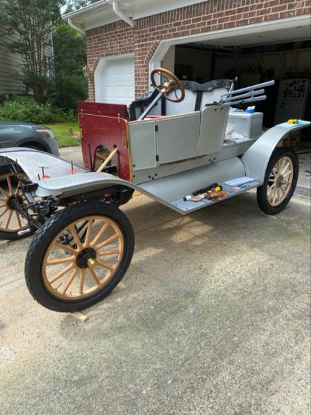

"Asking for a friend" If a fellow was to find an all original 13 runabout actual barn find what would you think the body would be worth? It has a little rust through in one corner but the wood and everything else seems solid. I'm trying to work a deal and It's taken apart. I will probably part it out. What do you guys think?

"All original barn find" . . . But it's taken apart ? That is, it's a pile of wood and tin with some rust-out. Pictures would help, as usual, it's worth whatever someone is willing to pay for it. Is the turtle deck with it ?
I'm intrigued, one source claims there were no more than 1400 or so runabout bodied Ts sold for 1913, but there seem to be a lot of survivors for that low production number. I own one.

notice the shelf in the back ground and the frame behind it. It was the same story, Old man found it, wanted to restore it and died. It's all there.

I’m no expert, but it looks earlier than a ‘13 to me.

That looks more like a '12 Torpedo body !

Serial number comes back to June 13

That is not a 13 runabout, it is a torpedo with a later turtle deck added. Great find!

What do you say Rich since you have one?

Good guesses from the previous posts. The body is definitely not a '13 runabout, the turtle deck is a '14-'21 style with rounded corners.
Looks like a good, restorable body, it would be a shame to part it out. I have a little nagging feeling it might not even be Ford - comparisons with a '12 torpedo are in order. Thanks for showing it to us !!

Neither '11 or '12, nor Ford (with the exception of the turtle deck)
Rich is on the right path...
Regardless, SOMEONE is going to recognize it, and when the word gets out, SOMEONE is going to want it...

Re: 1913 runabout body
The dash and lower platform certainly look like a Ford. Could it be a prototype, '12-'13 transition or from some odd body maker? It definitely looks very old.

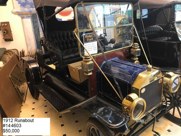

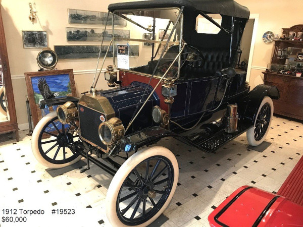

Just some views to compare with the '11 and '12 Torpedo.

1912-13 torpedo roadster, we used them here in NZ as a commercial roadster in 1913 sold new. Photo of my T as restored from an original

It's definitely model T, as body chassis bracket bolts say it all, just slightly different with curve in bottom of door, bolts at top of quarter panels are possibly for windshield support like mine. Just a thought

Not sure what the OP body is? Could be as simple as one of the odd body suppliers made a few with that odd curve at the bottom of the door? Or? Not an open roadster with after-market doors, the open roadster's seat has a rounded top corner whereas this body has a straight and square front edge as most 1912 torpedo roadsters had. I just looked at about twenty era photos. These three showed the side of the seat and door best.

First, the door on the original post looks to be too tall for any torpedo. Second, there is no such thing as a '13 Torpedo either. Just '11 and '12, biggest difference in the '12 is the longer runningboard, and that they moved the seat a bit so people could REACH the pedals!!

I'm going to find out, I just made the deal. I'll post more pictures when I get it home.

That needs put together, not parted out.

What fun !! This is really intriguing. Thanks for the pictures, everyone. More pix of the mystery body show it definitely mated with a Ford chassis. The irons laid back at the "A pillar" position speak of a 1913 type windshield. Any road, it's not in the pattern of the "standard issue" 1912 torpedo. Could another maker have produced a body that similar ? Any clues to its provenance ? Could the original owner have bought a bare chassis and commissioned a local coach maker to "build something like this, but with . . . etc." And showed him a Ford brochure ?
If it were mine, I'd restore it how it presents, but lose the later turtle deck. What about the gas tank ? Any indication of its position ?
By the bye, that rear axle is much earlier than '13 - those in the know can date it.

Rich's color depiction of the blue "1911" Torpedo pretty much exactly copies the illustration of what Bruce McCalley refers to as the earliest catalog illustration of the 1912 Torpedo. Page 112 of his book. It would seem to me that this body is a very early '12.

It appears to have original upholstery, and thus it most likely retains original hardware, fasteners, wood parts, etc. That's a lot more than just "parts". It looks to have very little rust for something so OLD.

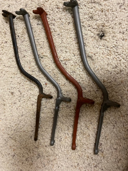

FWIW the turtle deck lid handles are pre-1917. And as Rich B pointed out, looks to have '13 windshield braces. Looking a lot to be a "Frankenstein" car. Interesting nonetheless.

What about that rear crossmember?

The firewall appears to be decayed plywood. Was plywood used in the early bodies? I thought plywood came into use in the 1930s/WWII era.

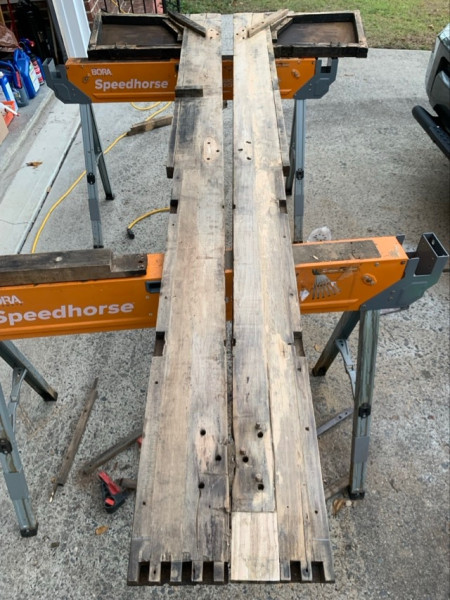

I stopped and got some more photos. I couldn't find a number under the seat or door, I had a limited amount of time and no sandpaper. The tag with a name was to the left of the steering column. It appeared to be at least dealer installed. look at the fasteners. there was also a" Torpedoish" tank on the shelf, DB front axle.

Thanks for the additional pix Don ! It's a treat to see this critter ! Interesting how they coped the later turtle deck to that body.

The frame rear crossmember is correct according to Bruce, this is a June build and that crossmember started in May.
quote " Longer rear cross-member, beginning about 271,425 (May 1913), eliminating the forged body brackets." This body number starts with 289

I see a Clam shell rear end. Those rear ends were not used in 13.

Don, the number you are referencing as a body number "289xxx" is that an engine number or some other plate or tag on the body? Sorry for all of our questions but I think we are all kind of excited about your find and want to help.

It is the serial number on the fire wall

from what I can tell this is a Ford body. everything matches up to the frame and has not been altered. The one detail I have not matched to a torpedo is the shape of the rolled bead at the bottom of the door. It seems the others are square in the photos and this one is curved. I also have a gas tank on the shelf that seems to resemble a torpedo tank. I can't wait to get it o the house to figure it out.

Yes - that's a Torpedo tank ! Nice score !!!

I'd want to check the area very carefully for any and all stray parts for that vehicle.

- Posts: 1708
- First Name: Herb
- Last Name: Iffrig
- Location: St. Peters, MO
This one is on the HCCA site classified for sale section.
Here’s another torpedo for sale with Long Beach history.
https://www.ebay.com/itm/224963559225?h ... Sw3X1iaAMS

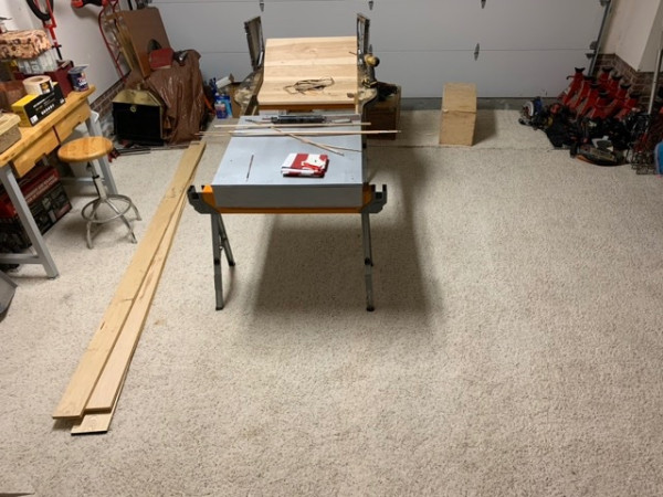

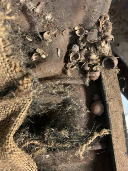

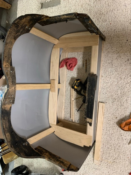

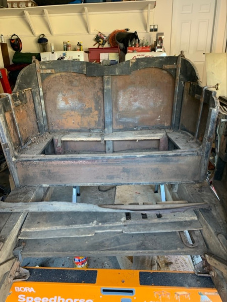

I purchases this from Don probably around Nov. 2022.
I tore it down to almost bare wood. Told the furry varmint to scat Then tried to tackle the rot. Lots of rot! I would advise
Not to power wash old wood…
it will remove the wood
Very quickly!
The bottom 2”’s of the seat sheet metal needed replaced and the wood frame was in very bad shape!
It’s taken me 3 years to get everything i need for this vehicle and i’m still lacking one front fender iron for it. And, people have been very generous with helping me get it all together.
Progress isnt instantaneous even if you throw money at it!
I’ve searched for parts in country and out of country to get to this point.

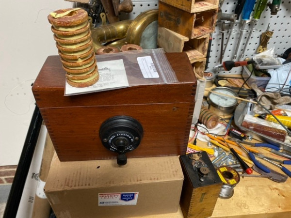

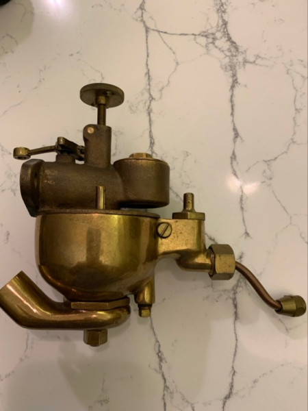

I’ve restored the coil box and coils.
A box for the future. I bought 8 side step irons just to get 4 good ones…
And, no those arent the four good ones. I’ve soldered , welded, primed just about everything. And even purchased some rare items for it.
I’ve polished brass and sat on the shelf or in

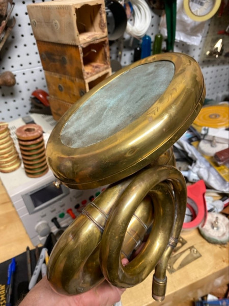

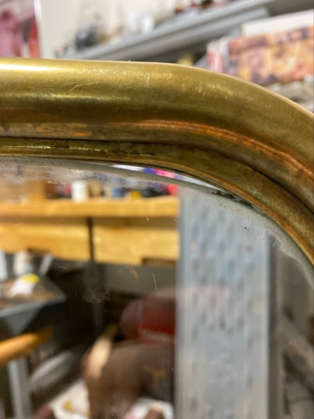

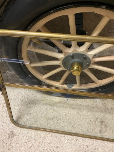

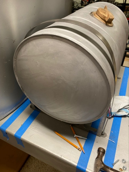

There is still much more to do!
I’ve gotten worthless parts, good parts, great parts,
And a whole lot more…
But one thing that is consistent is all the people who have tried to help me get to this point!
I took that back to the glass shop and said NOPE! They
Did fix it!
All Vendors have been extremely helpful.
Did fix it!

And, so im getting very close… but still lots more to do!

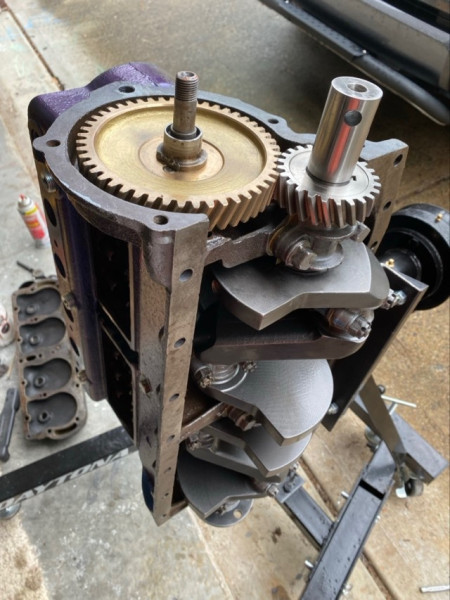

I originally thought this was a typical 1912 until i put the
Firewall on. I found out quickly that this wasnt a later
1912 but rather a late 1911. So, i purchased a Dec 1911 motor for it. Bought a scat crank and am in the process of rebuilding it. A good man from Colorado repoured the mains and the rods and now it’s just a matter of time! Speaking of which, Time-Saver????? Nope. Hours and hours of take it apart, clean, add oil time-saver, tighten back up then redo over and over…. Not saving much time…

Good grief !! You’ve done a lot in only 3 years. I must’ve missed this string of 3 years ago and just spent a half hour of reading it and having fun with all the opinions. What windshield style will you incorporate and will you continue with those rear fenders ? You’re definitely a multi capable restorer Michael. Thanks for continuing the story.
- Posts: 7775
The item pictured in big2bird's Aug. 10th post, titled "Coupe Gizmo?", looks a lot like the metal items on the upper outer corners of the wood dash.
- Posts: 227
- Joined: Tue Sep 13, 2022 4:01 pm
- First Name: Michael
- Last Name: Bunner
- * REQUIRED* Type and Year of Model Ts owned: 1912 Torpedo Roadster 1917 Smith Form-a-Truck
- Location: Cary, NC
Absolutely George! I will continue with those fenders which were available in 1912. And as a man in SC said he likes the round ones for his commercial roadster, i like these for my Torpedo!
Pat, The gizmo’s in Dons’ earlier post were windshield adjusters, if that is what you are referring to? I had them powder coated just in case i drive it and find it too hot on a sunny day without some air movement. I havent installed them yet. If you’re referring to the brass sidelamp brackets, well i had 3 types to choose from and liked them the most! The more brass the merrier!

Here are two fully restored Model T's available for the price shown in the picture. Both are award winners. Budget your find to bring its restoration in par with these. The subtract from the ones for sale to determine what the find is worth.
Headlights $2,000 ?
Sidelights $ ?
Radiator $1,800
Tires $2,000 - $4,500
Fenders $1.700
Carbide Generator & parts $2,000
Paint per gallon $
Wood Spoke wheels & Rims $
Brass Windshield/parts $1,000
Top Bows & Material $
Engine Rebuild $
Seat Restoration $
etc
Headlights $2,000 ?
Sidelights $ ?
Radiator $1,800
Fenders $1.700
Paint per gallon $
Engine Rebuild $
Seat Restoration $
etc
Finishing up the “timesaver”engine build…. Everything is GREAT until you torque it all down!
