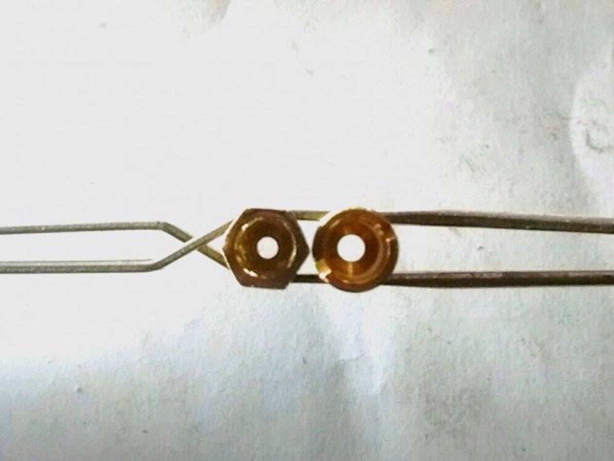

I don't remember if this comparison came from Scott, but it shows the ineffective .100" float valve opening that causes fuel starvation, beside the proper .125" opening that doesn't.
