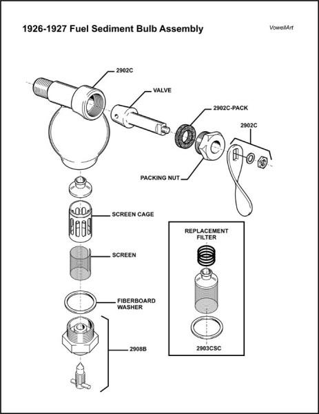

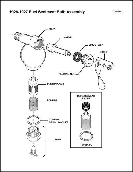

Post by perry kete » Sun Aug 17, 2025 7:02 pm
Here is a breakdown of the sediment bowl. It has very fine screens in it that can get blocked up and it will need to be taken apart and cleaned.

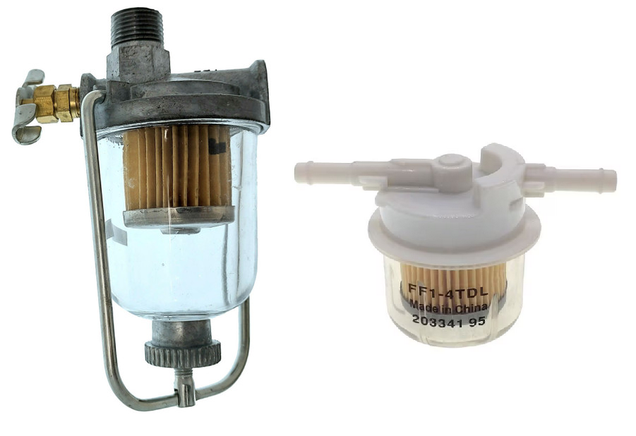

Re: I know that I am a pain but need some help - Sediment bowl
Post by DHort » Sun Aug 17, 2025 7:08 pm
gas filter1.jpg (3.75 KiB) Viewed 4604 times
I would consider using one of these. $7.50 at Langs.
Item #2903CSC
