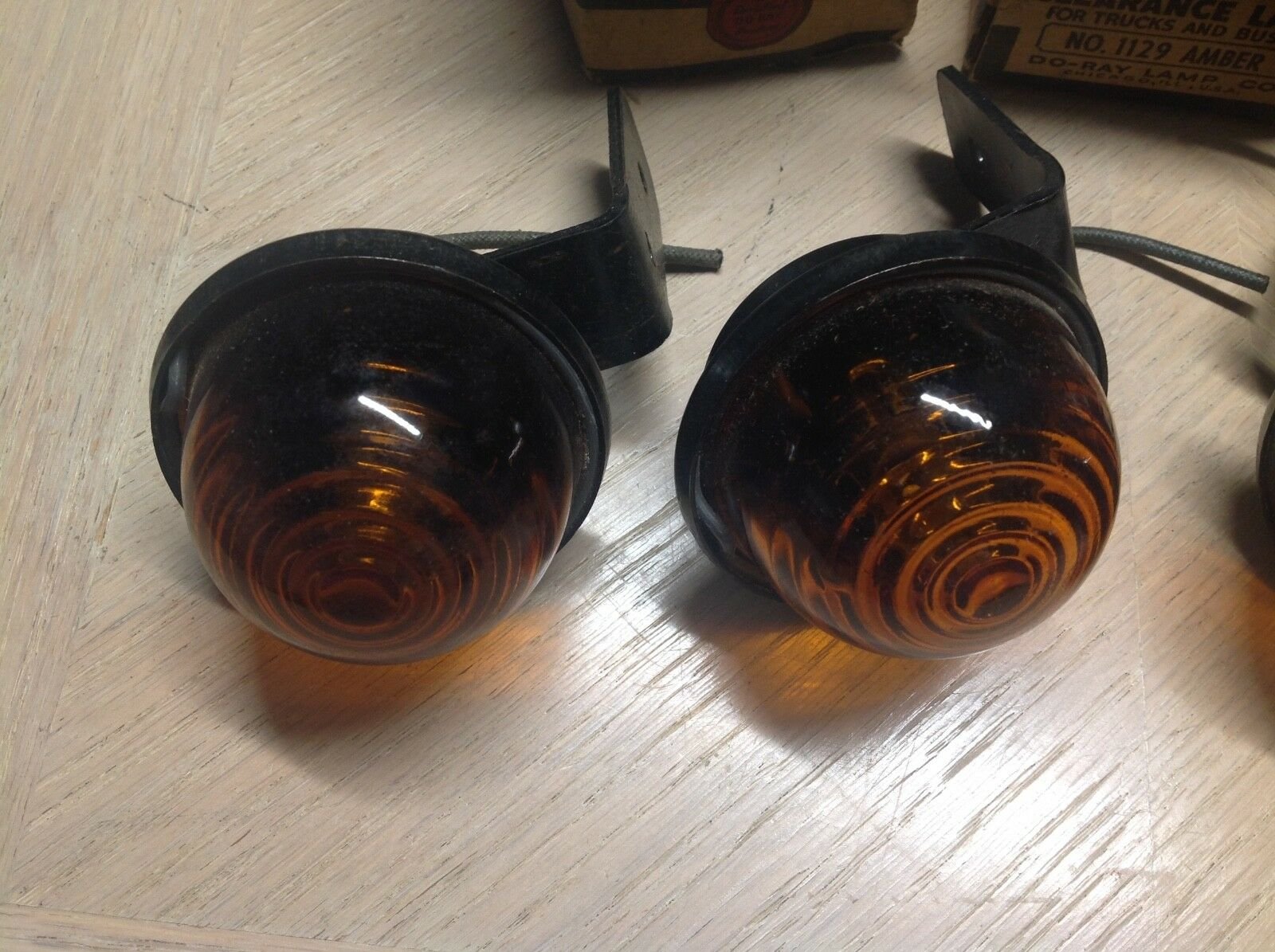

Does anybody know what 6v bulb the old Do-Ray clearance lights used? These are sort of a beehive style light. Also what would be a 12v with the same base?

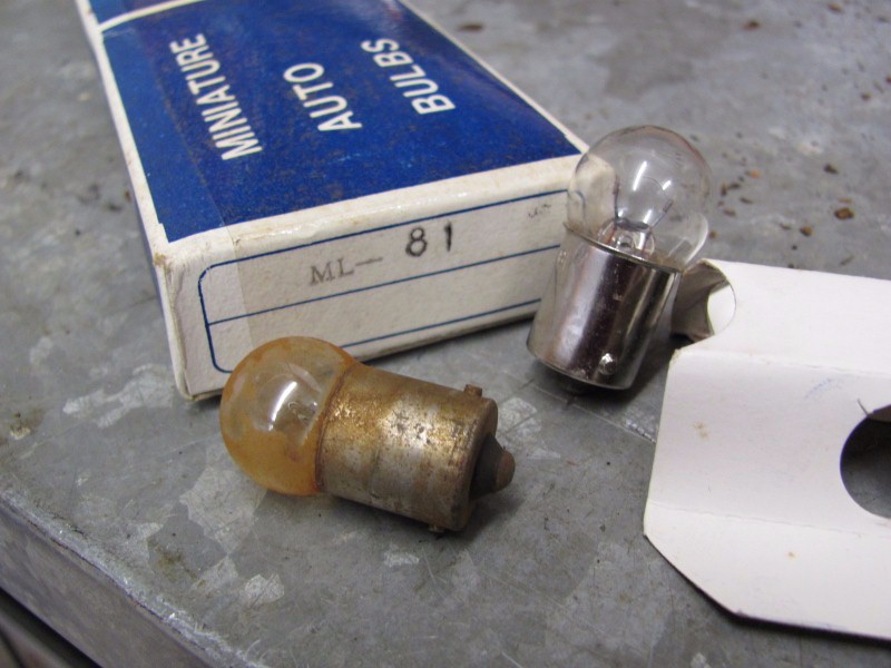

For 6v. use the std. #63 bulb, 3 c.p., 0.6 amps. found in most auto stores. A bit brighter, with same bulb globe size is a 6v. #81, 6 c.p., 1.05 amps., but harder to find.
These #63, #81 and #87 now are also known with the newer description 'BA15s' lamps, meaning bayonet base, single contact, std pins. (not offset pins)
As for 12v, don't know that number, but a counter parts guy will find you a match BA15s.
I bought a supply of the old time brighter 6v. #81 from the buggy shop, Witmer Coach, New Holland PA. Fun catalog of horse buggy parts, but carries hardware stuff and at least a few years ago full selection of old time automotive bulbs. Also have gotten from them 6v. #87, 15 c.p., 1.91 amps.good for spot or ditch lamps mounted on your windshield post.

Thank you Dan! That's exactly what I was looking for!
I plan on using these for turn signals and prefer to stay 6v. I would consider LED replacement bulbs but have heard finding 6v LEDs can be a problem, and that you need to use a solid state flasher and that too can be a problem.
I am using this on an early car that runs on magneto, no generator. I do have a starter in the car with a 6v battery. I know I can use resistors with the LED bulbs but I am not sure if there is any reduction in power use if I use resistors. If I stay with conventional bulbs what candle power do you recommend? Any recommendations on flashers? If I go 12v LEDs I will use a small sealed battery. My only reason for considering 12v LEDs is I am concerned with battery life; do you know if that is a real concern? I have a full size 6v Optima battery.
I had a catalog for Witmer's at one time but haven't been able to find it. So you have their contact information?
Any input and ideas for installing flashers is greatly appreciated! I've avoided this modification for years but have finally given in due to safety reasons.
I have found a Yankee 960 flasher switch from the 40's.... it will still look like a modern addition, but I think the old switch and the glass beehive style lamps will at least look like something added many years ago.

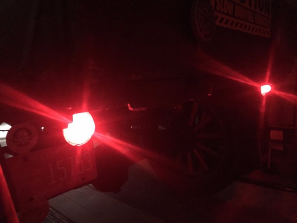

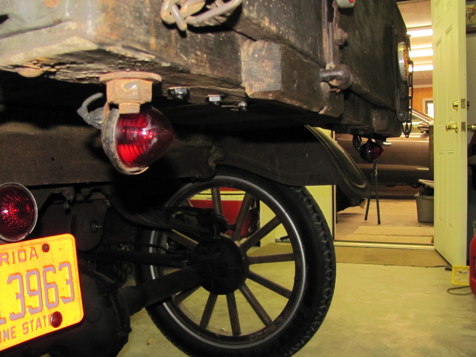

For the small globe bulb, the 6v. #87 is what I use for stop lamps at the underside of the wood bed on the '23 cutdown. Use similar housing with red glass lens as those Do-Ray. Pretty bright 12watt, 15 c.p.
As most flashers use the brake lights, the #87 should be ok.
Twin brake lamps using Do-Ray style old metal clearance lamp housings, with red glass lens. The small #87 fit good, the globe size didn't hit the inside of the cone lens.
Fairly bright for 6v 15cp.
