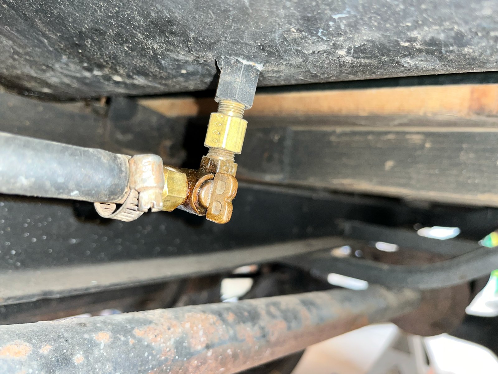

Here is my current tank connection:

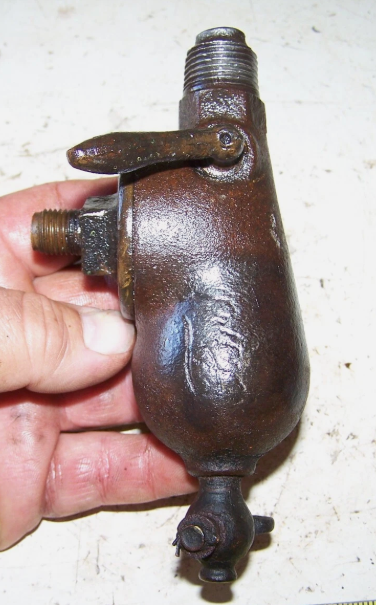

This is a sediment bowl/bulb I have seen on eBay or parts dealers -- the input threads look to be 1/2 NPT|Straight

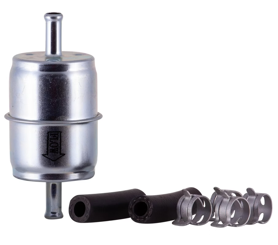

And this is the Napa 3032 inline filter

Modern inline filters usually mean trouble in the Model T gravity-feed system. I fought trashy fuel for a long time until a loose baffle flopping around inside caused me to buy a new tank. The old tank took the trash with it and I never had the problem of trashy gas again because I was very careful to avoid contamination when refilling.

Looking at the photo that you posted of your gas tank connection, it raises a few questions. It appears that the tank outlet is too small for the stock sediment bowl. It also appears that the tank outlet is almost directly above the exhaust pipe. I would not expect to find either if it was a stock Ford gas tank. If these things are true, and your vehicle has an aftermarket/re-purposed/non-stock gas tank, then your options point towards a one-off solution. A separate glass bowl sediment filter (without the internal pleated filter element) can replicate what the Ford "potato" does. You would need to source one, I would look towards vintage tractor parts suppliers. Once found, you would then need to figure out a good place to mount it. Since this would be a completely custom installation, the advice here will probably be limited to general considerations.
Some folks run electric fuel pumps if their fuel tank is located somewhere that a gravity feed is less effective. With a fuel pump, a modern fuel filter cartridge becomes more viable. Typically, adding a pressure regulator is a good idea with a fuel pump, to get the fuel pressure down to the <2 psi that the stock Ford carburetors are comfortable with.
Alternatively, installing a reproduction Ford gas tank would mean that you could use more stock parts and get more specific advice on getting things back to "spec".

That looks like a natural gas/manufactured gas pilot light valve.
The 1953 Rheem furnace that was original to my house had a "B" handle valve for the pilot light, but the inlet and outlet were in straight line, not 90 degrees like yours. It was a tapered valve, not a ball valve, with a tension spring and screw on the opposite side from the B handle.

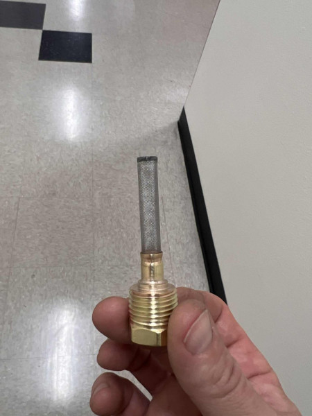

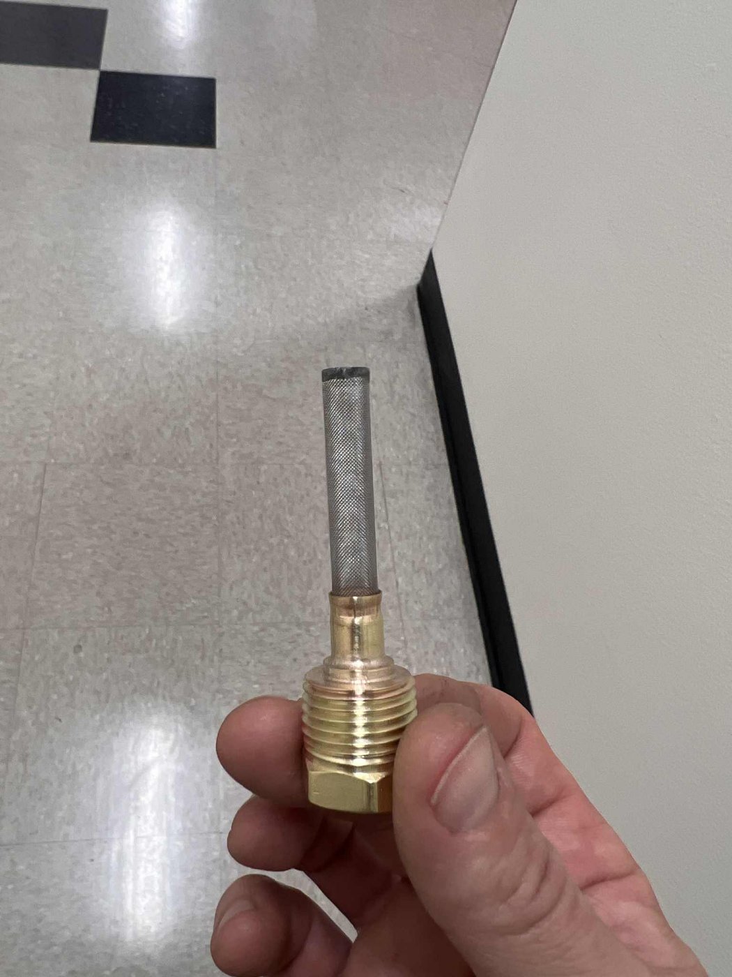

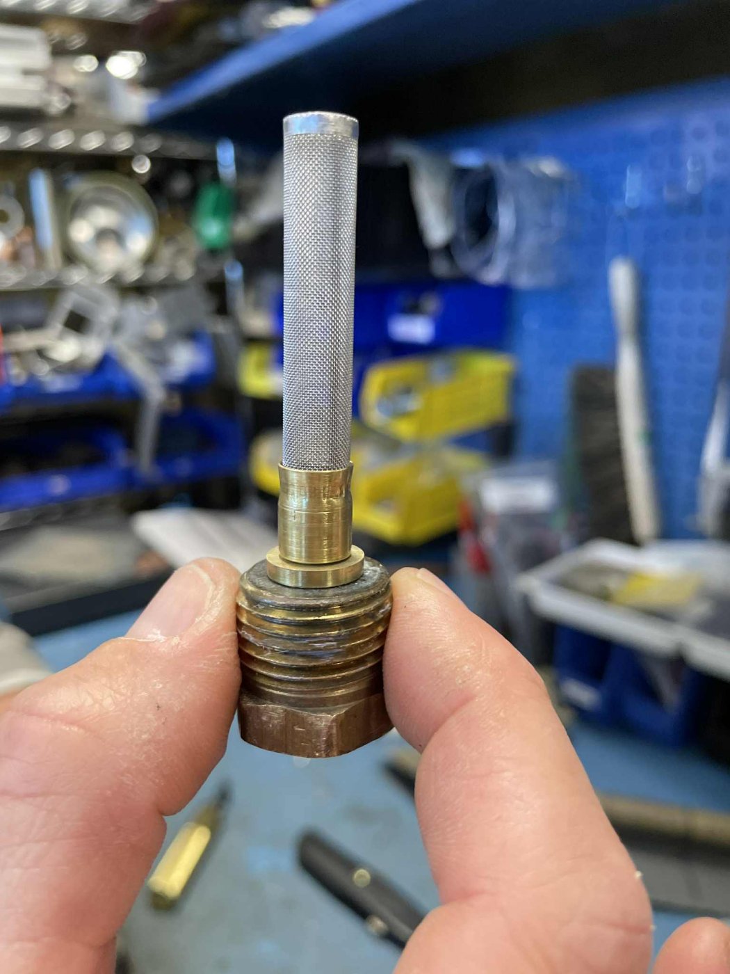

The new repro bulbs seem to work fine. If thread size is an issue, you can use a pipe thread reducer. I went to a tractor sediment bowl with a fine mesh screen. No filter element. Some of these tractor bowls have a built in fuel shut off. Similar to

Don’t use an automotive type in line filter. What I’ve always used on my T’s is a lawnmower in line filter. Most of them are gravity feed like the T. It’s not the same as a pump type auto fuel system. Never had a problem using them.

It depends how authentic you want to be. I appears the flange for the gas tank has been removed. Maybe you should find a good used gas tank, or buy a new one. Don't assume a used sediment bulb will be useable right off either. Most of them have a hole punched through the screen. When I did my '25 It took 5 sediment bulbs before I found a good one. and lots of cleaning with carburetor cleaner, scratch awls and lot's of blowing backward to get all the junk from within.

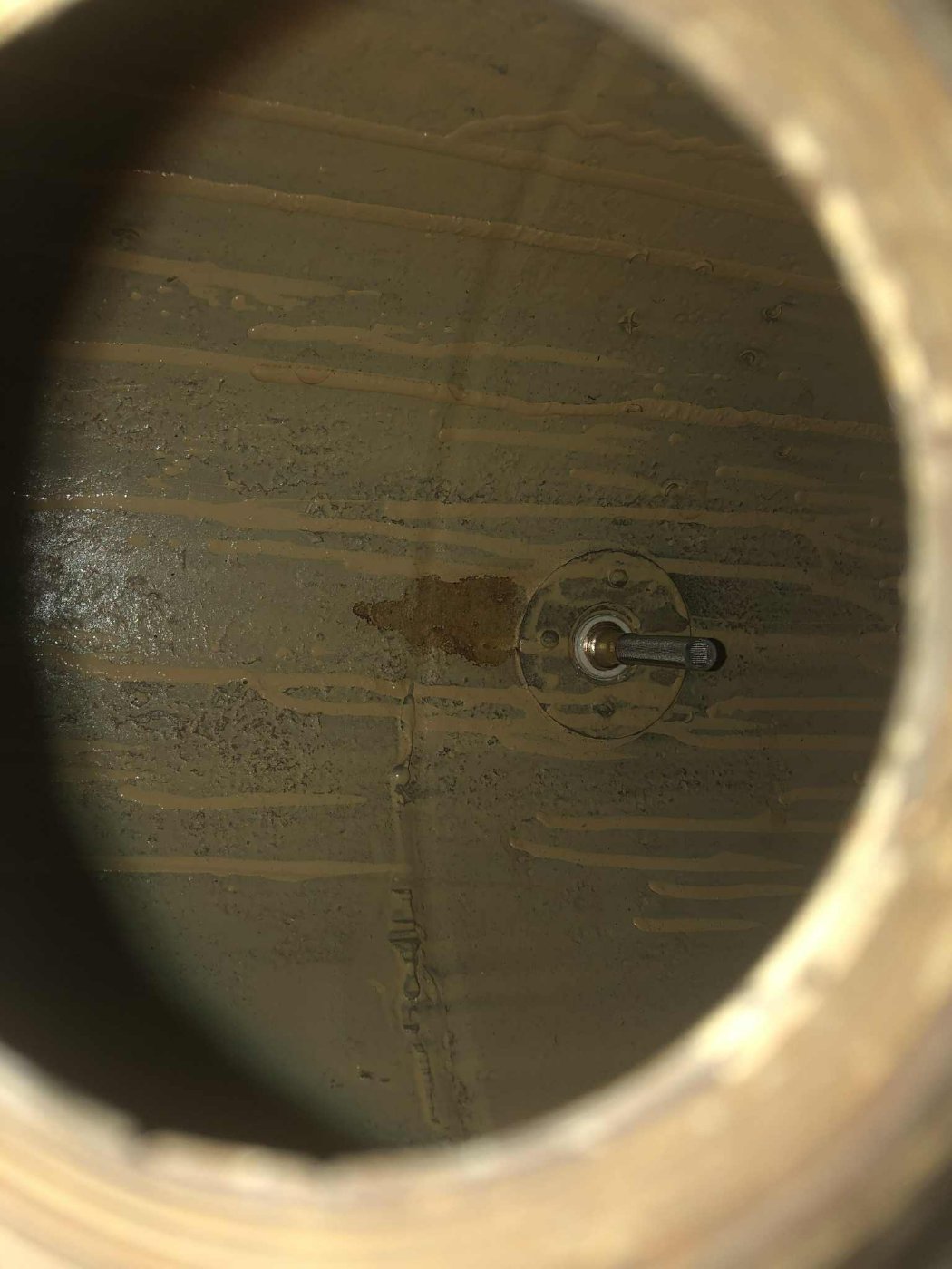

was up til 2:30a (from last night) installing the new wiring harnesses and undoing my grandfathers hot-wiring job.... what a mess that was!
while I was underneath the "T" I got a couple drops of fuel on my forehead, so started inspecting the tank.
...Looks like he also tinkered with that too. It definitely needs to be replaced. There was a plate welded the bottom, which is why it looks so different. Some of those welds are corroding and starting to leak fuel.
I'll look out for an oval tank, then I should be back on track for that part of the vehicle.
Its amazing for the amount of tweaks done that were done to it back in the day to keep it on the road. Lots of ingenuity going on for sure! I plan on updating things like this as I find them.

It’s tough to beat the design of the Ford sediment bowl. It gives you the ability to shut the fuel off, filter out dirt, drain any water or sediment, and drain the tank all in one.

Presuming you’re referring to the original Ford sediment bulb ? Mine does not.
Requisite is a sediment bulb in good enough condition that the valve can be “lapped” to a proper fit. Assemble the parts with an application of that heavy, pasty fuel valve lubricant, which will also keep the valve cone from sticking in the body. In my experience there’s no substitute for the original lead washer to seal the fuel line outlet in the “spud”. Treat the drain petcock the same way, of course.

I also would not use the in-line modern car fuel filters. They are designed for a pressurized fuel system. I'm not saying that it will not work, but it will have greater restriction then the sediment bowl.

It USUALLY DOESN’T work… You initially run out of gas with right around 3-5 gallons remaining. And it gradually gets worse.

The only external in line fuel filter I have had excellent luck with is the Mr. Gasket Clearview filter. It is not a paper filter so no or very little restriction. They are available for 1/4, 5/16, and 3/8 fuel line. It is a clear glass filter so you can see if there is crud in the filter. You can also take it apart to clean it or replace the filter element. I believe there are now knock offs of this filter as well. Link to show you the basic filter:
https://www.google.com/search?client=fi ... uel+filter
I also use VW fuel filter screens inside the tank. If interested in how I do it leave a comment and I can post explanation as well as photos.
Terry

fireheadman wrote:
Sun Aug 24, 2025 11:03 am
I've come across a filter that looks like what you posted... it would work, but if you ended up with some trash/sediment in the tank there would be no way to drain it out easily right?... at least not something as easy as turning a petcock valve or removing a bowl.
True, it’s a little more effort. Sediment would collect around the neck of the filter screen and just sit at the bottom of the tank. Cleaning it out means draining the tank and removing the fitting. The loctite sealant isn’t permanent so that’s not a huge issue. Fortunately the gas here seems pretty clean and I’ve seen very little for the past two years since the screen has been installed.
