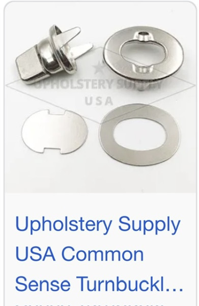

It is for a 1916 Touring, here's my confusion. It is fitting to the sides of the Top Boot so it is mounting directly to fabric. All the fasteners I see have two screw holes on the base and those attach to wood. Which ones work with two pieces of fabric only?

This kind, male twist sandwich between fabric and it’s backing plate, compress the lugs to lock
Open portion to other fabric, with its backing plate.
Comes in government black or nickel or brass.
