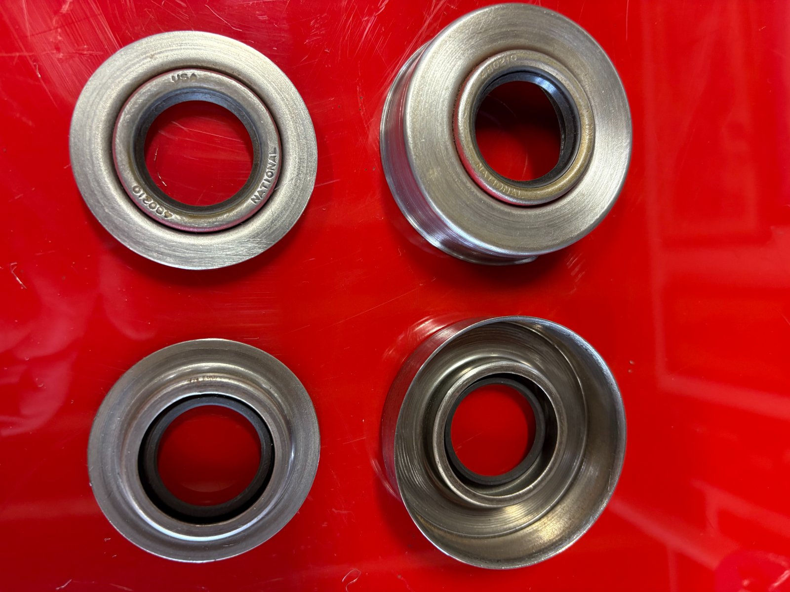

I am not rebuilding my rear axle just yet, but I'm doing my springs, but I figured I'd look at the mess behind the wheels while there off and I found various felts and washers and it looks like there not correct. Both pictures are left to right in order left being closest to the bearing and right being the outer most, I thought it was just supposed to be felt then cup but I got felt washer felt cup and one had one felt outside one had both inside.
Edit: I noticed just now that my images are for whatever reason mirrored so it's right to left.

Correct order is: 1 steel washer, 1 felt (sometimes too thick), then cup.

Of its only one felt on the inside which is? The one with the bigger or smaller inner diameter?
- Posts: 5579
Re: Rear wheel seal mystery
Smaller - it fits tight over the axle. Ford did supply a felt seal for inside of the housings - most of us use the modern neoprene seals inboard of the sleeve.

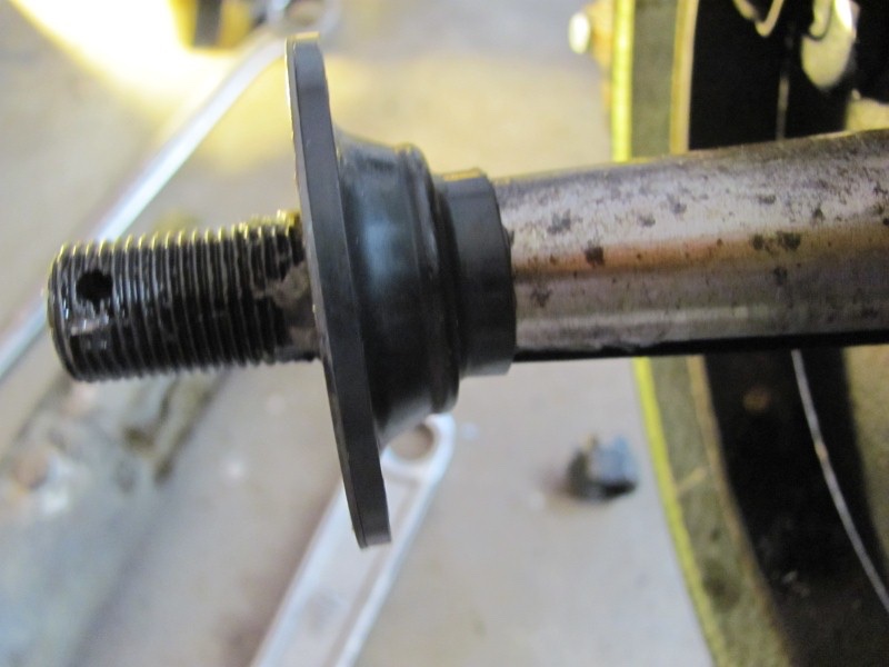

The seals have been "modified" with a reduced face area for the sleeve clearance - not shown on the seal Dan was using !

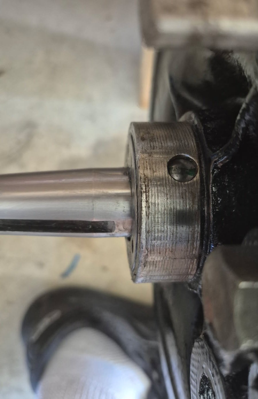

I just rebuilt my '14 axle, and ran into that reality...KWTownsend wrote: ↑Wed Aug 27, 2025 6:11 pmIIRC, installation of the inner neoprene seal requires shortening the inside end of the axle sleeve by the thickness of the seal (?)
Between the early axle, and the neoprene seals, I had to shave a good 3/16th off the outer sleeves to flush everything up...

Removing something from the inner end of the sleeve is standard practise when fitting those inner seals. You need to take off the same amount as the thickness of the oil seal backing.

Can't recall whose inner seals I recently ordered from, but they have a relief in the edge for the sleeve to set in - no cutting required !
Snyder's current seals show the relief ! If I remember correctly, Chaffin's began modifying those seals years ago.

Steve, yes, the ones from Lang's have the relief as well.
Right/wrong/indifferent, I did dress up the outer relief (inner facing) edge with a thin layer of RTV to help seal the outer edge against the tube/face. But, thin/skim, certainly nothing that could have caused that much clearance issue.

Steve, The seals I used from Snyders was the same as you have pictured. I did not have to trim the bearing sleeve at all, it fit good.
