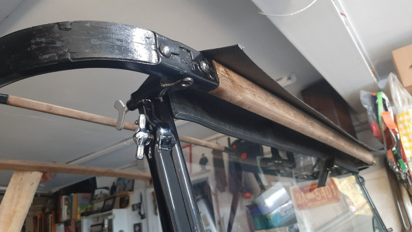

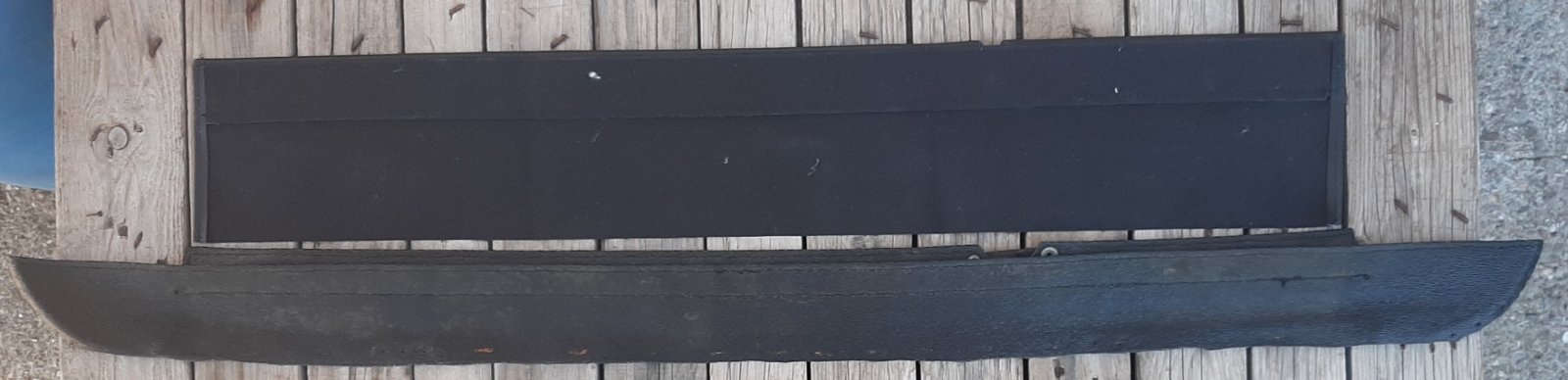

I have read a lot of posts about top installations, but I am unclear on these points which are appearing as I start the installation of my Classtique top. I purchased this kit 10 years ago and did not unpack it for a couple of years. I have been advised that it will have creases in it for life, but that is a chance I will take.
WIND-BREAKER
My old top had a wind-breaker that spanned completely across the front bow.

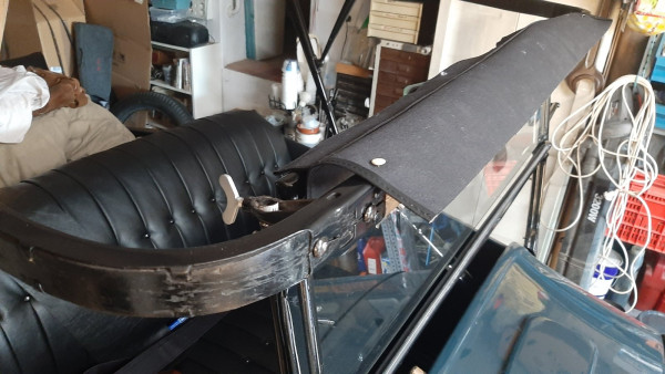

The new wind-breaker does not span across the front bow.
Old and new wind-breakers together:
Asking for experience here: Is the shorter style wind-breaker enough, or do I need to have sections sewn on to span across the bow to prevent air coming over the side curtains when they are installed?

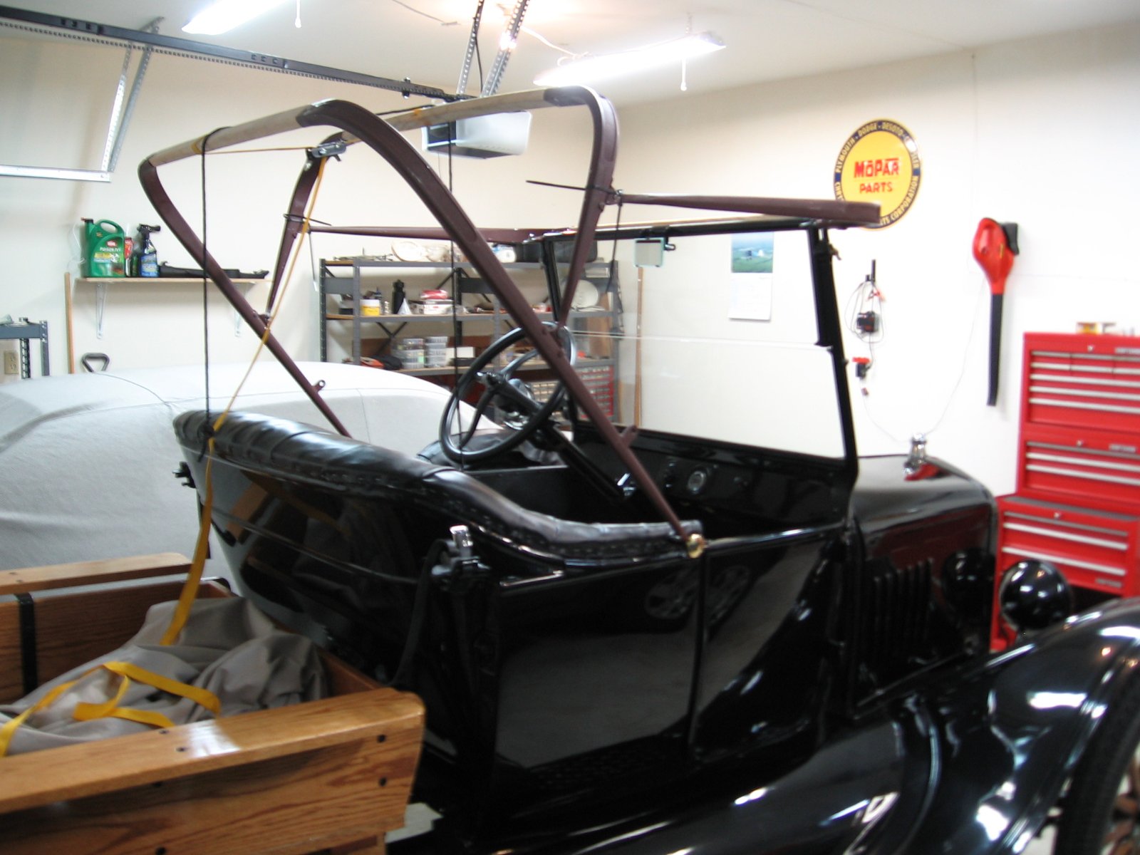

REAR BOW ANGLE/HEIGHT
I have read that the rear bow should be plumbed even with the tack rail on the body, making the rear curtain perfectly vertical.
I have also read where the rear bow should be angled further back, which would make the rear curtain lean slightly rearward.
I welcome comments from those with experience in this area.

You have the windbreaker on wrong. It should be on the bottom side of the front bow and wrap around the front and back of the bow. The flap with the snaps should hang down in front of the windshield to block the wind between the windshield and top. Snaps are for the side curtains to fasten to.
The rear bow should not be plumb with the body.

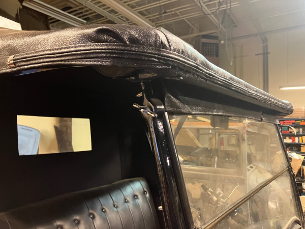

The windbreaker on my 1924 top is like the shorter one that you have in your "new" kit. It has a snap on each end that the side curtain snaps onto to help seal that corner.
I chose to angle my rear bow such that a plumb bob hung from the rear bow fell one inch behind the body sill. I'm happy with it, but two inches might have been even better, IMO. :)

I recently installed a top on my ‘26 Runabout. I started with Cartouche and finished with Classtique.
The windbreak you show straddles the top of the windshield frame and the Vee is supposed to line up with the windshield wiper hole in the metal frame. There is no snap on the outside corners; your side curtains install on the back side of the stanchions and never touch the windbreak as they did in 1925 and earlier.

As for the angle of the back bow, I also used a plumb line. Then I adjusted the angle slightly so the edges of the triangular side panels were parallel with the rear bow arms. Plastic clamps came in handy here.

The rear curtain should follow the trajectory of the back of the seat back outer panel.

The backward rake of the top should match that of the rear body panel and it should be the same or very close to that of the windshield.

The long grain in the material of the "original " windbreaker you show is not original as used by Ford, so having it fitted is a later error.
The front corners are a little more difficult to make tidy. More than once I have seen the material drawn down firmly and tacked to the bow, which makes the bottom hemmed edge low. Then the top material was cut backwards for 3-4" so the bottom edge can be lifted back into line, and tacked into place. The cut and the tacks are then hidden by the binding. Tom's corner looks like the cut step has not been done, so there is a tuck to get the bottom line in place.

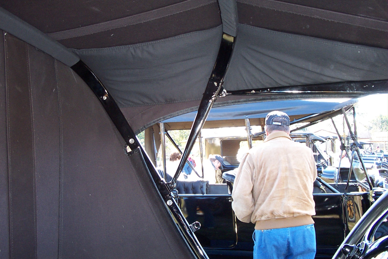

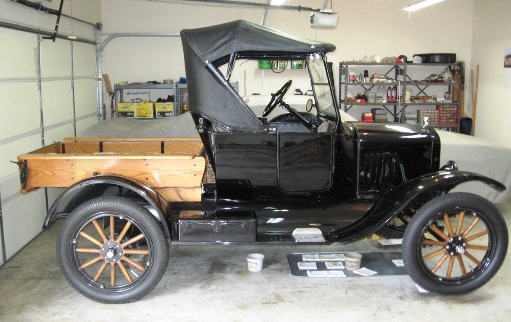

Couple of pics from an install by Eliz,when she owned Classtique.
Wrap the front bow with vinyl first, the other bows get wrapped with cotton bow drill.
Then fit the windbreak to the front bow, note the slot for the wiper arm.
The place top cover over the top pads after the rear curtain and gypsy are fastened to the rear bow and rear tub tack strip. The rear bow angle is usually set by the top irons when fully extended, but have a bit of overhang, for rain run off and to keep the brim of your hat from hitting the rear curtain :lol:
611017 copy.jpeg (56.14 KiB) Viewed 3944 times

Post by speedytinc » Mon Sep 01, 2025 9:17 pm
Good period picture showing the rear closely following the rear body tub angle.

I'm starting to get the gist of this.
I'm the first to admit I know little about doing tops and interiors. It's not a part of the car that I enjoy working on, but I don't have the cash to go to an upholstery shop, so this is what I will need to do to finish this car.
Many thanks guys. Dan, that last pic really shows the angle of the top :)

Thanks Ken. I see your front bow side arms look to be perfectly horizontal. When I set the side arms to horizontal, the rear bow is leaning back 1.5" past the tack rail on the body.

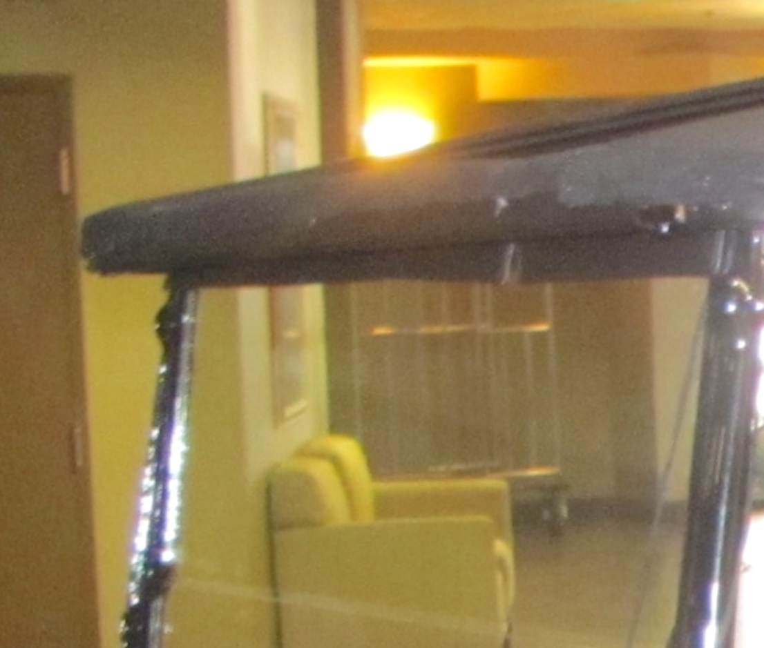

Were these squared hide-em welt caps used on the late roadsters?
They would look right in place at the front end of the welt where the top is tacked onto the body.
Move the rear bow to where you believe it should be. How far from horizontal is the front bow, once that's done? Chances are, the rear bow can move a lot with only minimal impact on the front bow angle. In the long run, a poorly placed rear bow will stick out like a sore thumb, while the angle of the front bow will be barely noticed.

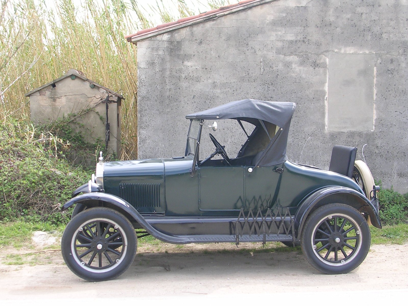

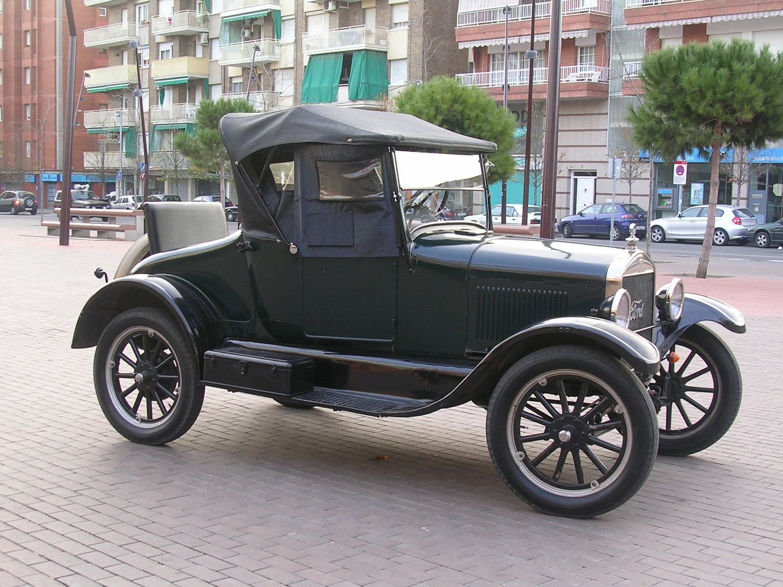

That's sound advice Jerry. It's true that the front bow side arms move very little compared to the rear bow.
I'm looking at pictures of the old top, and it does appear to almost match the windshield rake. I really hadn't ever noticed it, not until a new top had to be fitted.

The bow to the windscreen is fixed, The socket does that, in conjunction with the stand-off brackets that fix it to the windscreen stanchions. The length of the rear bow is fixed by the socket too, as is the mounting for the front two bows. There really is no room for adjustment.
The angle of the rear bow has room for adjustment.

It will be a minor adjustment, if any, but that may be all that is needed. If you can lay the back bow back a bit, it will take the mounting point for the second bow back too, and that will be impeded by the fixed front bow. All you have to make adjustments, is the flexing within the assemblies, not any new positions.

Does anybody have the square hide-em welt caps (picture appears previously on this post) on their 26-27 open car?
I have looked at dozens of pictures and cannot see this end cap. Most of the photos are not high enough resolution.

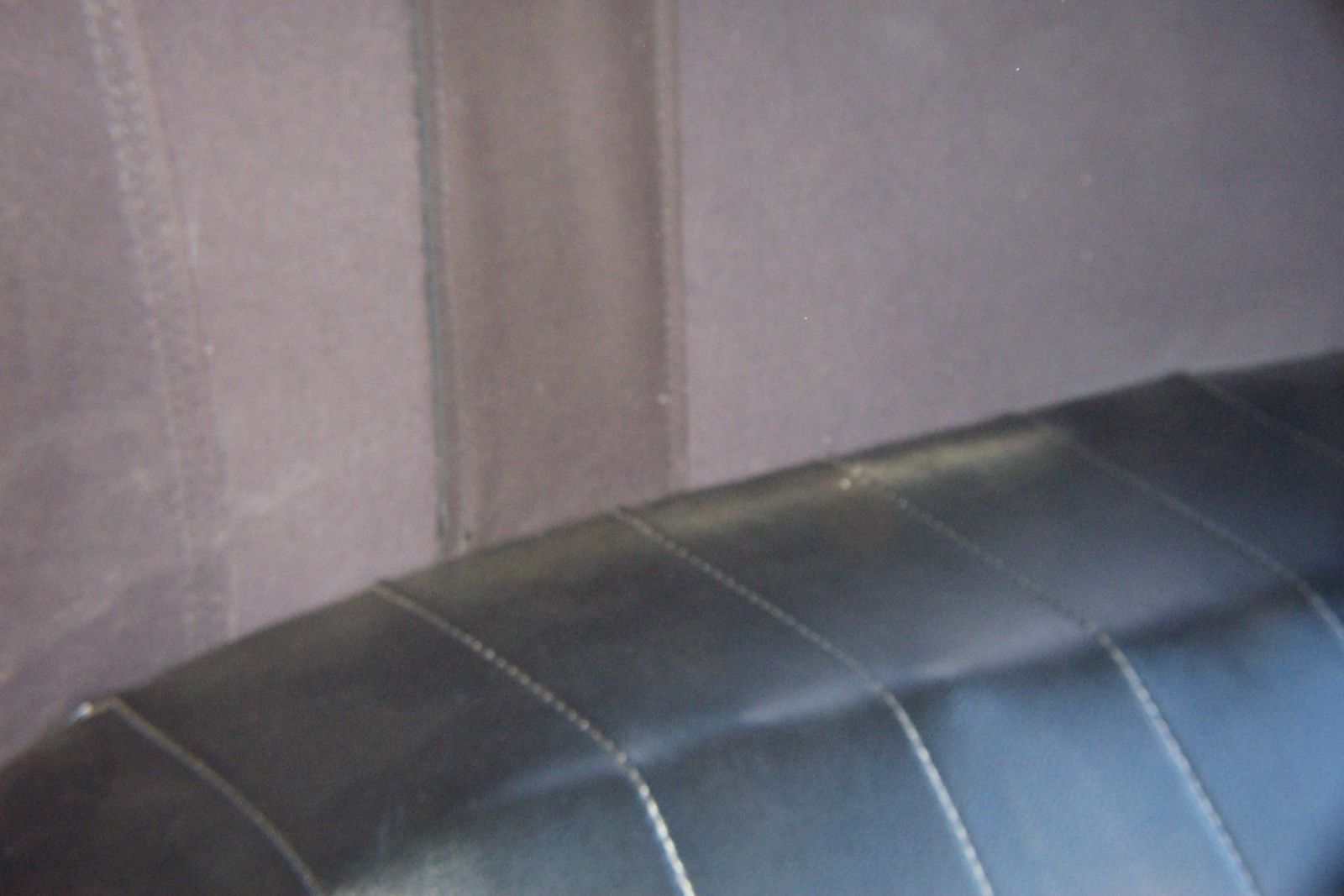

My old top, installed some 60 years ago, had 2-inch-wide black woven belting to set the distance between the bows. It appears to be cotton with a reinforced core.
My car did not have any belting from the rear bow down to the body tack strip, but I am told it should have.
The "Encyclopedia" states the following:
Just out of curiosity, does anyone have an original top to confirm the width and thickness of the factory woven belting?
Posts: 4089
Re: 27 Roadster top installation
Post by DanTreace » Fri Nov 14, 2025 3:17 pm
Eric
Those pair of rear straps from the back bow to the tub wood trim strip are wider than 2", and are made of several pieces of fabric with sewn edges. Reason is a lot of stress on those, as the top is erected, and when folded. (1926 pictured)
On my '23 cut-down pickup, worked to fabricate a used '24 top covering, and related pieces, to make a top. You can see the wide rear straps from the seat trim wood to the rear bow. Plain webbing is used for the top straps that run to the front bow. The bow pads cover the curved portion of the bows to give body to the top, and prevent the 'starved horse' look of a top that doesn't have enough support.
IMG_9297 (600x450) (600x450).jpg (138.53 KiB) Viewed 2070 times
Posts: 4089
Post by DanTreace » Fri Nov 14, 2025 3:24 pm
Pieces of used '24 top covering, the body and the rear curtain used to mount on the '23.
IMG_9295 (570x428).jpg (105.75 KiB) Viewed 2066 times
Finished top job. ;)

Dan, that's a really nifty re-use of an old top. It sure fits in with the car's patina. Nice match!

And thanks for the info on the rear vertical straps. I got the top kit with the roll-up rear curtain, so it will certainly need the additional reinforcement of the wider straps.
