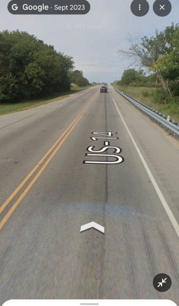

This is more or less exhactly where I was when I was hit. Note the guardrail on the right and he could only get over so far, or didn't have time to, I don't know. I was in my lane.
This was the view behind me, plenty of straight road to see me, no curves. The sun was setting but still 2 hours of good daylight left. But 'he didn't see me."

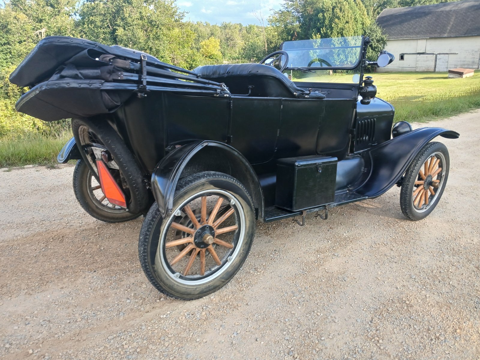

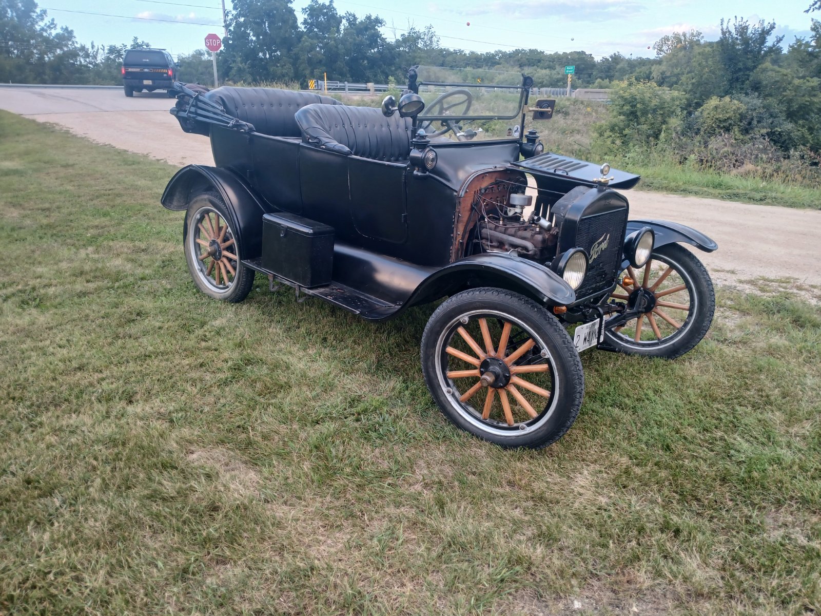

Glad you are OK, and it looks like your car can be saved. It's not uncommon for people to crash into the back of police cars that are stopped on the shoulder with all lights flashing. Many people seem to have no idea what they are doing when driving a motor vehicle, or how serious the consequences of a crash are, even in a "safe" vehicle. Holidays seem to increase the number of fools on the road.

I'm glad that you are physically OK Austin. The T looks like it will be repairable.

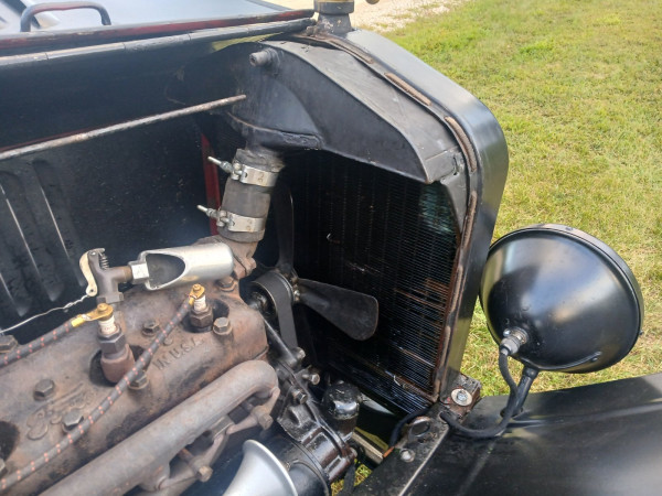

It's odd that the radiator stay rod disconnected from the radiator. I wonder if it only had a thread or two holding it. The radiator appears to be OK.

As for the car, that's another story. It doesn't look too bad first glance, but there's a good chance it may be totaled. Either way, I want to keep my T though. The insurance adjuster comes tomorrow, so that promises to be fun. We did some rough measuring on the rear axle and with the wheels as straight as possible, there is about a foot difference between hubcap to hubcap on each side. Not a good sign...
The right radius rod is pretty bent up and the wheel is warped about an inch. As for the rest of the drivetrain, I don't know. The body damage seems relatively negligible, other than the right quarter panel and fender.

I've wondered the same. I can't tell that many threads have actually been pulled out or not. Unfortunately I don't have a very recent picture of the engine bay with that rod in the picture, so there is that chance.

I use a jamb nut on that rod. That way it can't loosen up.

A foot difference between the two sides of hubcaps to hubcaps length. That is wheel base. Something is bent somewhere.
Maybe need get Bob from Bendin with Bendon to look at it??

Re the radiator to firewall stay, it should be locked at the casting on the radiator. This stops the rod '"working" under vibration while the car is in operation.Otherwise, the thread can be seriously compromised.
Hope this helps, everyone.
